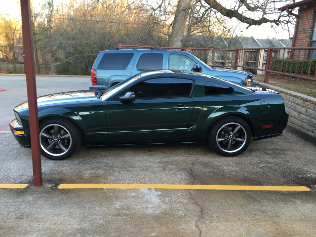

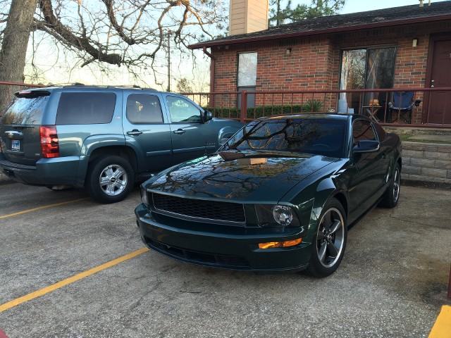

Intro: My name is Rm. That is literally what my friends and family call me, kind of unusual I know. I have wanted a v8 car since I was a kid, but the work I was doing from 16 to about 25 required me to always have a pickup. Now I finally have the luxury of driving a car. ( a big deal to this guy) So, this Bullitt was my first mustang ever and actually my first car. It was purchased December 2015.
I did a bunch of research into what platform I wanted to get. I have always liked mustangs (big sis had a v6 new edge that I would steal late at night years before I ever got my license ) and the 3v seemed like an interesting engine to me. I knew about the coyote of course, but I think the 3v is perfectly adequate for me. Plus, this body style is cool. When I came across this Bullitt, I totally fell for it. The price was extremely good even though it needed some work.
Being that I drove a pickup for nearly a decade, I was just happy to finally have a vehicle that could get out of its own way when you stepped on it. I remember feeling how effortless these cars pull to 120mph vs what a pickup feels like.

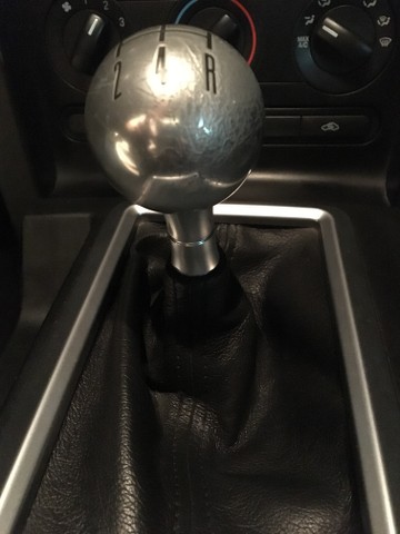

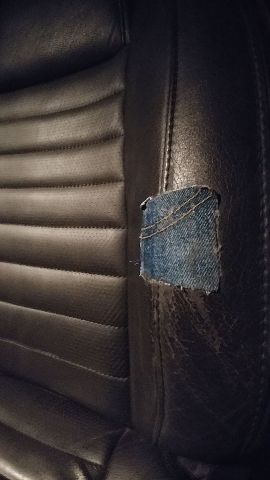

Check out the shift knob and steering wheel. Previous owner had some pimp rings to cause this damage.

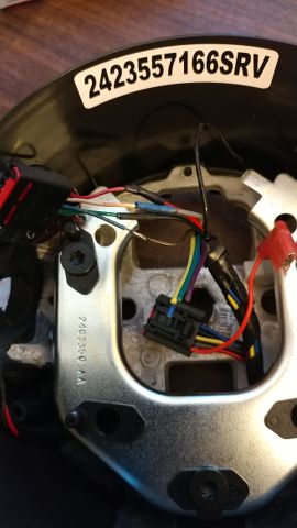

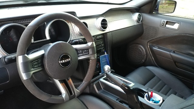

And *(I can start a sentience with and, if I want to)here is the new GT500 steering wheel I wired up. The cruise works great as well. I have to say this has been one of my favorite modifications. The quality of the newer GT500 wheel is leaps better than the original, You really feel special when you wrap you hands around it.

I think it matches the Bullitt interior very well.

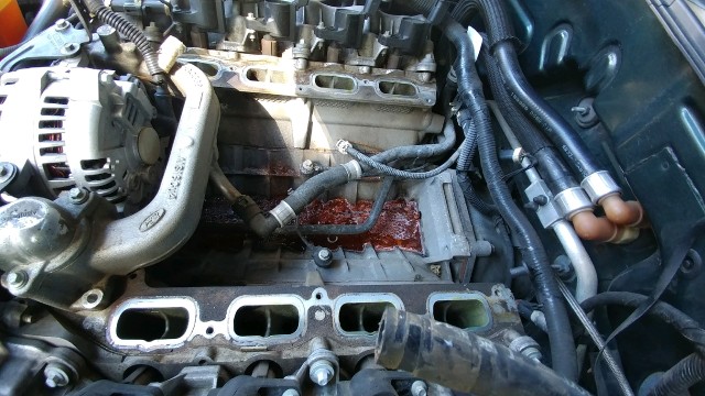

Lets see, at some point I finally decided to fix a coolant leak under the intake. I let that go way too long. Check out the dessicated coolant sludge! Fixing this toot two tries. The first was with the OEM orings as shown. That did not work. I ended up cutting about 6'' of the metal hose and running a rubber hose with clamps instead.

It has been holding fast ever since. Before that, I had a weird cold starting issue that I thought was related to the tune. But upon checking the plugs I found the problem. Original plugs!!! Jezus, that is some serious plug gap.

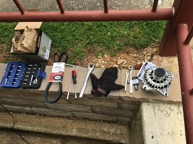

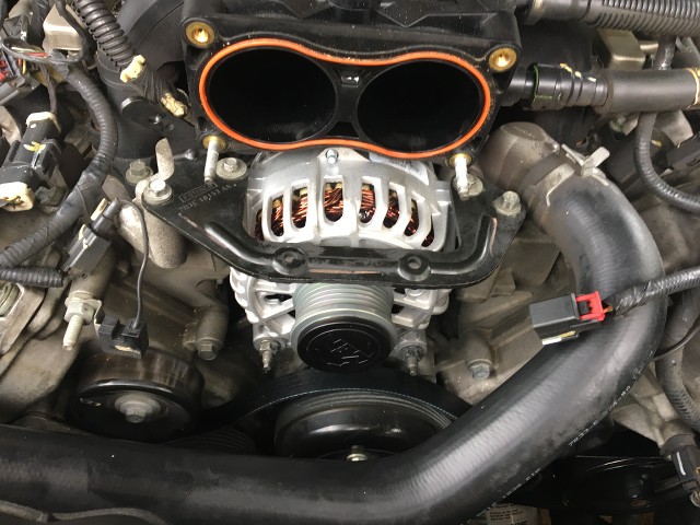

Replacing the original plugs was no big deal. Thanks to the new design they all came out smooth and easy. But before all that, my alternator self destructed. I think that was my first little wrenching project on this car.

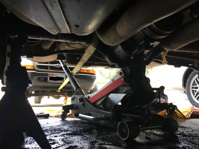

Somewhere in all that I decided to upgrade my upper diff bushing because of a great deal on this forum. Removing the old one was a major pain in my ass. See all that rubber "dust"? I was covered in that crap for hours. I ended up getting a wire brush on a drill and sanding the inside of it out. Totally worth it.

That new bushing really improved the feel and stability of the rear end, downside is it noticeably increased the NVH. The rear end on these cars are noisy.
