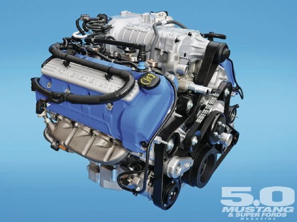

The '13-14 GT500's Trinity engine has a displacement of 5.8L.
I think he means a big bore 5.4 comes out to roughly 5.8L.
OP, if you're going to stop at 326ci, the Brenspeed stroker shortblock can bolt up to the stock heads/intake/headers. Just need different motor mounts.
