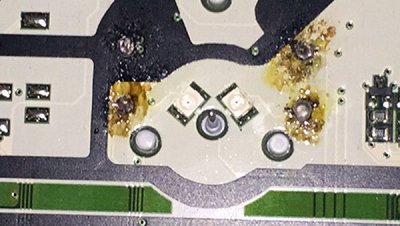

My tachometer malfunctioned about a year ago.
I researched the issue and it appears to be a failure of the stepper motor so I bought some stepper motors on eBay.
Well today I finally got around to fixing it.
Here's my amateurish soldering job. It took me a while to get that stepper motor out.
On close inspection, my soldering job did not look promising, however, when I fired up the car it worked !!
Some of the needles were a little off but I just adjusted them as needed.
Well, I'm quite happy with the results !!

I paid a guy on ebay $60 to do my stepper motors over the winter.
I decided I'd rather do that than go in there trying to do it myself and screw something up.
I decided to give it a shot.
Worst case, I'd have to buy a used cluster gauge :insane:
