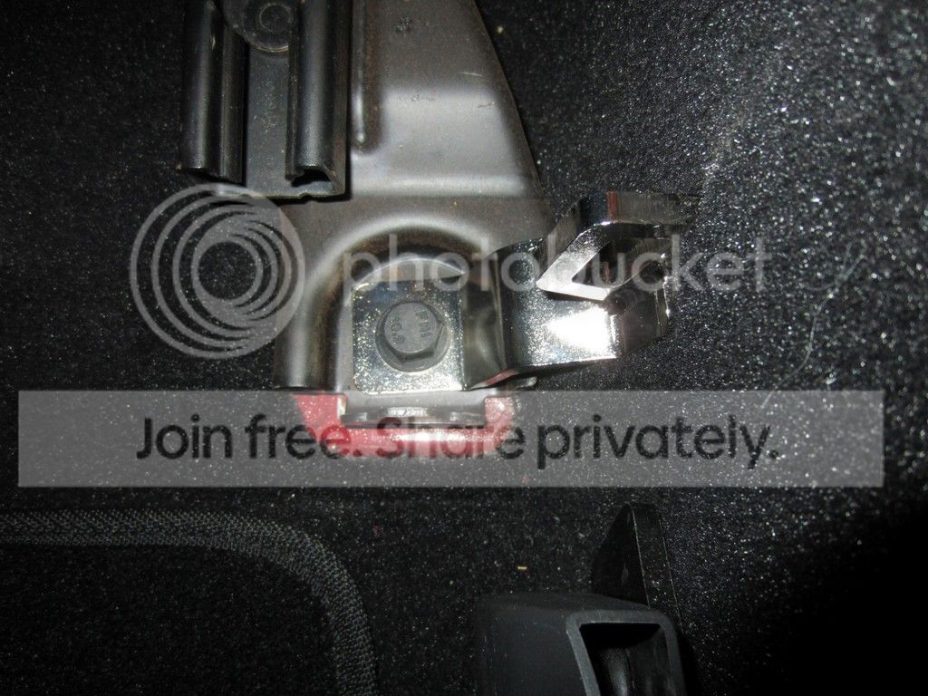

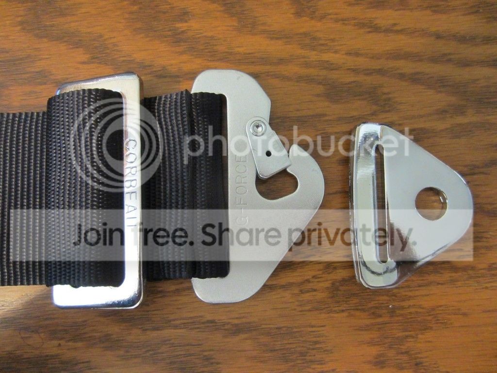

For the lap belt there is an alternative to the seat belt locations. I used these clips from Cool Tech and snap hooks from G-Force. Makes the lap belt easily removable.

Sweet! I had trouble finding the snap hooks but had found the cooltech brackets. I was searching for full harnesses rather than just the actual snap hooks.
