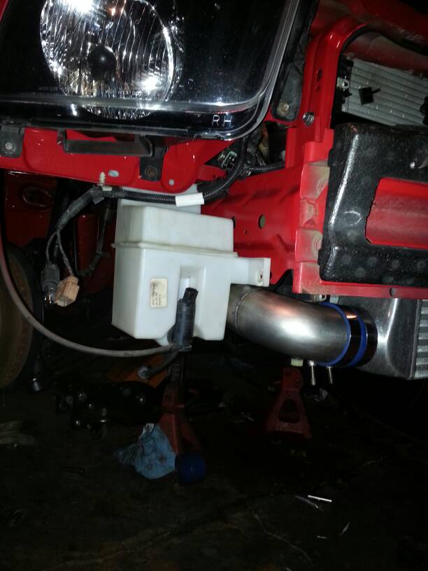

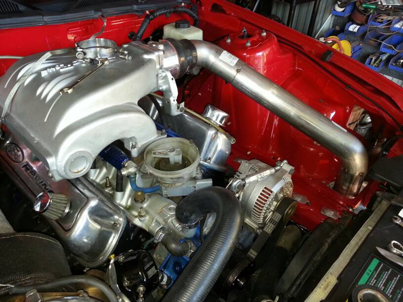

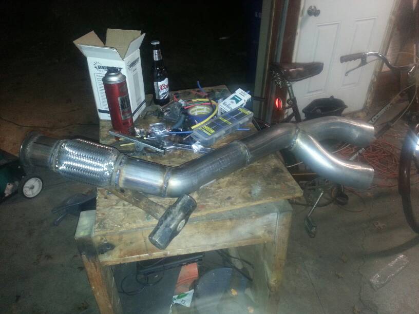

OP, keep up the great work! In for the results. Oh and I think you are wise to try to keep it one piece. I feel like the hp/# boost of turbo cars goes up when the cold side is free of excess bends & couplers to keep a nice flow.

A cheap Ryobi chop saw with adjustable angles helps out too. This 05 has forced me to customize just about everything. It can be irritating at times.

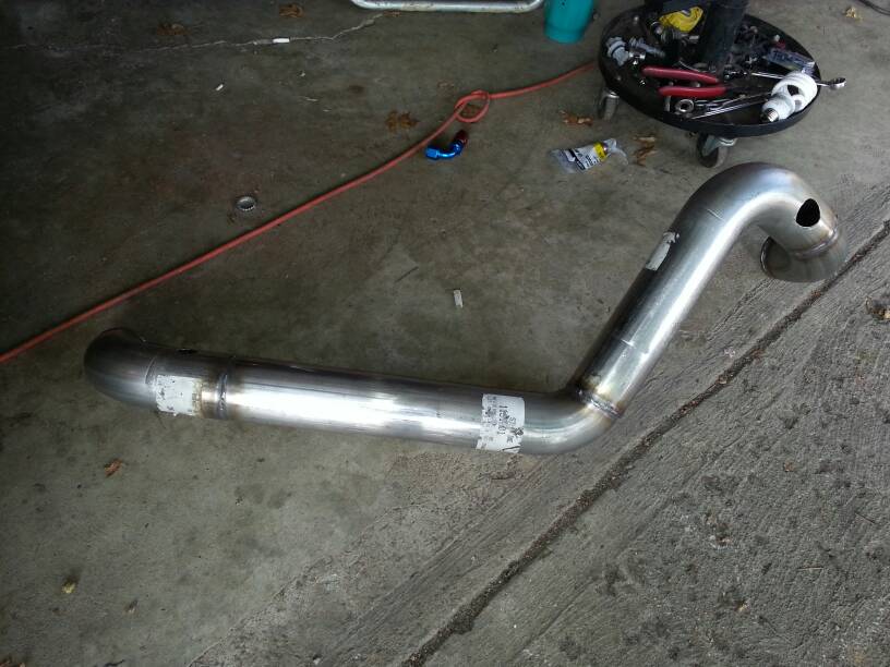

Comments are appreciated. One piece pipe is better. I just hope it comes out as one piece after tacked.

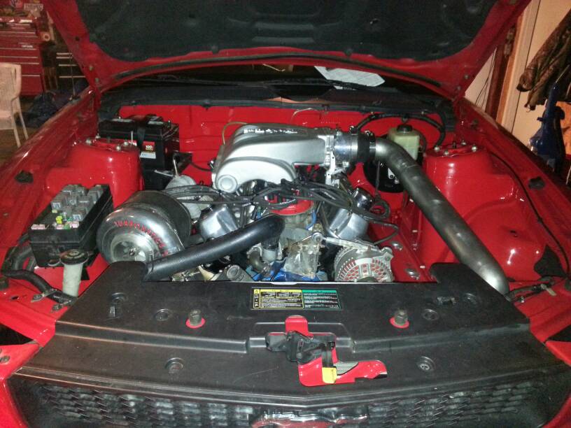

Looks good bud. Your progress goes along very nicely. I really like how clean that motor looks in that engine bay

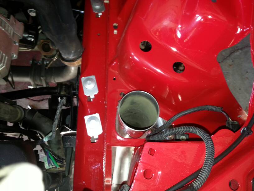

No I run a msd box and coil. I'm looking at a spot to hide it. All I want is the coil showing. The holley hp system is already tuned for prior car. It'll just plug in and mount. I'm going to hook the fan and fuel wires into the existing panel in engine bay.i want sleek and as clean as possible.

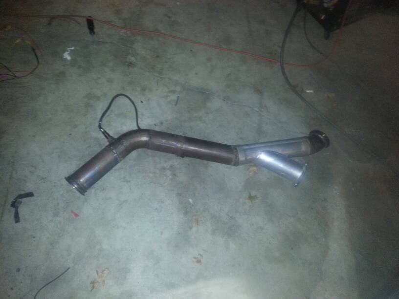

Wiring, trans mount, fuel, wiring left, put stock 06 exhaust on and merge to turbo is all that's left.

just a word of caution... that MSD box is not water proof/resistant AT ALL!!
i had the same one in similar location and water got in there and fried it... what i did on the second one was drill the 4 tiny rivets out of each corner. then sealed it up between the base and the back plate with Silicone/RTV. just a bit of advise...

I drilled mine already and sealed. I had to let that thing dry out a couple times lol before I figured it out. Thanks for the heads up.
