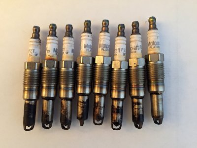

I did it !!!! :headbang::clap:
All came out w/o breaking and new plugs are in !!!!
Thanks for the help guys !!!
