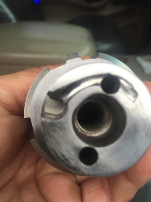

As you can see when the follower stopped the cam the key in the phaser literally cut its own path. So now I have to find a REALLY GOOD tig welder to weld the spot between the oil galley and the keyway and then have the machine shop cut it back down to keep from having an oil pressure problem on that phaser.

Haha the crap I get myself into.. so it probably was in time until the cam decided to stop and the engine kept going..

so the lobe with the busted follower is good?
then how the hell did the cam just stop and get the key to tear into the snout of the cam?

Well it's far from perfect BUT I have complete faith that it won't give me any problems.. it's been magnafluxed for cracks and checked out good and the lobe has been polished to remove any chances of a roller catching anything.. besides there's only a slight amount of surface area affected that the roller touches and it's in the direction of the roller travel. the machinist I use builds airplane engines on a daily basis and has for 30yrs and was very confident that I wouldn't have any problems out of it so I'm going to run it once I get the snout fixed.

It did have an enormous amount of pressure on it but the phaser ended up being the weak link even with the phaser bolt tightened to spec.. honestly I'm glad it and the cam gave slightly, but I'm beginning to wonder if I should lock time the phaser bolt or not with the bolt probably being tensioned more than it should have once the phaser turned on the cam around 100 extra degrees before the follower gave. The threads APPEAR to be good as new so idk if its a bad idea to use loctite or not..
