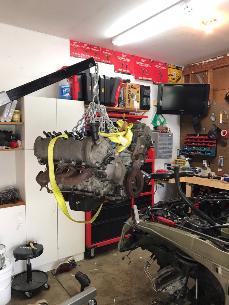

Well got the engine out. Probably can do it in half the time if I had to do it again. Note to self just pull trans and engine at the same time next time. Would be a lot easier.

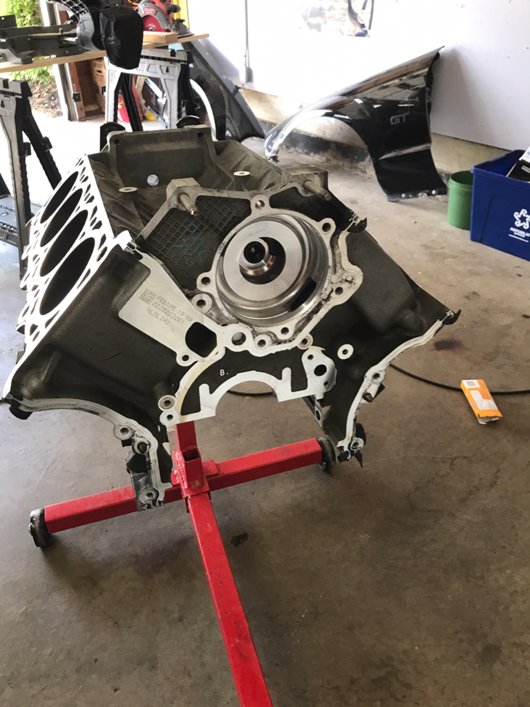

Got a little work done on the block! Anyone else look at their block when it's out and think how small it actually is?

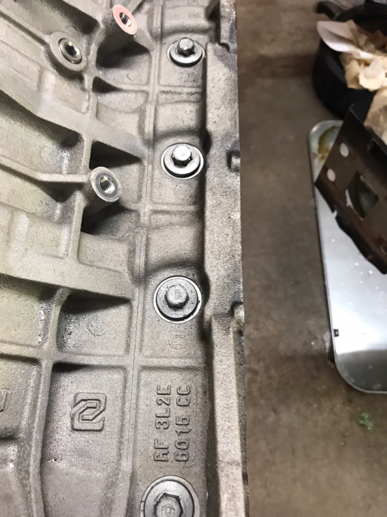

Well got sometime today but tripped the bolts on the block pictured. Now it feels like it's going to be a long process getting those out. Fml. Oh well

Nice progress! That point you get to work on the engine outside the bay is such a great feeling. I am jealous. On the stripped bolts, let me hit you with an old man trick. Find you a deep socket that is a size too small and beat that sucker on. The hammering action helps to be break it loose as well.

been there done that with success on seatbelt bolts

Yeah thanks I have some crap kobalt sockets I will be hammering on them once I get back at it.

Good, I hope it works for you. It has saved me several times. I don't like to be Mr. Public safety announcement, but do wear glasses or something lest the metal splinters off in you friggen eyeball.

Yup. I don't f**k around with my eyes. I wear glasses when hammering or grinding on car. Thx
