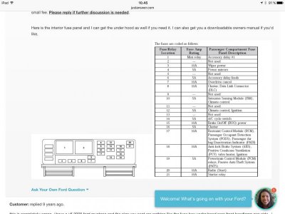

Hi.
Someone can tell me, if It safe to use 10A fuses in the two Not used fuse ports. ( switched #5 and #13 ) SJB ,

Your trying to just put fuses in there or doing an add a fuse power circuit or something? But yes 10amp would be fine it really depends on the load requirement.

Fuse amperage is limited by wire gauge size and wire length. FWIW I haven't seen a mini ATC fuse larger than a 40amp so hopefully your accessory doesn't require more power than that.
