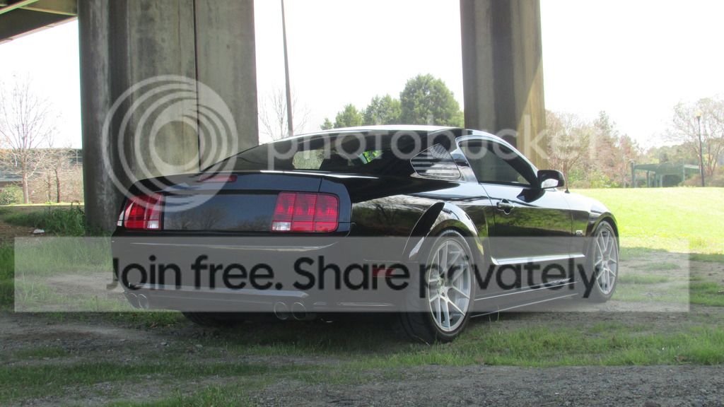

So I have this kit on my car. You can get a good amount of drop and adjustability because you will be running true Coilover Springs vs a full size spring like you are now. A stock damper will not hold up to the spring rates. I have it set up with Koni Yellows and the GC plates. The GC plated are very nice also. If I could do it over it again I would just buy a true set of coilovers since the valving will match your spring rates and what not. Here is a pic or 2 of my stance now so you have an idea of height.
Boss so the upper mount isn't any shallower then a stock or any other Camber Plate setup. Where they get the adjustability is like a standard coilover. They have a sleeve that slides over the housing and with a shorter spring gives the adjustability.
