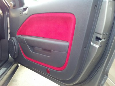

i just got mine covered in red suede. it looks great. you have to rip off all the padding behind the vinyl and it looks much better!

pulled the old vinyl off and the carpet/foam backing board. i took it to an uphostery shop as i didn't want to ruin the suede (its $125 a yard, took one yard). they drilled out the plastic that holds the center plastic to the door panel to get to where it is tucked behind., measured, cut and covered, then put back together with self tapping screws to put the center plastic back on the panel.

damn dude looks good! so does that cardboard stuff that the vinyl is attached to, come off?? i just redid mine today...looks like shit lmfao fml!!!!
