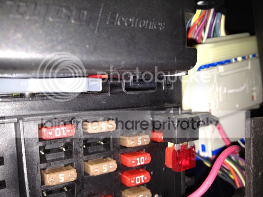

I first tried to tap into a source that was hot only on start to avoid using an add a fuse. I was unsuccessful, so I tried using an add a fuse. I tapped into a hot on start fuse with the add a fuse. Fuse 20 in the smart junction box. Its in the passenger footwell. Put in your add a fuse and connect one color of wire to the end of the add a fuse. I chose to use red.

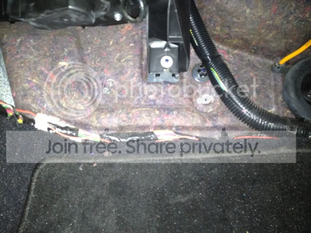

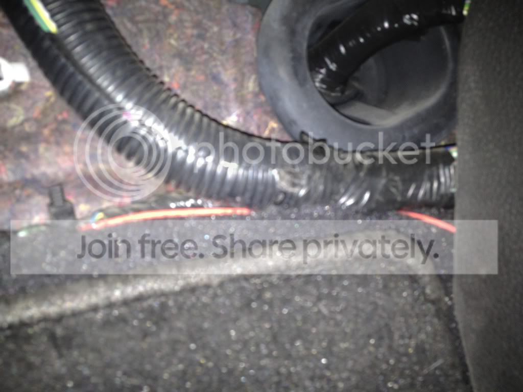

Next I ran my hot wire along the firewall to the center console. I attached it to another harness with zip ties.

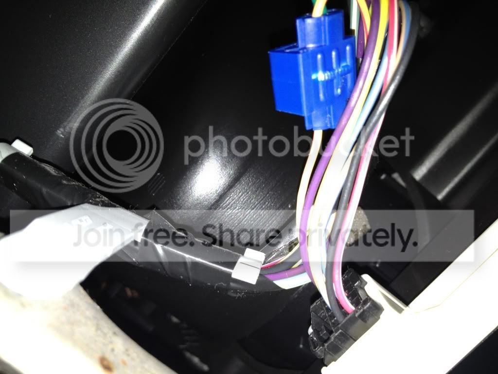

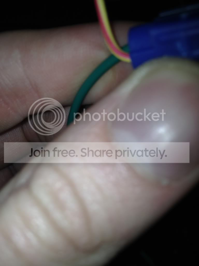

Now take your last color of wire and one of your wire taps. Locate the TCS wire. You'll be looking for YEL/PNK or WHT/PINK. Its pin #7. Now you will want to place the TCS wire and your last color of wire in the wire tap and press the metal guillotine down with a pair of pliers. Snap it shut and run your wire down to the relay.
Once you have enough wire to reach the relay, snip it, strip it, add a female connector and shrink wrap it. You'll plug this into terminal 30 on the relay. Once you have all your wires connected, you will ground the relay and you can mount it right by the ground. I used the bolt in this picture behind the wiring.
