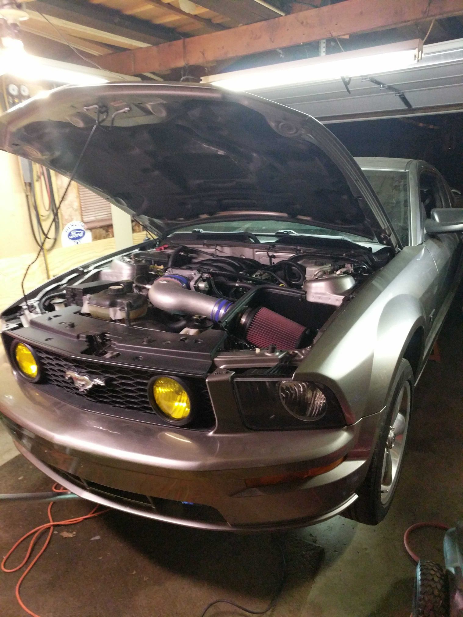

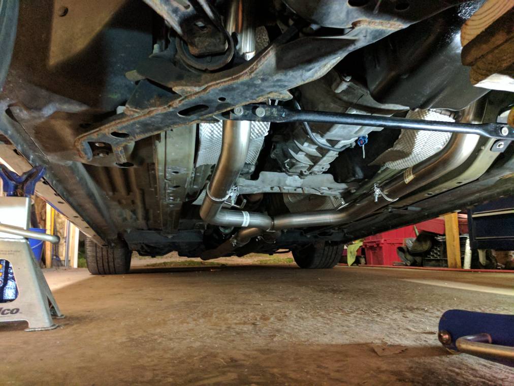

It begins. I'm hoping to drive it today.
