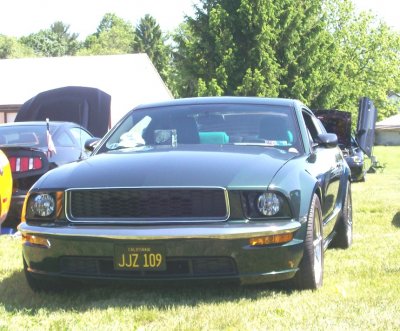

dennisafrompa
Oct 13, 2011
154
No sweat....
...with FRPP K springs that lower 1 1/2". I have 17x8 FRPP wheels for a 2003 Mustang on with no issues. You can see how they come right to the edge of the openings.
