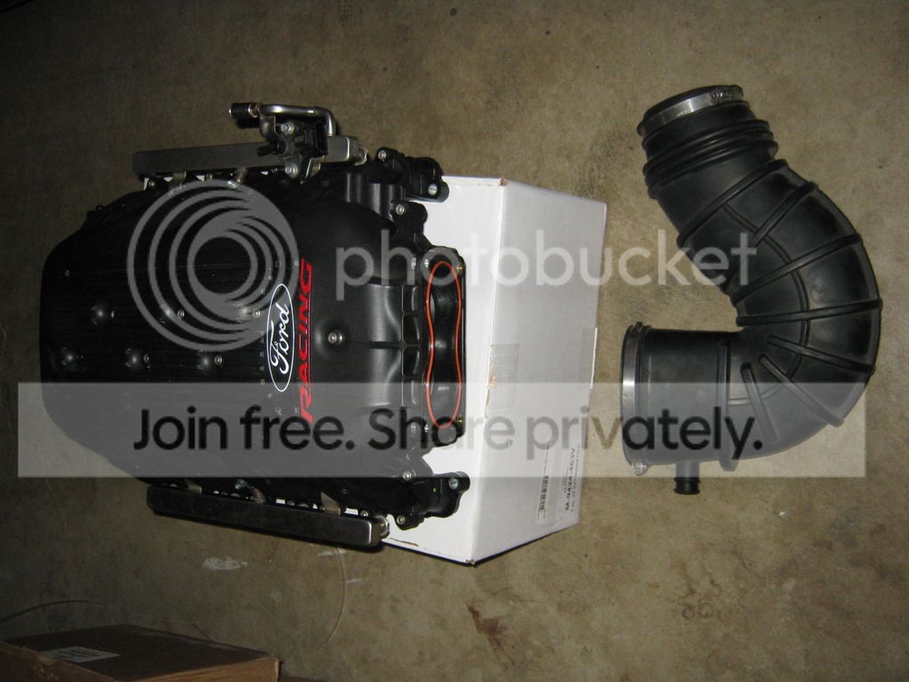

I've purchased a FRPP intake manifold, Saleen high flow elbow, Pypes orh, and Pypes high flow cats.
These parts will be used to regain some or all of the lost power above 5100 rpm.
The plan will start with the FRPP intake manifold. Once it's installed airflow at wot will be monitored to see if there is any and how much improvement. Then the Bullitt elbow will be replaced with the Saleen unit. Then the orh and finally high flow cats on the orh if the orh shows improvements.
Measuring airflow to determine improvements isn't an exact thing. It's subject to the maf xfer function, weather conditions, etc. Still though, it will show something and it will save the dyno for the final configuration once it's determined. I've used airflow measurement during wot pulls to set up cam retard in the past and it worked then.
The intake manifold is prepped and ready to go on. I still had the set of fuel rails I used the last time a FRPP intake was on the motor.
Data logging with the FRPP intake manifold shows about a 10% increase in airflow above 5000 rpm. I think this will be the remedy for the drop in power above 5100 rpm that was seen with the stock intake vs when the motor had a FRPP in the past.
I'm going to get on the dyno in a few weeks. We will see a real apples to apples comparison by just changing the intake manifold.
Edit: The Saleen intake tube restricts airflow just a little when compared to the Bullitt tube. Airflow and the resultant load isn't as linear. My guess is that Ford put some thought and flow testing into the Bullitt intake. The Bullitt tube is noticeably smaller in some areas but it flows more. A guess would be that bigger isn't always better and having smooth flow tested bends and transitions probably helps the Bullitt. I'm also guessing that the smaller intake tube is allowing for higher velocity airflow.
