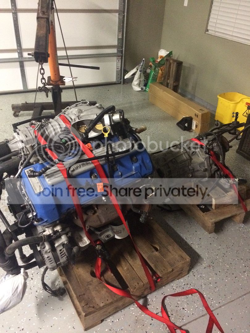

I got e complete drivetrain out of New Orleans. I got most of the wiring and gas tank, engine, tranny, inter cooler and other little items. I don't have any exhaust or interior. If I need to buy new interior I will but don't want to. I just put 08 cobra seats in it.
