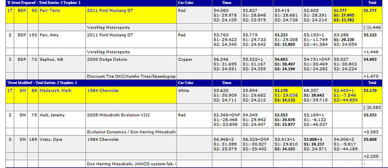

Two weeks ago we had the last autocross for the year lined up. We had the 315/35/18 Kumho V710s still mounted to the Forgestar 18x11"/18x12" race wheels. Hmm, swap to the Hoosiers for this autocross or not? It was the last event of the year and I had the regional class championship wrapped up, so I blew off the extra work of swapping tires and had the guys here at Vorshlag leave those on the race wheels and the 315/30/18 Hoosier A6s stayed on the tire rack. If it was even remotely warm they would probably do all right, and I doubted Madarash would show up to two SCCA regional events in a row (my main ESP competition in this region - the reigning and 8 time ESP National Champion who is brutally fast every time).
Well, I was wrong... he did show up, but didn't run his car. Opie Viets brought his '84 3rd gen Camaro down from his region and ran with Madarash co-driving. And they ran Street Mod, in an earlier heat. Opie's car was similar to Mark's in many ways, and even had Madarsh's old double-adjustable Konis and some other parts of the set-up were the same. But it wasn't Mark's actual 3rd gen, and he told me this past week that it still needed some work. So yea, "I beat Madarash", technically, but it wasn't a real victory - it wasn't his car, running in the same class or heat. But.... I never get to say that much, so I gotta sneak it in whenever I can! :D
Strangely I did place 2nd out of 112 in PAX, which was a first for this car. It was frakkin working WELL on those Kumhos!?! So Amy and I drove together in ESP and ran in the last heat of the day. Temperatures were mild all day and there was water on two parts of the course for everyone's runs. It was there in the morning and kept seeping up through some cracks in the concrete pad, so we all had to deal with it. Oh well, could have been in worse spots.
The course was the same as two months ago for the first 1/4, then it had some tight turn-arounds with short acceleration zones coming out, with lots of tight TIGHT transitions. Walking the course I feared losing to street tired Miatas in STR or the narrow slalom buggies in STX, but luckily that didn't happen. Putting 2.5 seconds on STR and 4.5 seconds on STX was unusual for us, but it felt gooood. Even with a lot of tight stuff the big S197 did all right. :)
Everything seemed to work well that day, for once. The shocks worked brilliantly, as always, but so did the brakes. No "ice mode" or lack of power assist, like the last time we ran here (we put in the 2nd replacement brake booster vacuum hose grommet before the NASA event). The tires were pretty cool all day, but we finally got some heat in them after our 4th runs, which seemed to help. With the new stiffer spring rates we added after the Solo Nationals, and the stiffer swaybar settings that seemed to work best in our private test, the car corners flatter and transitions violently.

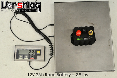

Ryan built a custom bracket for this sub-3 pound battery Mark wanted to try - and the dang thing works! It charges fast and will start the car at least 5 times in a row with the same charge. Dropped 30 more pounds with this battery, and the old one can be swapped in quickly to add ballast or if the new wiz-bang battery craps out. New front wheel bearings, a strut repair, lots of clean-up work, new fluids in the diff/cool and trans/cooler, and a sound test rounded out our work for the week. Mark was very pleased with the car, the exhaust still managed to only blow 95 dB, and he did well at two races at NOLA last weekend.

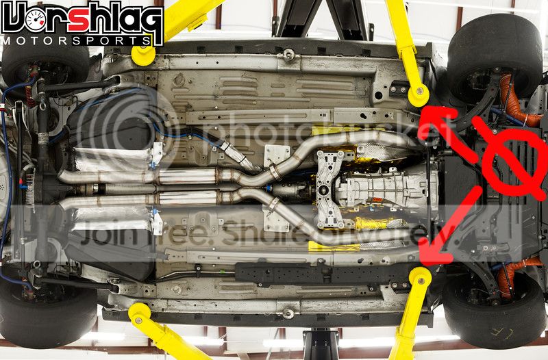

This is for everyone:
I see people do this all the time and it is a bad idea in the long run. If you jack up/support the cars weight from where the K-member bolts to the chassis/torque boxes you will eventually crush the torque boxes. Once the torque boxes are crushed they are a total PITA to fix! I see people doing this all the time.
When jacking/supporting the weight of the car at the front it is best to use the OEM jacking point on the rocker. Which is best done with a custom “puck” with a slot in it that interfaces with your lifting/support mechanism. Or support the car from the inner frame rails.
It’s a bit of a PITA.
Not trying to pick on you Fair, I have seen a LOT of people jacking from the torque boxes not knowing they were slowly crushing them. I learned not to do it by crushing the ones on my 07'.:dunce:
