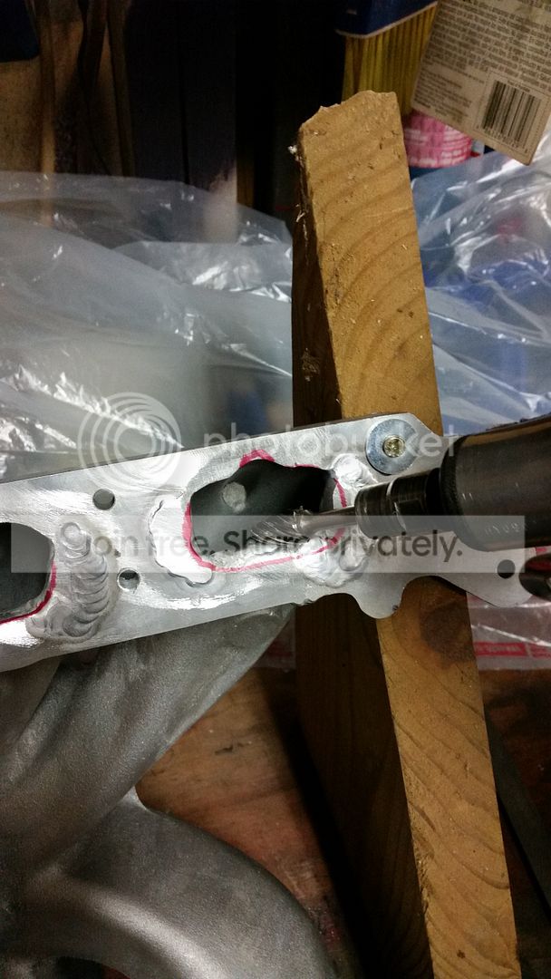

The Sullivan 5.4 intake is really pretty close but the ports on the navi intake are much larger. I could have "LS Swap Hillbilly'd" the ports on the heads to match but it would have required removing a lot of material which would have reduced the sealing surface. Planning on running boost I didn't want to have sealing issues and ruin a set of heads so I opted on letting my buddy weld up the ports on the intake then open them up and blend to match the Yote heads. I made gaskets just cause I didn't want to wait to have it o-ringed. I'll take it off and have that done when I powder coat it later. Gotta test it a little first.

Here's a pic during the process of welding and shaping. It took multiple cycles of this to get them acceptable. We welded the Navi pattern holes in the intake then drilled the coyote pattern. Then I had a friend CNC the edges to match the contours of the eyebrows in the coyote heads similar to the stock intake.
If I did it over I would just make a 1" thick adapter plate and be done.
There was a decent amount of core shift on the casting so we had to correct that as well. Would have been so much easier to make a plate to transition the ports.
Or it it was n/a just down and dirty, hog out the heads to match the navi intake and be done.

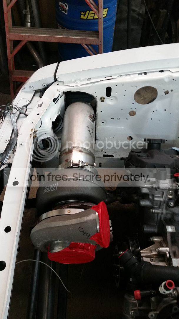

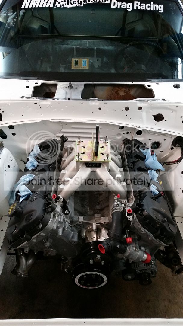

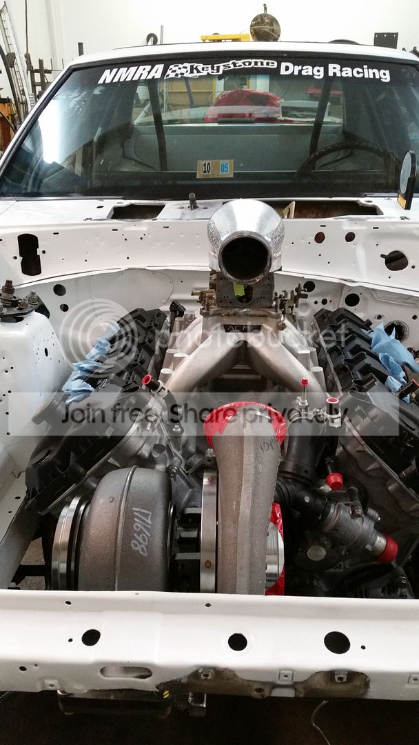

Intake done. Engine is together and in the car. Radiator is repositioned forward plus got the Turbo mounted, headers & hot side made now working on charge pipe.
All down hill from here...wiring, plumbing new aerospace brakes going on...looks like I might just make it for this coming racing season.
Here's some pics...remember it's all about low budget this time.

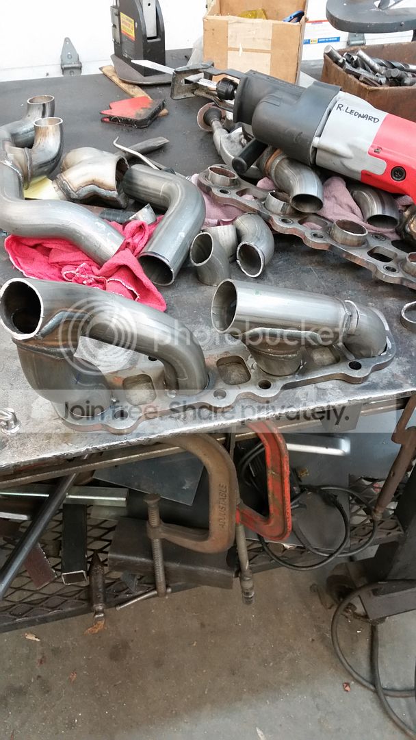

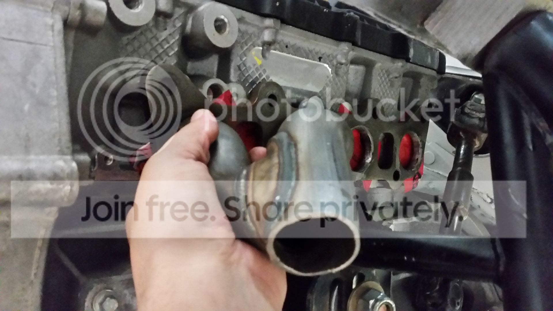

Made headers from two sets of new factory take offs I got on eBay for $175total.

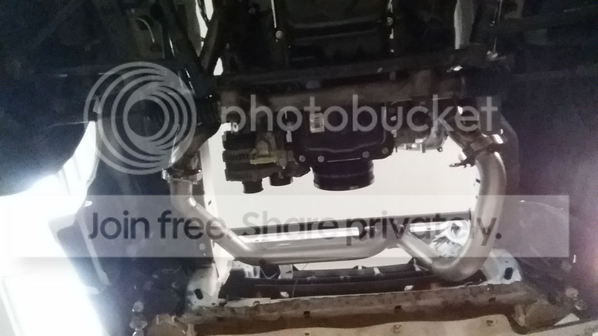

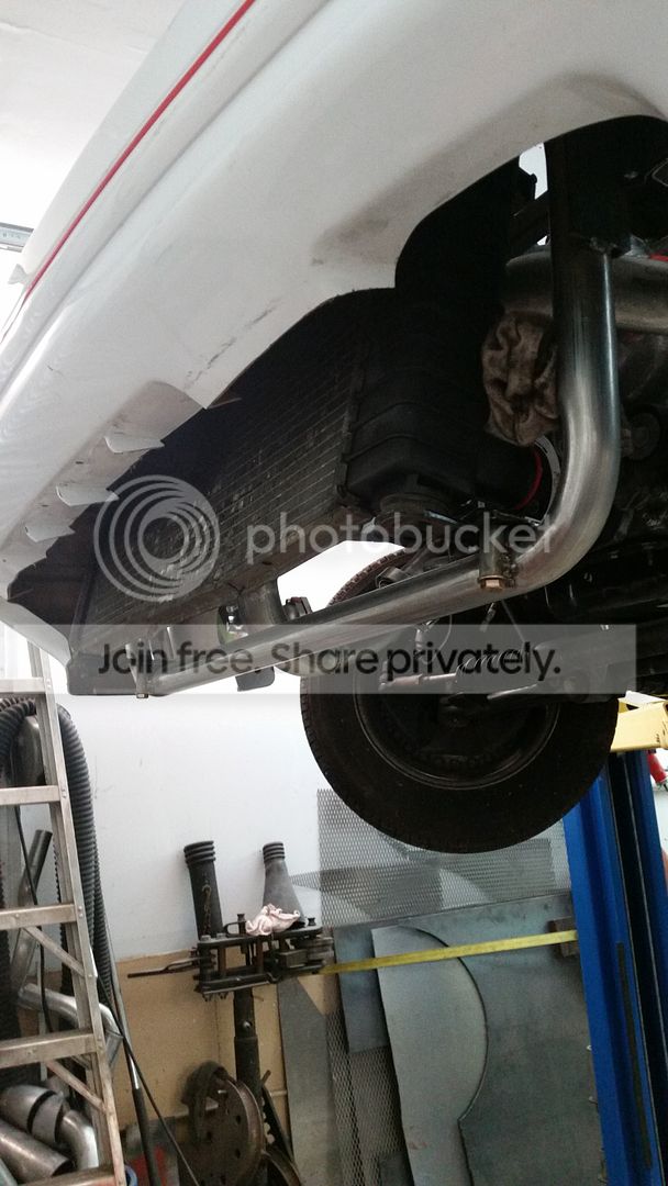

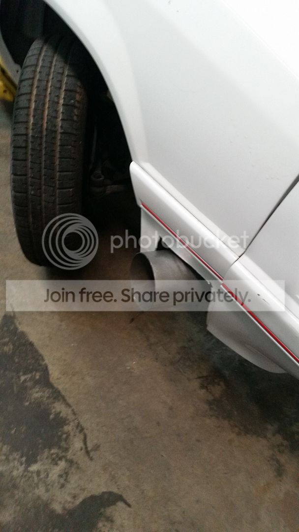

Hot side from 2.25" summit racing u bends and discharge is 5" from local truck parts store dumped out the lower fender. I have a smooth front air dam/valance to clean up the fender area.

Aren't you concerned with the way you have one runner entering in at a 90 to another? Looks like it would kill flow....
JeremyH
3V Fuel Guru
Jan 10, 2009
20,857
197
Virginia Beach
From what I have seen doesn't seem to matter on a turbo car, the turbine is the flow restriction, it will get though everything else pretty easily. Seen some ugly backyard piping builds with truck manifolds and undesirable bends and even straight log stuff knock down 1200hp+.
I didn't like that but trying to package everything meant I had to make some compromises. If it were an N/A effort I would pay very close attention to small things like that (as I did with my 3V car) but with this being a turbo car I figured I can just turn the screw up to compensate for stuff like this.
