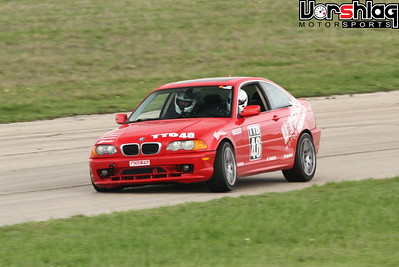

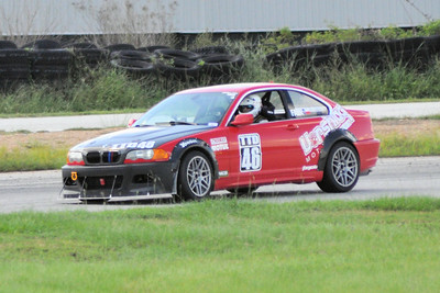

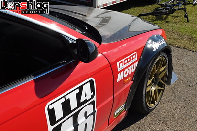

Project update for October 3rd, 2017: I am way behind updating build threads; I need to do about 5 other project updates but I am going to try to do a quick update here. We had a busy summer, which pushed back some work my red TTD prepped 330, but we finally did some upgrades in mid September.

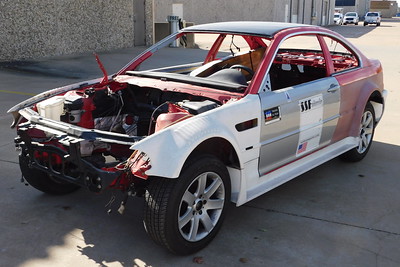

Not only did the front bodywork and aero completely change on the red TTD 330 (above), we completed and sold two of the other E46 cars we have been chronicling in this thread: the 325Ci "Jack Daniels" coupe and the Track Rat 328i sedan (below). This time I will show the final round of work on JD and the 2nd round on the silver 328.

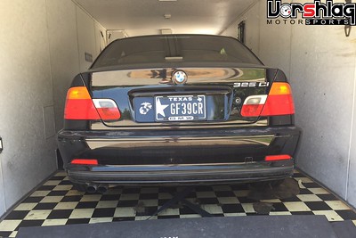

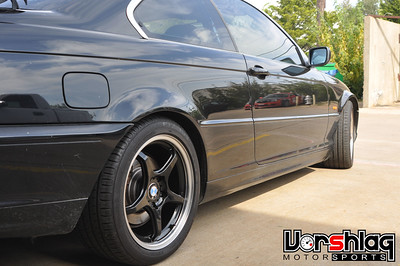

We also picked up another E46 coupe, this black 2003 below. We are just now starting to work on repairing the "little things" to create another "reliable daily driver" for Amy and I to use while some of our other cars are in the shop for upgrades.
I won't talk about the black 325 Coupe above this time, but I will cover work to these other three E46 projects in this post - plus one NASA race weekend - while trying to keep it as brief as possible.

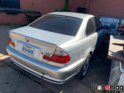

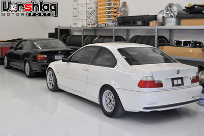

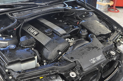

ROUND 317 OF JACK DANIELS REPAIRS + SOLD

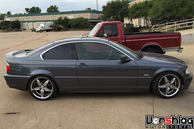

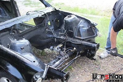

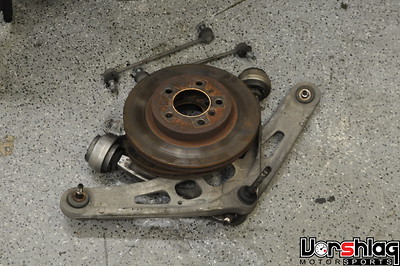

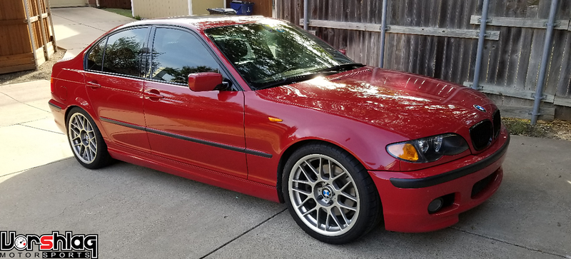

This little "whiskey dented" E46 Coupe E46 started this whole build thread, which we named Jack Daniels. It needed a lot of repairs - too many to count - and I lost money on this car due to the purchase price + parts costs alone. I quit counting hours long ago, because it was ugly.

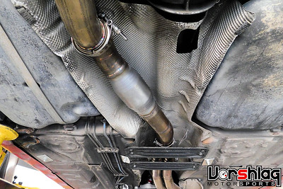

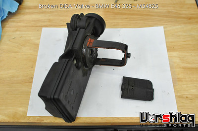

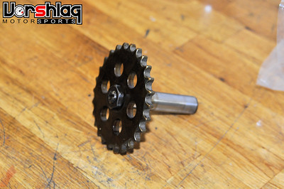

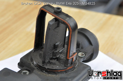

Learned I should have learned long ago - no matter how cheap a car seems up front, starting with a high mileage car coupled with excessive repair costs can bury a project into a money loser right from the beginning. This car needed everything when we bought it with 200K miles: interior work, body work, paint work, suspension work, gaskets/leak fixes, clean-up work, entire cooling system, headlights, and all of the normal things that can plague any high mileage E46.
Even with a shop that specializes in BMWs, and friends in the industry hooking us up on things like PDR repairs, and wholesale pricing on repair parts, I really blew the budget on this one. I won't say how many thousands I lost on this build, but it was enough to notice.
In the end we really cleaned up this little 325 Coupe, and made somebody a nice daily driver that they got with pretty much everything touched or repaired. It had some upgrades that we did when this was going to be our TTD build - the 330 front brakes, Powerflex bushings, etc - and Amy used this is a daily driver off and on for 2 years.
I had people who read this thread that kept calling to try to buy this car for months, but I kept finding things I wasn't happy with and wanted it to leave my shop only when I felt it was "right". So when I drove it recently and felt the rear diff bushing slop, I had our new tech, Aaron, install Powerflex poly diff bushings in all 3 locations (see above). The OEM rubber is just so soft and cracked that this will give whoever buys it less trouble back there.

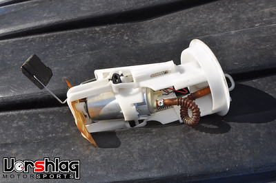

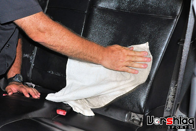

One nagging thing that kept bugging me was the flaky fuel level gauge. It would only read "full" for a few miles after you topped off the tank, then it would ready empty for 3/4 of the gauge sweep. There are TWO fuel level senders and I ordered the primary one that comes with the new fuel pump, shown above. Our crew swapped that assembly in and it fixed the gauge, whew. Notice also: no more dash lights! We only put 7,000 miles on this car in 2 years, but whenever its logged over 200K it still kills the resale value.

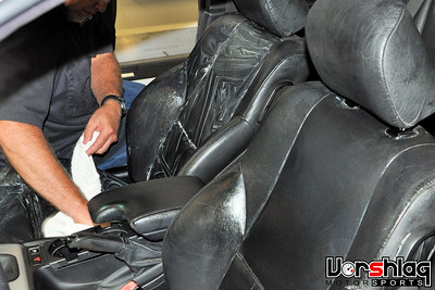

The leather seats (which came from my red 2001 330Ci) needed a bit of work and Brad used LEXOL conditioner to clean and condition the fronts as well as the rear seats. The car was then washed, detailed, vacuumed - cleaner than it ever was while in our possession. I finally felt good about letting this one leave and let the next guy that called have it for a decent price.
When it was time to deliver it to the new buyer he ended up with a lot of repaired systems and a clean, reliable car that is fun to drive for not a lot of money. It won't win any car shows but it should put in many thousands of street miles without too much trouble. It might become the basis for his next WRL endurance race car build in the next few years also. #LongLiveJackDaniels

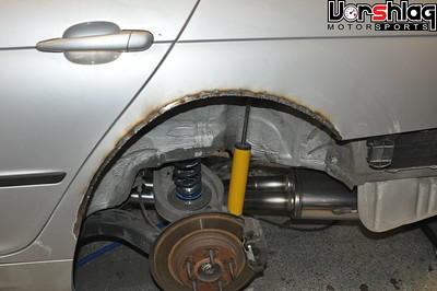

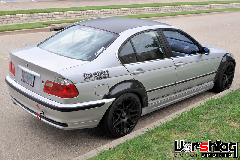

I have talked about the silver Track Rat build in the past. This was a 1999 BMW 328i sedan we bought a while back for another purpose (endurance racing), but when priorities changed I just used this car to fill time in the schedule when our techs weren't on billable work. Which is rare, but still. Last time I showed the 330 front brake upgrade to this car, the Bilstein coilover suspension install, rear subframe reinforcement and bushing upgrades done in late 2016. Let's cover another round of work that happened in 2017: the interior.

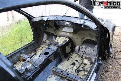

INTERIOR: ALUMINUM DOOR PANELS, FLOORS, CONSOLE, ROLL BAR, SEATS

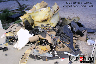

Our crew that started tearing this car apart one weekend (when I wasn't here), to make it into an endurance race car, literally ripped apart and threw away perfectly good interior panels and seats. When we aborted that plan and I decided to make this into a dual purpose street/track car to sell, we needed to keep the windows. Question: how do we cover the door openings on the inside? Answer: fabricate all the things!

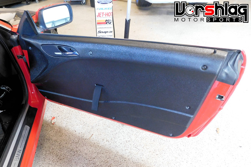

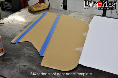

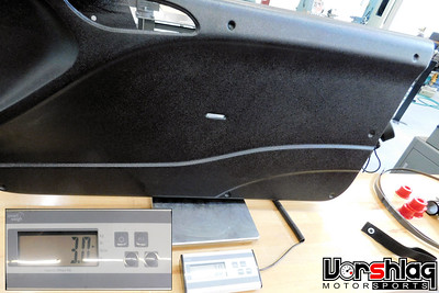

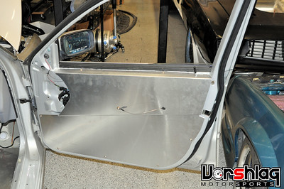

Ryan made some 3D aluminum door panels that tied into the felts at the top and bolt to the doors around the perimeter. These were a little tricky to make and no, we won't likely make a production version. The C shaped cut-out at the front is to clear the dash. The "bump" out of the upper section is to clear the power window motor.

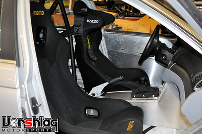

The seats were tossed during the interior removal, too. We stock a lot of race seats here so I had Ryan build brackets and a slider to hold the Sparco Circuit II on the driver's side. Notice how ugly the naked transmission tunnel looks, above?
I got stuck with this unusual and LARGE Momo FIA seat shown above when it didn't fit into a customer's Miata. Plenty of room for wider seats in an E46, so it went into the Track Rat. It uses a fixed mount and fits virtually anyone on the passenger side.

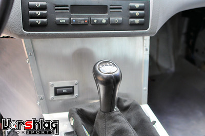

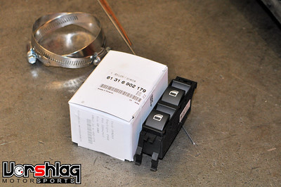

The center console was thrown out also - along with ALL of the window switches, DSC switch, hazard switch, etc. This made me "less than happy" so I had one of our techs make a new center console. It wasn't exactly a fabrication masterpiece but it does the job. Again, this was back when it was just another car we had and I was trying to get it into shape to sell.
The missing switches were purchased (GRR!) and then holes were made to mount them into this aluminum console towards the end of the build. This way the hazards worked, windows rolled up and down, etc. The early E46 uses a DSC button that is different than the late cars... so this was purchased and installed as well (see below). Way too many hours tied up into this aluminum console - if you want to keep it JUST USE THE OEM PLASTICS instead.

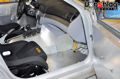

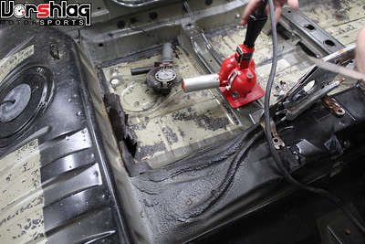

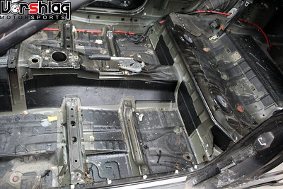

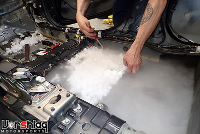

The carpets were gone and with that a lot of padding that covers up a funky floorpan shape and lots of big wiring bundles.

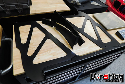

To cover up the "non-flat" floor and hide the wires a pair of "false floors" were built from aluminum sheet. Underneath is a lot of structure to keep them from buckling under the weight of a driver's legs, which is not shown. A custom "Dead pedal" foot rest was added along with some "Grip tape" (above) to keep your shoes from sliding around on the floors when wet.

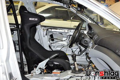

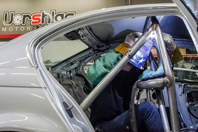

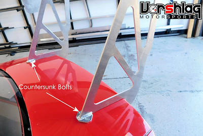

I don't like installing fixed back racing seats into a car without at least a 4-point roll bar. A bolt-in kit was ordered from Kirk Racing, and it shipped in on a flat pallet in pieces. Ryan fitted the roll bar structure to the chassis, tack welded the rear down tubes in place in the car, then removed it to final weld these joints.
The welded assembly was powder coated in a "textured black", then it was bolted into the car. Even the reinforcing backing plates were powder coated before installation. All in all it fits pretty well, with a gap to the roof and B-pillars that allows for this to be installed with a headliner and interior panels. Great place to hang harnesses from...
Well it turns out when you are building a car "on speculation" of selling it, you probably shouldn't install racing seats and assume it will fit the buyer. The Circuit II wasn't the right seat but we had an EVO III in stock that fit him perfectly. This was installed into the Track Rat and the new Circuit II that was in there went into my red 330, which I showed in the last installment. A pair of new Schroth Profi-II 6-point harnesses went in to wrap up the safety/interior bits.

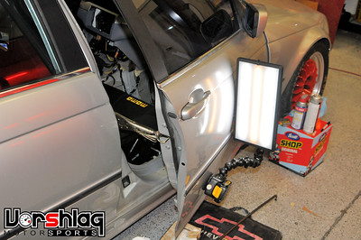

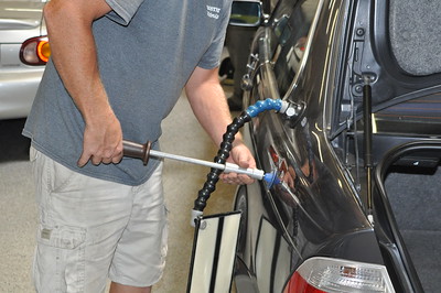

A bit of PDR was done early on in this build to remove some dings and a "wrinkle" in one door panel. Kris did a great job and made this car look pretty sharp - it had good paint, just needed a little massaging.

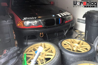

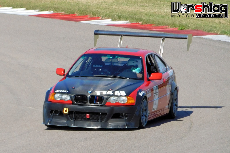

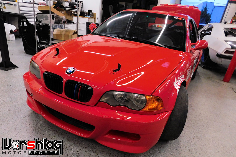

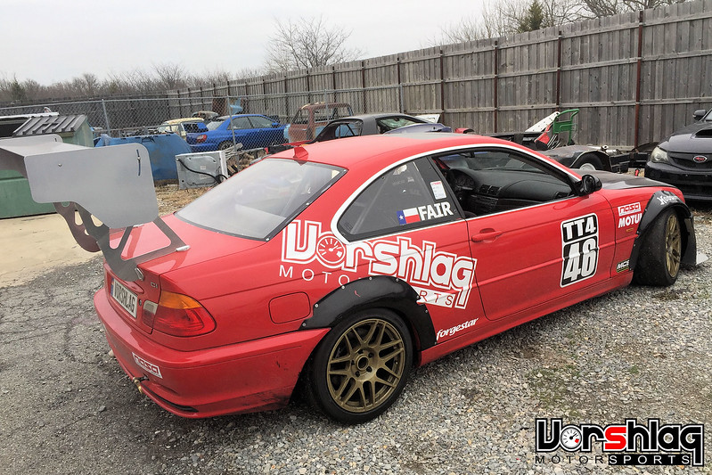

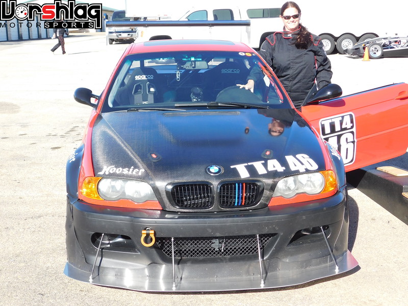

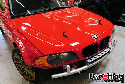

NEW FRONT NOSE + SPLITTER FOR TTD 330

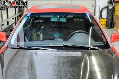

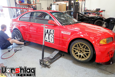

In the last installment we showed a carbon hood upgrade and new seat on the red 330, so it was a bit lighter than before. We had to add back some ballast (which came out when we put in the 4-point roll bar) to meet the 3205 lb weight we were claiming with driver (I had crept up to 217 lbs in the spring, yikes). That 3205 number is 80 lbs under the "base class" weight of 3285, so we have been burning +6 TTD class points to take this 80 lb drop all season. This was because we couldn't figure out exactly what to do with those points...
The 330 did well enough at Hallett in June (2 wins + track record) but we had some really close TTD competition (Acura ITR). Being so far under the TTD class / build "theoretical power" max of 244 whp (at 3285 pounds) is hurting it's competitiveness (only making 216 whp with header, exhaust, CAI, stock tune). A 28 hp power deficit is huge, but we didn't have any points left to make the stock M54 engine substantially more powerful, legally. We were also hitting a brick wall with the BMWeditior software (more on that below) and finding someone locally to tune it to maybe find another ~10-15 whp wasn't panning out. Even "tuned" we could still be 20+ hp short of the class/build max. So what is left that we attack to make the car faster for TTD, that can also apply to TT4 class next year? (TTD is going away)

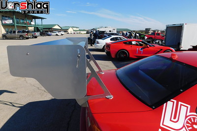

Downforce! To go faster in the corners we need some help from the air, and we have been wanting to add a wing + air dam + splitter to this 330 build since the very beginning. Aero upgrades helped us find a lot of lap time in our TT3 Mustang, but when the "powers above" inexplicably pulled 7 points from the "E46 330" listing in Jan 2016 (the TTE -> TTE* fiasco) it crushed most of my "aero dreams". We spent every classing point carefully, but with only 6 points left (assuming we ballasted up to 3285 lbs) we could only do a few things with aero, and none of it was "balanced":
TTD legal Aero additions, shown with class points
Wing = +4
Air dam = +3
Splitter = +3
Front fascia change = +3 (aka: air dam)
Canards/Winglets = +2 (not legal for TT4)
Flat front flat undertray = +0 (from front centerline to front lip)
Rear Diffuser = +3 (not legal for TT4)
Vented hood / CAI = +1 (already are claiming with CAI)

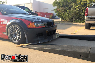

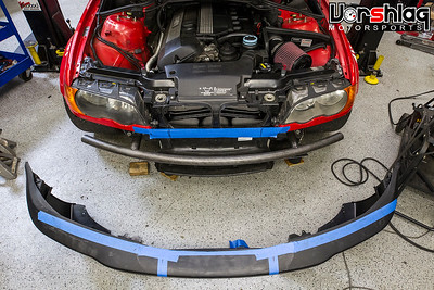

Jason and I brainstormed this part of the TTd build over many lunches for the last two years and could not come up with an aero combination that used all 6 points we had left and could give the car more balanced front/rear downforce potential. I briefly thought about a CRAZY multi-element canard/winglet setup (+2) with a flat undertray (+0) front aero package with a rear wing (+4). The rules poorly define any limits for canards/winglets, especially as to their numbers/square footage/shapes. That craziness might have worked for one event, but then a rules rewrite would have shut that down. And with a planned move to TT4 for 2018, canards/winglets are not legal there. So this would be a lot of weird front aero that could be used for a very time period, maybe not even a full weekend of TT racing.
We also tried to rationalize taking off some mods (brakes, suspension, etc) to "get some points back" for more aero potential, but everything on the 330 now serves a purpose: to test/prove a new part or brand, to make the car faster, and/or make it easier to drive. Nothing there we could afford to lose was worth enough points to sneak in a wing + air dam + splitter. So for now we compromised and pushed for all 6 points to be used on an air dam/front fascia (+3) and full splitter (+3) instead - which could also be used later in TT4. I had picked up a number of these E46 M3 bumper covers a while back and they fit the E46 coupe perfectly. Even the HARD flares fit up to it without modifications. The original 330 nose was also pretty beat up, as pointed out by the #JankyStick above. The M3 nose had better brake inlet duct support, a larger lower grill opening, and a "more flat" lower edge for a splitter. It also looked a lot better.

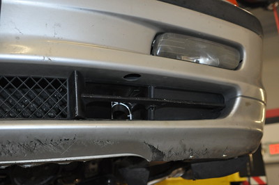

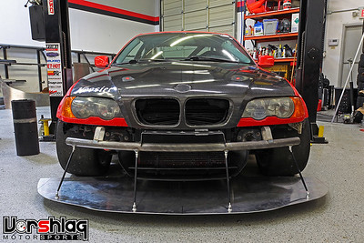

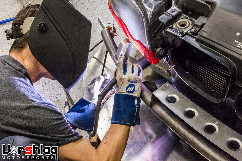

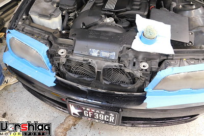

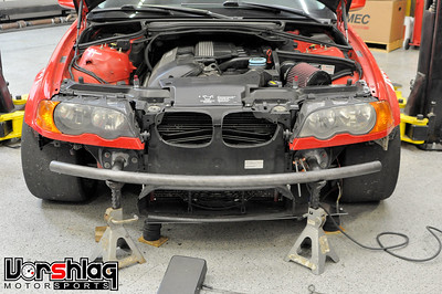

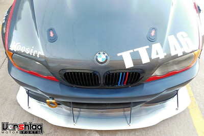

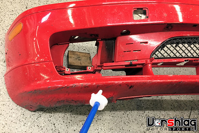

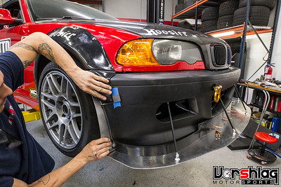

Mounting an aftermarket bumper cover to an E46 could be easier than what we did here, but I wanted to go with with a custom front bumper beam - just like we did on the E46 M3 CSL V8. It is both legal and strong and would probably be lighter, yet loses the "5 mph" bumper shock design. I figured if I hit something on track, its gonna be at a lot more than 5 mph. Aaron used a tubing roller and curved a piece of 1.75" dia DOM tubing, then made some bolt-on brackets and stand-offs, to place the curved beam under the new M3 nose.
Maybe we could have tweaked/modified/forced the OEM E46 bumper beam & 5 mph collapsible bumper struts to fit with this aftermarket M3 nose, but I wanted something stronger and lighter, so this tubular setup was my decision. A raised sheet metal bracket along the middle of the curved beam has a flat mounting face that the bumper cover bolts to, with the recessed stainless mounting hardware hidden behind the hood/grill. Dimple dies keep this bracket light, and two more "loops" of thin sheet metal touch the underside of the bumper cover out on the ends, giving it additional support.
The bumper cover and beam assembly were on and off the car many times for mock-up. The goal was a cleaner fit, so it was not rushed. I wanted this new nose to look good (after it is painted) and have tight body lines when completed. After it was tacked up the beam assembly was removed and finish TIG welded on the bench.

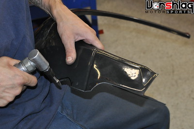

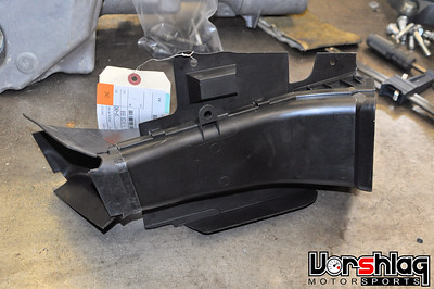

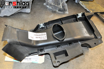

A new OEM plastic/rubber front "radiator inlet snorkel" from an E46 M3 was ordered and installed, replacing the fresh E46 330 snorkel we had put on last year. This plastic piece seals the openings from the two "nostril" grills and lower "mouth" grill of the M3 nose onto the face of the radiator - directing air through the core. Since air wants to take the path of least resistance, without this air snorkel you would lose a lot of inlet airflow around the radiator core. The OEM engineers do a great job of making these inlet boxes have smooth lines, proper angles, and good seal, and it was much easier to buy this $153 part than make it from scratch. We often make these calculations to see when it makes more sense to buy something than to fabricate it - because time is money, for everyone, always. #BoughtNotBuilt

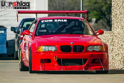

By that same logic, Why not just buy a splitter kit? Guys like AJ Hartman make a beautiful carbon unit that fits this E46 M3 nose. The answer for us was that none of the worthwhile, pre-made splitters fit our class rules, especially the "new-for-2017" TT4 rules. Off the shelf splitter kits rarely fit every class or organization, and some "image brand" parts are not strong enough for real track use.
So this time we did have to make something custom - to fit both the TTD and TT4 rules. We chose sheet aluminum for this splitter design, as we often do, for a lot of reasons. I will address this and the many of the rules we had to interpret to make the max sized splitter for TT4, below.
AERO RULES MEASUREMENT DRAMA
Like we find in almost every ruleset, Jason and I looked at the TT4 aero specific rules and saw things that left some "room for interpretation". In TTD the splitter can protrude past the car a full 12" forward and up to 6" wider than the body. In TT4 a front splitter can protrude 4" forward... but from where? For this event we went with a more liberal interpretation of the TT4 limits rules for our TTD (for now) splitter. Of course the internet erupted with howls of protest when I showed pictures during construction. People cannot be bothered to research the rules or class you are running in, nor want to discuss the nuances of rules that are missing definitions or key words about measurement, in 60 characters or less.
So while this splitter "looks huge", its pretty mild for what is allowed in TT-Letter class (TTD), but potentially not legal for TT4 (depending on how they "intended" for the rule to be) by about 1-2" in the forward direction. We are building for TT4 later this season but at the very next NASA event (MSR-Houston) the car will still be running TTD.
2017 NASA TT rule 7.3.2.D.2
TT4 Specific Aerodynamic Modification Allowances (if not using OEM Mod Factor):
Aerodynamic parts/devices/aides shall be limited in TT4 to the following:
a) All of the items listed above in section 7.3.2.D.1) “OEM Aero” Modification Factor.
b) Vertical front air dam (5º tolerance) that follows the outermost edge of the front and side bodywork/fascia.
c) Single flat, horizontal front splitter that protrudes no greater than 4” from the vehicle.
d) Single rear wing or spoiler that does not exceed a height of 8” above the roof line, or width greater than the vehicle’s body width, or end plates greater than 12”.
e) Modified BTM, non-Base Trim Model (non-BTM), or replaced front fascia (unless specifically approved in Appendix D:
i) May have nothing attached to it other than specifically allowed items (above).
ii) May not have canards/winglets molded into it.
iii) Any item that is molded into the fascia that functions as an airfoil, deflector, dive plane, or vortex generator and extends 2" or more past the outline of the immediate surrounding fascia is prohibited. To inspect: a plumb line run across the entire surface of the fascia and bumper shall not have any such item that extends 2” past the line when viewed from above.
f) Cutting/removal of the rear bumper cover/fascia where it does not cover the rear frame/bumper cross beam.
In ST4/TT4 if you don't use the "OEM" aero rules and chose to take the small p-to-w penalty (0.4) for "non-stock aero" (we will), you can build around these front aero rules shown above. Somewhat limited allowances and lengths compared to TT-Letter, and the entire section is a bit on the brief side. No canards/winglets or rear diffuser allowed (which are legal in TT-Letter). Since there is no side-limit we jump back up to regular TT1/2/3/4 aero limits, which are a maximum 6" from edge of vehicle, so a splitter can be wider than it is long front-back. About that 4 inch forward protrusion...

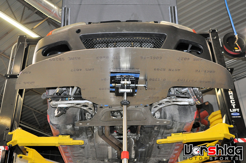

Defining how and where to measure critical components is important in proper rule writing
It doesn't say so in the TT4 splitter rule 7.3.2.D.2.c, but where do you measure "forward" on the splitter from? This is critical and can be interpreted in 3 ways: A) the projected outline of the bumper cover, B) from the base of the front fascia (and which one - OEM or aftermarket/allowed limit of the class?), or C) from the base of the allowable air dam? Since the TT4 aero rules mention "outermost edge" in 7.3.2.D.2.b, and again with a definition of how to measure "past the outline" in 7.3.2.D.2.3.iii, you'd think it was from the projected outline, right? And since an air dam is legal and effectively changes the projected outline by another 5° forward, that moves the "line of measurement" forward as well.
That being said, this is how we measured for this splitter, which I feel is 100% legal for TT4 with the rules as written. Of course after a picture was posted on Facebook, I was told through back channels very quickly that's not what they "intended". So even though the same TT4 aero rules section defines projected outline and references it in two other places, and we can add an air dam with up to 5° off vertical that pushes that outline further, they want us to cut the splitter back considerably for TT4 use. We think... Maybe... The written rules contradict this non-official judgement. You never know how these rulings will go, but it seems to always be against how we interpret things.

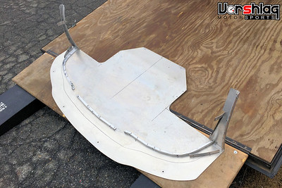

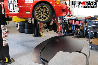

Regardless, this splitter plus another 6" of length was legal for TTD at MSR-H. For the event at the NOLA event in October we will switch classes from TTD to TT4, and there I might ask another TT4 competitor there to file a formal protest on this item, so we can FORCE an official ruling from NASA National. In writing. With a change in the rulebook for next year. This way everyone is on the same playing field in 2018.
The splitter plane itself is .125" thick 6061-T6 aluminum, which is thinner than I normally use so I might not stand on this one like I usually do. The splitter was checked for level and ground clearance at the leading edge was ample at 87 mm (3.4"). This is a more clearance than we have done on previous splitters, like our TT3 Mustang which was closer to 2".

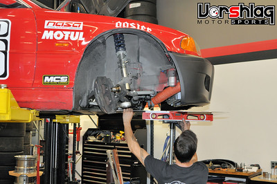

Splitter height is critical, and the lower you can get to the ground plane without the splitter plane bottoming (which disrupts downforce completely), the better. But then there are other real world limits, like the issues of curbing height limiting track width (see above right) and the need to load cars into a trailer or onto a flatbed wrecker (see above left), plus body roll and brake dive / bump travel that can smash your splitter into the ground. You need to plan for this, and sometimes this is only seen in track testing.

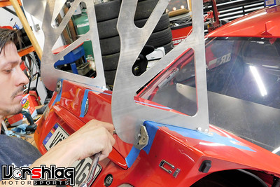

We let some of the chassis give us a starting point. The back of the splitter mounts at the front edge of the OEM factory undertray/engine bay brace - which is a two layer, welded, stamped aluminum structure. Nutserts were added to this and countersunk stainless hardware was added to the back edge of the splitter to secure it there. From there forward it is level - which is required (no up- or down-angle is permitted).

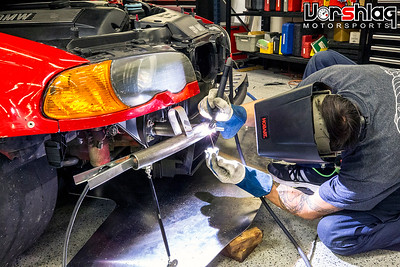

Now it was time to support the leading edge of the splitter. As this splitter extends about 6" forward from the base of the bumper cover, and the plastic fascia is not a good anchor to counteract downforce loads (expected to be in the 100-300 pound range, depending on speed), we need some splitter "stays" or "struts" to hold it in place. Some folks use cables, which only work in tension, but that isn't how we do it around here.
continued below
Vorshlag-Fair
Official Site Vendor
Official Vendor
Nov 12, 2010
1,592
107
Dallas, TX
continued from above
I also wanted the struts to be mounted into brake duct or grill openings, to minimize holes in the (eventually) painted front fascia. Aaron machined thin slices of solid round steel bar with threaded holes, then welded these in 4 points to the bumper beam. The splitter struts extend through the plastic fascia and attach securely. These struts then mount at the splitter plane with countersunk hardware from underneath, with nothing to hang down and get "ground off" on pavement.
With the bumper cover in place the #ExposedSplitterStruts are softened a bit, which a friend G-Speed gives me so much grief for. These 9" Joe's Racing Struts have LH and RH threads, which you can adjust the length of by turning the aluminum hex bar center portion. Sometimes we custom make longer units but it wasn't necessary on this splitter (see below right).
While a carbon fiber splitter can often get by without struts, we are not a composite shop. The costs for replacing a molded carbon splitter ($2000-2500, if one existed to fit this car/class, which it doesn't) also pale in comparison to the $200 that this 4x8' sheet of 6061 aluminum sheet cost. We could cut another from our new pattern quickly. Carbon splitters also fail spectacularly - they can crack, shatter and sometimes explode in use.
Aluminum splitters tend to bend and deform, which can be repaired track-side with a hammer or by driving over the bent piece with a truck tire. Most of the time spent on this "splitter install" (33.01 hours) was the planning, templating, bumper beam construction, bumper cover mounting, OEM inlet air snorkel swap, struts and anchor mounting, tow hook install, making the air dam mounts, adding the air dam plastic, brake inlet duct mounting, tire wall fabrication, etc. Making the actual splitter plane cut-out was probably only 2 hours.
Now we had to fill the big gap between the bottom of the not-quite-flat M3 bumper cover and the top of the splitter plane. This was our air dam solution - some short pieces of aluminum angle (not shown) were bent to follow the shape of the fascia, riveted to the splitter, which then forms a semi-continuous lower mounting flange. Next a small strip of black plastic "race roll" was cut, marked, drilled and mounted vertically to this flange via rivets, and trimmed to overlap the fascia and fill the gap. We didn't rivet the upper face to the bumper cover, as this air dam might change, and the pressure of the plastic (after a bit of forming/heating) made for an adequate seal to the body along the top edge.
These thin aluminum bits are "tire walls", and do not add downforce. They curve downwards
These vertical aluminum parts added in front of the tires (above) are what I am calling "flare extensions". Its really a "tire wall", but they don't define or address this in any NASA ST/TT class that we can find. They also function as an outboard splitter support (we cut the width back from the allowed 6" down to 4", to keep the front end narrower). The black plastic fender flare (allowed) has rules that are a bit vague, so we are calling the more vertical parts of the tire walls an "air dam" (allowed) - which serves the same function here. We went to great lengths to integrate these with the HARD Motorsport flare and keep it from being a potential "canard" (not legal).
These cars both have canards, which are meant to add downforce outside of the front splitter. They curve upwards.
In the 71 pages of the 2017 v14.1 NASA ST/TT rules, there is no definition of a "canard" (3 mentions) or "winglet" (2 mentions) that we can find, but the motorsports world knows what a canard is and how it functions. The purpose is to take air hitting the front of the car and curve it upwards (concave shape) and force the air flow to create some downforce. These do work but are a bit drag intensive. Canards are not allowed in TT4, where we are heading with this car. What we have added onto the 330 are curved the wrong way to create downforce, and really are just missing extensions of the flare to cover the spinning portion of the tire sticking out into the air stream. No downforce generated, just operating as a fender flare for the front edge. Again, we can call the front vertical section of these "air dam" if you want - which is legal.

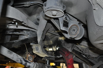

A threaded coupling was machined, fitted into and welded to the bumper beam (above left) for mounting the pivoting front tow hook. Four little aluminum brackets were built to allow the OEM style grills to mount in the single-layer carbon fiber hood (the OEM steel hood has a mounting flange). These provide a function - keep big nasty rocks from flying into the heat exchangers, and the grills fit up against our M3 air inlet snorkel. Lastly a factory BMW roundel hood emblem was drilled and mounted to the carbon hood which has a depression for the emblem plus the two OEM anchors.
That wraps up the front nose + splitter install. Below we will cover some other things that were done at the same time...

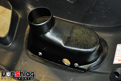

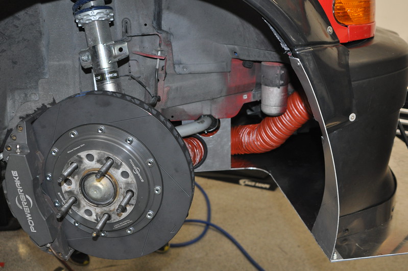

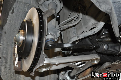

BRAKE COOLING + NEW ROTORS

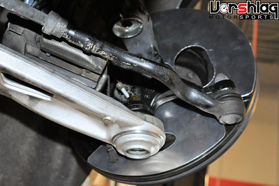

We have been racing this car for 2 seasons without any front brake cooling whatsoever. A stock E46 330 normally has some small "scoop" plastics that sort of push air in the direction of the front brake hub, but its not very effective. And after the front hit that this car survived years before under another owner, all of those undertray, front fender liner, and brake scoop plastics were long gone or shredded. There were entire sections of the fender liner just gone - all too common for a 15+ year old car like this...
Why did I care? We have these massive Powerbrake 4 piston motorsport calipers and 340x35mm rotors up front! Big meaty things that can soak up tons of heat and shed it all easily, right? Well after 1.5 years of abuse, and a few times where I aborted a hot lap right before the pits and came in with hot brakes, I finally warped a rotor. Amy says I came in more than once with the front brakes pouring smoke, hopped out, ran off to get in a student's car, and just left the car parked - which is what probably warped the rotors. My stupid mistake. So for the last couple of events I've had to drive around this issue, which would show up after a few REALLY hard laps and was evident with a pulsation in the pedal.
Even though the rotors have plenty of meat left on them we couldn't find a way to safely turn 2-piece floating rotors, so we ordered replacement rotor rings and new bobbins/hardware from Powerbrake. These were installed onto the original aluminum hats that came with the brake kit. I was hesitant to put these new rings on the car until after we had some front brake cooling upgrade. And that brake cooling was waiting on the new nose + splitter decision. Now that we had a path forward, and a new front nose mounted, it was time to add some backing plates with cooling air, then feed that with some effective brake inlet ducts and hoses.

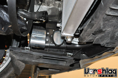

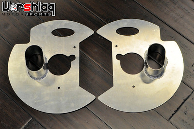

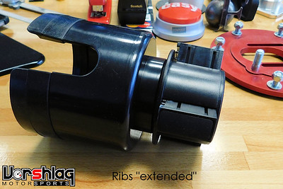

We are developing a front brake cooling backing plate package for the E46 330 using the design above, which we created on the silver 328i shown at the beginning of this post (will show that next time). With a small tweak these backing plates cleared the Powerbrake calipers. The 3" oval hose opening shown should pump air completely inside the rotor hat, around the wheel bearing, and through the rotor ring's curved vanes like an air pump.

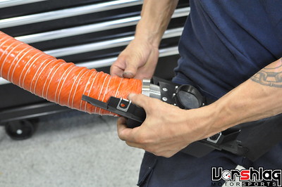

We chose 3" hose for a number of reasons, but mostly because it packages well, provides cooling that is appropriate for cars this size/weight, and is a default brake duct size for most cars. Heavier/faster cars often get 4", but it is much less common on a 2900 pound BMW like this. Notice the vertical wall that has a "C" cut-out for the hose to pass around? That also acts as a splitter mount. We will go back after our next track event and add some inner fender liner sections - from aluminum or plastic - to fill in the gaps and better seal the engine bay. A clean fender liner makes a vented hood more efficient, too.

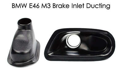

Placement of a brake inlet duct is critical - you are looking for the highest pressure area on the nose without moving the inlets off to the side too much, where the air can roll off to the sides. These HARD Motorsport inlet ducts fit the E46 M3 nose perfectly, so a pair were purchased. Again - we can buy something for a whole lot less than the time it would take to hand-make it here. #BoughtNotBuilt The bumper beam was designed to clear these with the new nose, because all of these pieces interact with each other in the same space.
Right: The hole shown in the duct is for the splitter strut mount to pass thru and land on the bumper beam.
The M3 foglight openings are large and these formed thermoplastic ducts fit around them perfectly. They form a nice curved bell that pushes the inlet air into the 3" round opening, which fits inside 3" brake hose nicely. Aaron mounted these to the M3 bumper cover with rivets hidden behind the front face, for a cleaner look. The hoses route to the backing plates but care was taken to keep them from being rubbed into by the front tires steering at full lock. With a 17x10" wheel, that takes some twists and turns, and the custom vertical splitter mounts inside the wheel well have room for the hoses, but its part of the normal plan when routing brake hoses. This should keep rotor temps from getting high enough to warp a rotor ring, even if I screw up and forget to take a cool down lap after a session. (I did a full 20 minute session of qualifying laps at MSR-H with these brake ducts installed - never saw even a hint of fade or warping).
Even with nearly 2 seasons of track events on these Powerbrake fronts, and the lack of brake cooling, and my mistakes in skipping cool down laps, the PB23 compound pads that I purchased with this set of calipers still have a ton of life! These are motorsports calipers so they are made with thicker-than-OEM pads, but still - many of these race weekends in 2016-17 were with two drivers. Amazing stopping power and pad life.

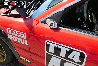

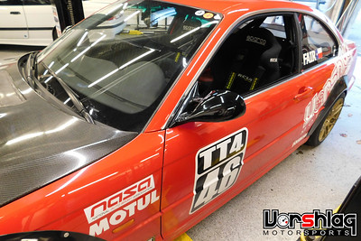

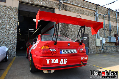

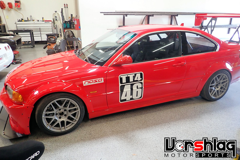

TT4 = NO MORE STREET CAR
There is usually a tipping point you come to in a dual purpose car where it no longer makes sense to keep it street legal. Too many compromises that you have to make for street use that limit the track potential in TT-Number class - especially the aero. Driving a car with a rigid, low mounted splitter on the street is nerve wracking! I feel that our recent "beginnings of the move" to TT4 are already unleashing too many compromises that are just not appropriate for street use. While we kept our TT3 Mustang "street legal" for long time, at a certain point when it became more competitive, it no longer made sense. That's where we are on this 330... inevitable, with the TT-Number move looming just ahead.

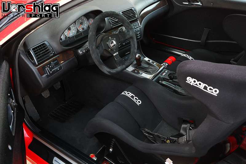

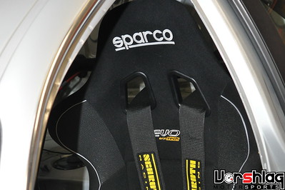

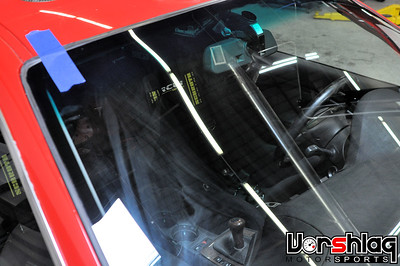

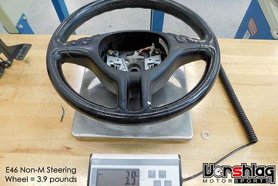

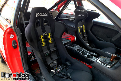

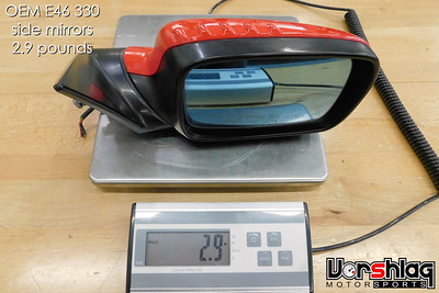

Last time when we added the Sparco Circuit II seat with the halo support the car was safer on track but became less safe for street use. Why? While this style seat really helps save your head/neck/back in a side impact, the halo portion blocks a some of your side vision. I mentioned it briefly then.
In a race car you should have enough situational awareness for this small blind spot to not matter, but on the street where you have a lot more crazy people trying to kill you... not ideal. Swapping seats is a pain and we have so many more daily driver cars (including other E46 models) it didn't make sense to do that with this car, so its off of "street duty" for now.
We also pulled the front seat belts and the Texas rear license plate came off. A fake Euro-style, vanity plate went in it's place (these embossed metal pieces look like real plates and cost $25-35 online). We were also never going to run the TT4 motor with catalytic convertors, which are dangerous to run with in long stints on track with a race motor, so we can avoid that limitation. And registering/inspecting/insuring the car costs money that I'd rather spend on race tires. I just sold the fresh set of Dunlop ZII street tires (to pay for race tires!), dropped the insurance, and decided to no longer "dual purpose" this car. #BecauseRacecar It still has roll up windows and the A/C might stick around a while longer, but those might both go away in the future as well. We will see.

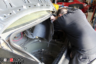

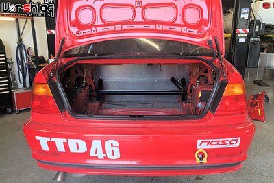

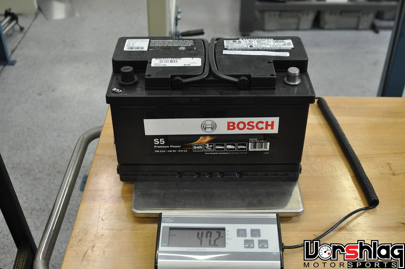

With the 6 points spent on air dam and splitter for TTD we had to add the 80 pounds of ballast back in the trunk, going from the 3205 lb number we have been running this season up to the 3285 lb number shown. We are so far under max power/torque it isn't even worth noting (but we do have it on our classing sheets and dyno printouts).
Two 45 lb plates + one 25 lb plate are double secured to our weight bracket in the trunk. I lost 21 pounds over the summer (Atkins) so I had to add that for a total of 115 lbs of ballast now (the roll bar gobbled up about 60 pounds). We left with only 1/2 tank, to test fuel slosh, too.
continued below
Vorshlag-Fair
Official Vendor
Nov 12, 2010
1,592
107
Dallas, TX
Note that between our first race in Jan 2016 we have gone from a 54% front weight bias down to a much ideal 50.5% front bias now. We have been moving weight down and to the back every chance we get.

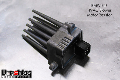

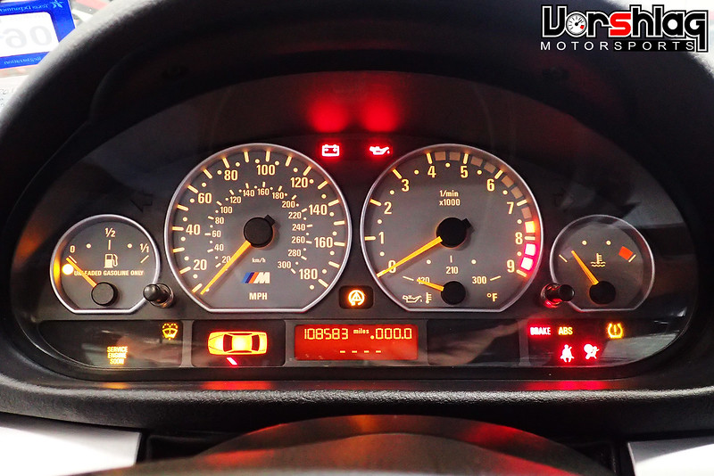

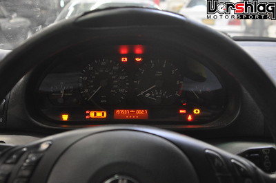

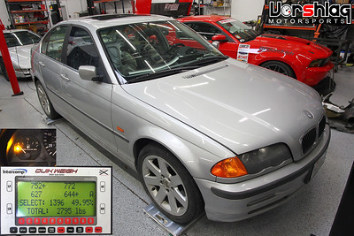

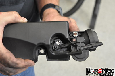

A random failure of a stock gauge cluster in the silver 328 led to a musical chairs of E46 cluster swaps - my red 330 gave up the stock cluster and a leftover E46 M3 cluster made its way in. This isn't a 100% plug-in swap - there's a beeping alarm and "brake light" lit up ever since - but the fuel level, water temp, speedo and tach all seem to work perfectly. Don't know about the oil temp gauge? Bonus: the M3 has a 9000 rpm tach, which might come in handy for next year's motor!
Also (not shown) Aaron pulled inspection covers for the fuel tank to see our dual fuel pump setup, which fuel cut at Hallett in right hand turns with 1/2 tank or less. He re-routed one of the crossover hoses to be able to to retest at MSR-H.

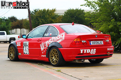

CURRENT TTD POINTS BREAKDOWN
Below is the list of modifications in this, the final iteration of this car for TTD class. TTC goes away in 2018 and rumor has it TTD will be sacked as well, both replaced by TT4/TT5. We won't see those new TT5 rules until its too late to build for next year, but very likely we would have to ballast up or power down for TT5.
Ballasted up to our new TTD 3285 pound number with me in it, + 1/2 tank of fuel, + 5 lb buffer
So we planned on running TTD at least one more time in 2017 before making the jump to TT4. Our E46 330 starts in TTE class and has 39 points to spend with "1 class UP jump" to TTD (+19 points for TTE and +20 points once into TTD). Here's the points breakdown:
+ Base classing of TTE* with 3285 lb min
+ 7 points for the BMW E46 330 "star" added to this car in the 2016 rules (*GRR!)
+ 10 points for Hoosier Racing Tire R7 compound
+ 1 point for 245mm tire size (+10mm from 235mm base class TTE tire)
+ 0 points for weight reduction (we were taking +6 for -80 pounds previously)
+ 1 point for cold air and/or hood venting (haven't vented yet)
+ 5 points for non-stock headers, cats, exhaust
+ 3 points for 2 way non-remote monotube coilovers (Motion Control Suspension TT2 model)
+ 2 points for non stock springs (Hyperco coilover springs)
+ 2 points for swaybars (Whiteline at both ends)
+ 2 points for non-BTM brakes (Powerbrake front 340x35mm 4 piston)
+ 3 points for add, replace, modify front fascia or air dam (5° variance from vertical) - New mod
+ 3 for add, replace, modify a single flat front splitter (up to 6" wider than body and up to 12" sticking out front) - New mod
39 points (everything else we have done is an approved "free" mods)

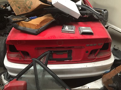

A few days after this race weekend I went by True Street Motorsports (who does not tune BMWs directly, but has a dyno and tunes all of my GM and Ford V8 powered cars), where we made several pulls to see what the power numbers and air:fuel ratio looked like with the wide-band O2 they hook up during pulls. In the graph below we have overlaid the best "stock tune with headers + CAI" pull (in blue) with the best pull of the new "tuned" setup (in red). We made 3 pulls that day but they were nearly identical.
As you can see it didn't change much at all. The "tuned" curve was within 2-3 hp of the old one everywhere, and was actually down 1 hp at peak. If it wasn't for the much worse Air:Fuel ratio I would have guessed that this car still had the stock tune loaded. In the upper end of the power band where it matters, the A:F went from 12.05:1 (rich) with the stock tune, down to 11.05:1 (VERY rich) with the new tune. So it went from bad to worse. Not dangerous, just far from ideal.
I worked in the late 1990s in a shop where we did custom EFI tuning using a chassis dyno (and some street driving) with a wide band. I know what it takes to tune a car, and like I have said in the past, I feel that canned/email tunes or "remote tunes" are impossible to do properly without a lot of time on the tuner's end and someone with a dyno + a wide band at the car's end, so this "shot in the dark" tune went about as I expected.
Now that we know what the hang up was on our end with BMWeditor (the BIN loader software), and we can see what happened between the stock tune and the new one, we can work with the tuning software directly, while on the dyno. If we can get the A:F closer to ~13.5:1 at WOT, that should unlock a few more horses. Running at 11:1 or 12:1 won't hurt anything, just not the way to make the most power on a Naturally Aspirated motor.

As I showed above, the new splitter still required all 12' feet of the 2-piece RaceRamps to load, but it goes in relatively easily. With the front tow hook it can be winched in, but I normally just drive it in and out.

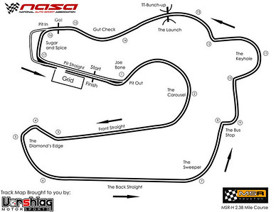

MSR-Houston has been on the NASA Texas schedule twice each year for a while. They alternate the direction for the January event (normally CW) and the September event (normally CCW). For various reasons we have missed the September NASA event here most years, as this is usually a busy month where we have other events going on that pull us away. After looking back at 12 years of running NASA events, I've only found one other instance where I ran this track in the CCW direction - back in January 2014 (when it was cold, where Hoosiers work much better). This might explain why the CCW record for TTD is fairly solid at a 1:48.5 - the MSR-H CCW event wasn't run that year during the traditionally hot "second" September event date. I ran that event in TT3 that year and it was COLD, but I put down a 1:41.4 lap which was the class record until it was reset in 2015 by a TT3 M3 with a giant front wing (which prompted a front wing ban from all TT1/2/3 production cars).
So I was re-learning the track again in the 330 in hot weather on a pretty used up set of tires. But still, I knew we had a setup problem - the car was very loose in high speed corners, especially Turn 2 (the Carosel). I was entering this corner at about 85-90 mph, avoiding the curbs, but it would step the rear out badly at speed. It wasn't shocks or tires, it was mid-corner at the limit - I could enter the corner slower fine, but as I sped up the nose really planted and the rear stepped out. This was the "new front downforce" working like it should, just a little too well. With no rear wing to balance that new front downforce out it had an aero imbalance. Damn it.
It was also very hot and humid - 95°F in the late afternoon sun - which didn't help things. Still, my lap times were getting "better" the longer I drove, as long as I kept my cornering speeds down in Turn 2. Very frustrating - I knew what the problem was, just couldn't fix it without pulling the entire splitter off. About 10 laps / 20 minutes into this session the coolant temps started to creep up. I took a cool down lap and they came back down, but as soon as I pushed it again they were spiking. No steam or water coming out that I could see. I shut off the engine, coasted around the track to pit in, and came into the paddock right as the session ended.
Fuel pump check: The car started this session with a hair above 1/2 tank of fuel and after the 20 minutes on a course with a long right-hander it had no fuel starvation, got all the way down to 1/4 tank with zero issues. At least we can say with confidence now that the dual fuel pump upgrade does indeed work.

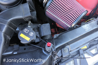

When I got out of the car I could smell just a hint of coolant. Even though we have purged this coolant system of any traces of anti-freeze, and all we put in is distilled water and Motul "MoCool" additive, it seems like you never really get ALL of the old stuff out. I could hear just a small hiss of steam, so I popped the hood and it was coming from a tiny pinhole in the plastic coolant reservoir tank. Almost impossible to see, buried at the bottom of the engine bay.
The thicker aftermarket radiator core was pushes the plastic reservoir a tiny bit closer to the engine, and with some uncontrolled radiator movement the tank started to rub into the power steering pulley - under heavy braking, I guess? The same exact thing happened at TWS last year, and way back in 2011 on my blue 330 with the same radiator setup.

I thought about pulling the entire splitter Saturday night, otherwise I might lose this class of 5 TTD cars with the aero imbalance issue. There were a couple of "dyno-reclassed" engine swapped, gutted race cars in TTD that I had never seen before. The track was still a bit moist from the morning fog/dew, so I came in after the traffic got really bad, not happy with my times but knowing that the sticker/new tire set would help and the fog would burn off before lunch. Sunday morning is always the "money session" anyway. Once back to the paddock Amy said the live timing system "...Race Hero didn't show any times for anyone". Hmm, that's odd, must be a communications problem? Got to grid for my HPDE1 student. And we waited for 45 minutes while they again furiously worked on the timing system again... So we didn't get any official times from the TT warm-up?

The TT4 wing mount will be similar to the E46 M3 wing on the V8 car above (same width as the car, 8" above roof), but with some changes for possible "production" manufacture. I'd just use AJ's uprights but they are tailored for BMWCCA, much lower than NASA allows. We're gonna shoot max allowed width, max allowed height. The endplates will need to be smaller but otherwise pretty similar to the M3 setup.
Before the next event we will trim the front splitter just a bit, to get all of our ducks in a row for TT4. We are signed up for NASA @ NOLA for Oct 27-29, where we will go down on Thursday to be able to run the Friday test day. We will probably step up to 275 R7 tires (max size allowed in TT4), yank all 115 pounds of rear ballast, and jump right into TT4 class - under powered and over weight. We can then work on dialing in the new wing's AoA to get some aero balance in high speed corners, which NOLA has in abundance. There's no prayer of winning TT4 in this car yet, but it will give us an idea of how the class is looking and give us some goals to shoot for in 2018.

Project update for November 10th, 2017: Last time we had a record FIVE PART forum thread update here - and that was only a month ago. And this time... well, its another FIVE part post, so you better grab a snack.
As you can see above our TTD E46 has jumped up two classes to TT4, then we raced it with NASA at NOLA Motorsports Park - with somewhat shocking results. We will cover the latest round of mods (Big Wang!) that pushed this build out of TTD class (a class that is going away in 2018 ) and then chronicle the race NOLA race weekend at the end.
We also need to catch up with work done to the 328i Track Rat dual purpose build we couldn't fit in last time (including 17x10" wheels RS4 tires, above left), and we have recently completed a huge round of repairs to the black 325 automatic we bought earlier this year (above right) - soon to be a Daily Driver for Amy so we can LS swap her Scion FR-S. So once again we have a lot to cover!

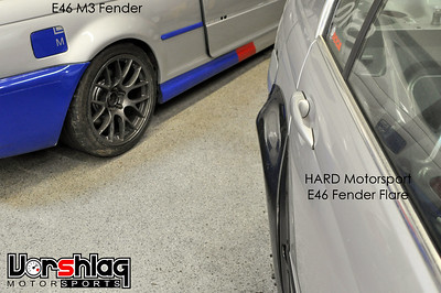

HARD MOTORSPORT FLARES ADDED
We had planned on selling this car with a set of 17x8" Jongbloed 3-piece wheels and Hoosier race tires we had in the shop from another project. When our customer Jeremy saw the car he loved it, but liked the 17x10" Forgestar F14 wheels and flares on our red 330, so we ordered up another set of raw wheels and HARD Motorsport flares.
This set of flares was specific to the E46 non-M sedan chassis. These were mocked up on the front fenders and marked on the paint to see where to trim the fender lips. The mounting holes for the bolt-on/rivet-on flares were also marked and drilled in both the flare and fender.
There was a slight bit of trimming to perfect the fit. After the front fender lip was cut off (at the lower marked edge of where the flare touched the body) they were then riveted in place using the black aluminum rivets included in the kit.
The rear is obviously a lot more work than the front, as these pictures show. We went over this on our red 330 but we took a few more pictures this time. The flares are mocked up and the top and bottom edges are marked, then the outer skin of the rear fender was cut off at the flare's lower edge. The inner structure of the rear fender was then pie cut and folded out 90° to meet the outer edge. These were then welded to the outer skin and the "flaps" were cut off.
The inner structure was then seam welded to the outer fender skin and made waterproof with seam sealer. This is a significant amount of welding that should not be ignored. The structural integrity of the rear of the unibody relies on this outer skin to be welded to the inner skin - don't skip this step.
The fender area was then primed and the flares were riveted on. As you can see the sedan uses some extra pieces that tie into the rear doors, but the structural changes for tire clearance are all done on the rear fender area (the door is not cut). We took the picture above right with these flares and a real E46 M3, and you can see they are nearly identical.

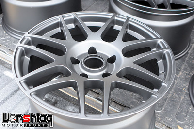

UPGRADED WHEELS & TIRES

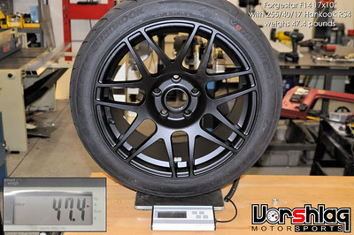

Picking the wheels and tires for this dual purpose street/track car looked at three main variables: cost, grip and wear. The tire options for 17" wheels are less costly than 18" versions, but the width options run out above 255mm width. While we could probably have run an 18x10" wheel and the popular 285/30/18 size under these flares, the customer wanted the more cost effective 17" tire option for this set.
In the 255/40/17 size there are many options to choose from, but for what this car needed to do (drive to and from the track and also put in a lot of quick laps), these two stood out: Bridgestone RE-71R and Hankook R-S4. The price of the RS-4 was a tick lower and it seems to wear better than the RE-71R, but look at the difference in tread width and section widths. The R-S4 is nearly 0.5" wider! Stretched out onto the 10" wide wheel the wider 9.4" tread width of the Hankook will be able to put more rubber on the ground and costs $130 less per set (at the time of this writing). The softer compound of the RE-71R might make up for this width deficit, but the wear would very likely be higher.
The wheel choice was rather easy since we get most of our custom built wheels from Forgestar. We also work with D-Force on flow formed BMW wheels, and their 18x10" option is a nice setup, but he wanted 17" tires so we chose Forgestar. We also work with some other higher cost companies for custom wheel sizes but the price point wasn't right for this build. We ordered a set of 17x10" F14 wheels identical to what we used on our 330, requesting them in a "raw" finish to save time getting them built. One of our local vendors powder coated them with a flat textured black finish, which looks great clean or dirty. The RS-4 tires were mounted and balanced up and of course we got a wheel and tire weight.

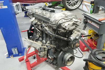

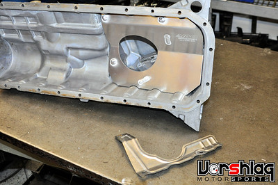

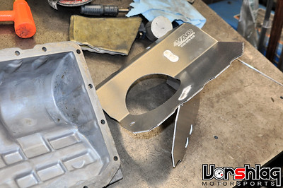

A spare M54 oil pan was already on hand so it was cleaned in the ultrasonic tank at our engine shop, HorsePower-Research (HPR); we keep a spare pan around for these baffle installs because we do them so often. The engine on this 328 was then supported from above with a beam style engine bay stand, and the crossmember was dropped. Then the stock oil pan was removed.
An oil pan baffle from VAC was ordered and fitted to the oil pan. There is always a bit of trimming, fiddling, then some TIG welding to install these. A very worthwhile upgrade for road course use - prevents long high-g corners from starving the oil pump pick-up in the pan.
Another very worthwhile upgrade for track use is a beefier oil pump drive shaft. We picked the VAC unit and swapped that in place of the OEM bits, which had a loose nut on the shaft and was bound to come off. There are other brands and styles but regardless - upgrade the oil pump shaft on any track abused M54 to avoid complete oil pressure loss. Ask me how I know this!

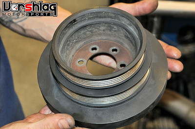

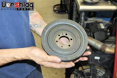

The OEM balancer is usually a cause for alarm for track use, but this one proved to be in perfect shape. No cracks in the rubber isolator ring and it had not "slipped" relative to the hub, so it was re-used (with the customer's consent).
To finish off the maintenance a full change with Motul ester based synthetic oil, Wix oil filter, and Gates belts were installed.
Early on in the build I decided to replace the exhaust with a Magnaflow stainless cat-back system. This system fit great except right at the dual tip opening in the rear bumper cover. That was trimmed to match the wider exhaust tips and now looks OEM.
FRONT BRAKE COOLING
On a road course you have to use the brakes, a lot, creating a lot of heat. To keep the rotors, calipers, pads and fluid in the proper operating range you should really think about positive pressure brake cooling. The OEM brake cooling from BMW is barely better than nothing, and the E46 non-M has poor brake cooling support from the aftermarket, so we set out to develop something for the E46 330 front brakes (which we have on the front of this 328i).
For the prototype setup we made the backing plates and ducts at the hub from aluminum, hand cut and TIG welded together. If/when we make a production version it will be made from stainless steel and CNC laser cut, but for a one-off aluminum works fine. The backing plate is designed to push as much air inside the rotor face, to cool the hubs then be sucked through the vented rotor like an air pump. We went with a 3" oval opening, to keep almost 100% of the airflow inside the rotor face. The closeness of the backing plate to the rotor face is to help seal the hub area to the ducting, so air won't go around the rotor but instead through it.
Once the backing plates were welded they were bolted in place and 3" high temp brake duct hose was attached to the oval inlets on the backing plates. These need to be fed from a high pressure zone at the front of the car, which we will show below.
We need to feed high pressure cooling air to the backing plates, and that air comes from the front of the car. Since the customer did not want to switch to the E46 M3 nose - which has better brake inlet options - we re-used the OEM inlets in the lower grill.
Again, the OEM setup has some brake ducting, but it just dumps air into the inner fender. We wanted to keep the forward inlet sections that seal to the front nose but re-route into hoses that run along the front swaybar. Above you can see where a "bite" was taken out of the OEM outlet, which puts cooling area "near" the hub area. As the tire turns it cuts off that supply, so we needed a re-route ahead of that point.
The smooth plastic rectangular duct work from the factory also incorporates some of the inner fender liner. These are actually very well made, but the original bits from this car were long smashed and/or missing. So a pair of new ducts was purchased from BMW. These molded plastic parts have rubber flaps at the front to better seal to the bumper cover's rectangular openings.
About a third of the back sections of these new ducts were cut off, then some aluminum oval tubing sections were fabricated, shaped, and riveted into the rectangular ducts at the rear - pointing them away from the fender liner and tire.
The pictures above show the modified front inlet duct work installed, and the diverted section that normally cools the alternator (which seems a bit silly) was blocked off to force all of the air into the brakes. The 3" high temp hose was slid over the rear...
The hoses were secured with 3" worm gear clamps and the brake cooling was complete. Doesn't look impressive externally, since the front inlets are stock, but it definitely pushes some air through the rotors and keeps the brakes and front hubs cooler. This front duct work was so customized it is not likely that we will make production "inlet duct kit", but maybe some E46 owners will see what we did and make their own home brew versions.

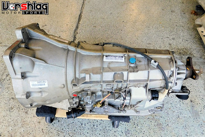

2003 325Ci COUPE AUTOMATIC
Earlier in 2017 I picked up a "problem child" E46 coupe from a former customer who was just tired of dealing with maintenance issues. We used to be his shop of preference back in 2011-13, but when our shop moved from North to South Plano the distance just got too great and he stopped coming to us for service. He ended up getting the run around from a "normal repair shop", the type of place where they mark up the parts 500% and charge way too much for service work. Repairs bills with $800 starter replacements started wearing him down.
That kind of repair bill terrorism sucks, and I felt bad for the guy. When this car was under our care we took good care of it, and even upgraded the stock wheels to 17x8.5" D-Force wheels, replaced the A-, B-, and C-pillar interior panels, and did all sorts of maintenance. We have since steered away from doing "basic maintenance work", because unless you are willing to rip people off its a tough business to make money in. Now we do more track prep, suspension, chassis, safety, and fabrication work - which still doesn't make any money, but at least it is fun! :D
So back in the spring he called me and said he wanted to unload it. His kid had kind of driven the car hard and it wasn't nearly as pretty as it was when we last saw it, 3 years earlier. It ran very rough, had a bent wheel, and needed many repairs. I bought it and hauled to the shop to get it cleaned up and running better.
Facebook just reminded me today that eight years ago I bought my first E46 (actually two on the same day). At this point I've stopped counting the E46 cars that have "followed me home", but they always leave our care in better shape then when we got them. That silver 328i above was transformed, and even Jack Daniels left cleaner and better running than before. Well this black 325 was barely running with a massive intake leak, plus that bent wheel. I figured this one would be an easy fix. Of course I was wrong!

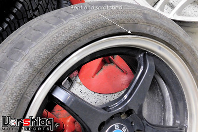

DISA VALVE UPGRADE + WHEEL REPAIR

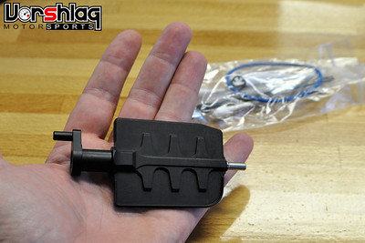

The M54 family of engines has a "dual tract" intake manifold, with a "DISA" valve after the throttle body. This valve switches between a long and even longer set of runners on the intake manifold. These valves are notorious for sticking and worse - falling apart and being ingested inside the engine. This one was literally falling apart, and luckily hadn't been eaten yet. It was leaking badly at the mount on the manifold, which is why it ran so poorly.
We learned that the M54B30 DISA valve we had from another 330 motor doesn't fit the smaller 2.5L M54B25, so it was time to rebuild the original DISA unit in this car. Like always I ordered the repair/upgrade kit from German Auto Solutions (I am not a dealer nor do I have any affiliation with them), shown above. This replaces a bunch of janky plastic parts with stronger, machined parts made from better materials for about $75. These are the features right from their website:
  • The plastic flapper valve has been replaced with a black anodized & stress relieved 6061-T6 aluminum flapper valve that is twice as strong and many times less brittle than the stock part it replaces.
  • The plastic crank lever has been replaced with a black anodized 6061-T6 aluminum bell crank lever that is four times stronger than the stock part it replaces.
  • The flapper valve and lever lock together on a precision machined hex shaped taper & are screwed together, instead of just snapped together like the original design. Locking the parts together prevents any possible movement and wear between the two pieces, the #1 cause of failure in the stock design.
  • The parts are securely locked together by a custom, light weight, titanium pivot screw that's held captive from outside the housing. The titanium pivot screw also replaces the stock steel pin of the original design. Since the pin is part of the pivot screw, and the pivot screw is held captive from outside the DISA housing, there is no longer a possibility of a steel pin coming loose and getting sucked into the engine
We do this upgrade on virtually all M54 cars we build to race or to street drive. For $75 in parts you can prevent catastrophic engine failure, and in this case make the car run 1000 times better. This should be on the list for ALL E46 CARS PURCHASED.
These new parts + an upgraded Viton O-ring (also from GAS) were installed into the old DISA valve then it went back into the intake. And it ran smooth as glass! The wheel was repaired and looks as good as new, too. Still had some leaks to fix...

I want to make this slushbox equipped E46 coupe into a nice, reliable, smooth riding commuter car for my wife. Her commute is pretty crappy and has a lot of stop and go traffic, so the automatic might be a nice change from her normal manually shifted cars. So to keep it simple we're NOT upgrading the brakes, suspension, or engine beyond new stock parts.
This engine has the normal leaks and the first place we often look is the valve cover gasket. Sure enough this rubber gasket had turned into a brick, cracked, and was leaking badly.
With a new gasket, spark plugs and some engine bay pressure washing once it was buttoned up the engine was now leaking much less. We're keeping an eye on the now clean engine looking for additional leaks to tackle, but for now its a whole lot better. Some vacuum lines were also replaced at the same time.
The old battery was a massive lead acid unit, which was very old and was not holding a charge. This poor car sat at our shop for 2 months waiting for a break in the schedule and was driven out of the shop and back in every day, so that didn't help the battery's life. This new Bosch unit is the same size as the OEM battery and tips the scales at 47.2 pounds!

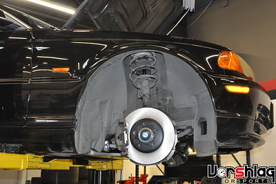

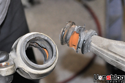

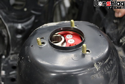

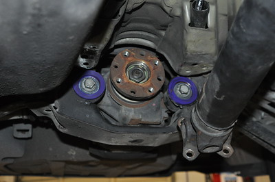

The suspension was pretty tired, not necessarily from the miles (160K) but the age and use (it was 100% part of a daily driver grind). So new OEM replacement control arms, LCA bushings, inner and outer tie rods, swabar end links, top mounts and drivetrain mounts were ordered. The old ball joints and bushings on the control arms were hammered, but the new bits fix all of that. Normally I will always go to Powerflex 2-piece LCA bushings at the very least, but this time I went with stock. Should ride smooth like butter!

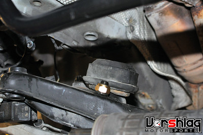

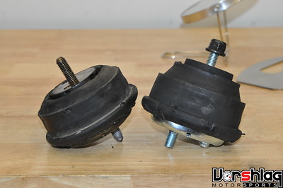

The stock motor mounts (see old vs new, above left) and strut top mounts (also old vs new, above right) were both worn and "shrunken" over time. This is what happens to rubber after 13+ years - and we went back with stock bits on these parts as well. Rare for me, but we have ZERO delusions of this car ever seeing track use.
The rear brakes looked fine but the front rotors and pads were done, so those got replaced with Centric Premium rotors and Centric branded ceramic "ultra-quiet" something-or-other pads.

INITIAL TT4 PREP TO E46 330
You made it through the work on the silver 328 and the stock black 325 above, so now we finally get to talk about the red 330! Last time we covered a ton of work to the front of the car - new bumper beam, M3 bumper cover, inlet ducts, brake backing plates, splitter, air dam and tire walls. We took it to MSR-Houston and.... had a massive aero imbalance. All front df, no back aero, not hard to imagine, right? What would fix this aero imbalance - nothing less than a massive rear wing.
We were out of points for TTD mods, thanks to the re-write of the base classing in 2016, otherwise we would have done this full aero build TWO YEARS AGO and been much faster this whole time. Since TTD goes away next year, we were way ahead of the season long 2017 regional TTD championship back in June, and since no TT cars got points at MSR-H due to timer issues, we had a lock on the regional TTD class championship. So we decided to test the waters in next year's class early - TT4.
There were a few small repairs and updates needed but the bulk of this work was all about the rear wing.
WINDSHIELD REPAIR
We started out by replacing the front windshield, which had a massive crack in it on the passenger side, which was growing.
Since we no longer had plans to ever street drive this car we could get the less costly, thinner glass windshield without the "Rain Sensor". $130 installed, no more crack, no more pitting, perfect.

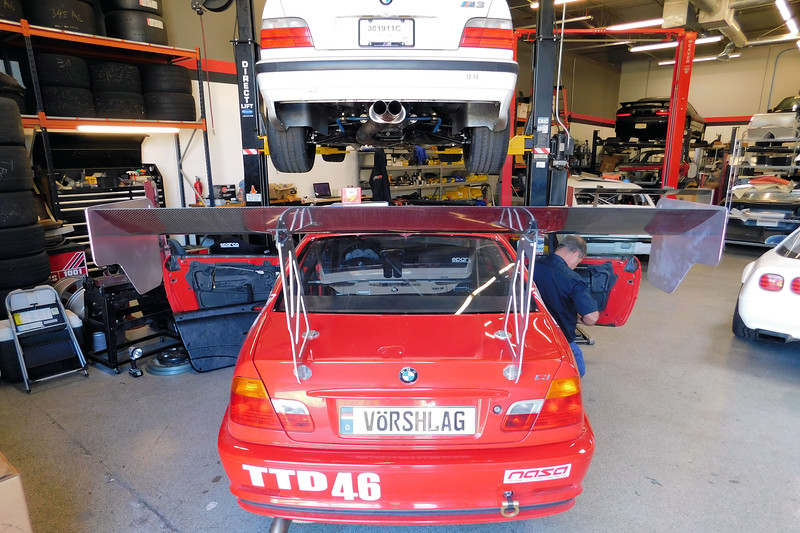

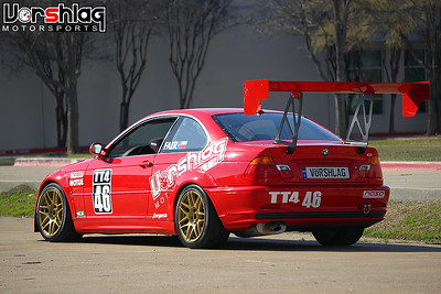

BIG ASS WANG

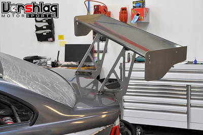

We had read the TT4 aero rules very carefully a few weeks earlier and had ordered an AJ Hartman Aero carbon fiber wing element to fit the limit of the class - which can be as wide as "the maximum width of the car" and placed "no more than 8 inches above the roof line".
There are no other wing element or mounting limitations. We measured the stock bodied 2003 325Ci Coupe width at 69" at the rear fender lips (we have to ignore the side mirrors), then ordered the 14" chord wing at 68-1/2" wide, to have a bit of margin for measuring error. Now it was time to make uprights using the basic shape and height of the E46 Chainsaw Massacre build's wing.
Ryan had fabricated the uprights for the M3 by hand, and it took a big chunk of time to make all of those interior cuts. This time I asked Aaron to make the set for my 330, and we worked with Jason to simplify the trunk mounting points and removed the extended lower bumper beam section. We moved the wing forward a hair but kept the same basic height. The first mock-up were made in fiber board, shown above.
After I sketched what I wanted changed from the mock-up he was able to get that into CAD, make some CNC plasma cut uprights, and incorporated a slot-and-key feature I wanted with some load spreading mounting plates. These four slotted mounting plates self-jigged into the keys of the uprights to make fabrication easier and more repeatable.
This worked perfectly and the mounting plates were tack welded to the uprights on the car. These were then removed and finish TIG welded on the bench, with a good bit of heat. The mounting holes were countersunk and flush mounted hardware was used to secure them to the trunk from the inside.
This was all designed in up front but to verify legality we moved the wing to maximum Angle of Attack (AoA) before stall (12°) and using a level from the rear of the wing and an 8" tall box on the top of the roof, we were within the limit of the rules. We set the AoA to 6° based on some calculations and speculations as to the effective downforce of the front splitter. We could dial the rear wing to balance the front at the track soon.
The wide angle lens makes this wing look much bigger than the car, but it is in fact 1/2" narrower than the stock fender lips, and well within the limits of the class. The end plates were direct copies of the somewhat subdued units from the V8 M3, and also well within the limits of TT4 class rules.
WEIGHT SAVING INTERIOR UPGRADES
Moving to TT4 means we would be massively overweight with the power we currently have (210 whp avg, or 216 whp peak) for TTD - hell, we were 30 whp down for TTD, but had no more points for upgrades in that class. Until we do something drastic we could at least ditch some weight. 115 pounds of ballast in the trunk was easy, but after that would start to get more difficult.

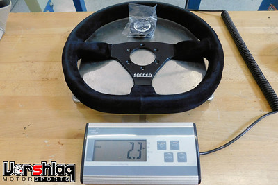

I have been wanting to ditch the stock steering wheel and airbag for some time, and now that there's no more street use it is appropriate to upgrade this. The weights above aren't super high but removing an explosive device from in front of my face is always a win.
For this car I chose a Sparco L360 (Ring) Steering Wheel, which has a black suede cover and comes in 330mm diameter. Sparco's hub adapters are hit or miss and for the E46 I prefer the MOMO 6-bolt Steering wheel hub adapter, part #2012. This allows any 6-bolt 70mm PCD steering wheel to bolt to the E46 steering column AND keep the horn. Even though it doesn't see street use, having a functional horn has kept my cars from being backed into on grid more than once. Keep the horn!
There are airbags in each side door, so those two 1.6 pound "potential bombs" were also removed. I lost some pictures, including getting the 13.3 pound weights of the OEM door panels, with speakers. We were replacing the panels with low profile, thermoplastic formed racing door panels from HARD Motorsport (3.0 pounds each).
Mounting these is done with rivnuts added to the door, then what look like 3D printed plastic stand-offs screwed into those threaded holes. Then the door panels is fitted a bit and bolted in place.
Brad traced the custom mounting panels from the V8 M3 to make another set for the driver's door on this 330. This panel mounts the factory power mirror controls, so those can still work. This bolts in place of the little tweeter speaker.

There is a mount for a pull strap which passes through a slot in the door panel. The passenger door kept the little speaker in place for now, but we might go back and make a blanking plate for that side later. We briefly thought about yanking ALL of the carpet and foam backing, which probably still adds 70 pounds to the car, but I decided to hold back - for now.
FRONT AIR DAM TWEAKS
So last time I pointed out that "anything can be called a canard" since the NASA ST/TT rules do not define what a canard is. So the "tire wall" we built last time, which absolutely does not create downforce, was called a canard... which isn't allowed in TT4. Instead of forcing the issue with a protest against myself at NOLA we looked at this a little harder, Jason and I read the air dam rules and figured we could easily make that taller here and cover up all of the tire wall extension at the somewhat incomplete fender flare. This would have less aero drag and be completely legal. This is what we call a "win-win".
A small bracket was added at the base of the outer edges of the splitter and then a piece of plastic "race roll" was riveted in place, covering the tire wall and looking nothing like a canard. It's all covered up by a 100% legal air dam extension.
I also asked Aaron to trace a line showing the "projected outline" of the legal M3 bumper cover, which the TT4 rules reference 2 times in the aero rule section. This way its easy to see where the 4" splitter extension was measured from.

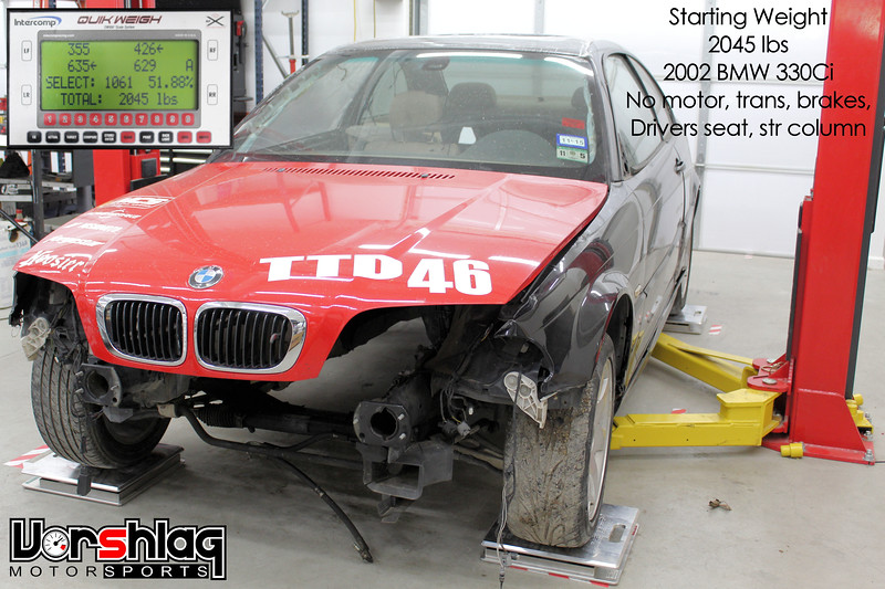

FINAL WEIGH-IN AND LOADING
With 1/2 tank of fuel the car now sits at 2942 pounds (as shown above) and 3154 pounds with driver, gear and helmet. We had the car sitting at 3290 pounds with driver and the same fuel load for the previous NASA event (on a 3285 pound minimum), so the ballast removed from the trunk and the weight savings in the interior lost 136 pounds from our previous TTD setup. Still, we were VERY heavy for TT4 - minimum weight for our current power (210 whp avg) would be 2520 pounds with driver, which we could not hope to get to without MASSIVE amounts of cutting and carbon composites. This meant we were a staggering 634 pounds overweight for TT4 at the next event... not a good deficit to try to overcome. Of course we will be adding power and not trying to find 634 pounds of weight loss for our future TT4 build, so you can also say we were down 90 whp. I felt this deficit was so insurmountable that we'd be lucky to avoid LAST PLACE in class, and we had 5 signed up for NOLA.
Wow, 634 pounds overweight is massive, and as we loaded up and my head hung pretty low. Jon cut some vinyl and replace the "D" letters with "4" numbers. The 2-piece ramps plus the flip down door on the trailer made loading pretty easy, just as long you approach the end of the ramp carefully. Its still easier to load than the TT3 Mustang, that's for sure!
I'm sharing the TT4 classing sheet above with optimistic weight numbers of 2600 pounds - I could have put 2542 minimum, but inflated them a hair for "margin", hehe.... Who cares since the car is 600+ pounds heavier than that! Same goes for power - I claimed 215 whp avg, when its really 210 avg. Not that we will get dyno'd, but I always try to leave some margin for error on the stated numbers.
We also kept the two sets of 17x10" wheels mounted with 245/40/17 Hoosier R7 tires we had leftover from previous events, even though we could have run a 275mm max width tire and more aggressive A7 compound for TT4. I didn't want to blow the $$ on new tires for one event when we were THIS OVERWEIGHT. I thought briefly about running a "slower class" like TTC (we'd still be hundreds of pounds heavy), but I really wanted to run a NASA event against the fastest TT4 cars in our area as-is. And for reasons that would later prove to be true, I feel that the TTC class cars are faster than their TT4 counter parts.

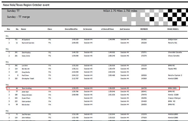

NASA @ NOLA, OCT 27-29, 2017
We have not raced at NOLA Motorsports Park in 4 years, but we had a lot of fun the last time we ran with NASA here. We were eager to get back and Amy and I both planned to drive the 330 this weekend. It was SO MUCH FUN - we are both glad we went and vowed to make at least one NOLA event per year in the future!
We completed this round of "TT4 prep" on Wednesday so we got on the road Thursday morning to make the 512 mile trek from north Dallas down to New Orleans to run at our final NASA weekend of 2017. We spent the entire day driving the 9-1/2 hours through Texas and Louisiana, got caught in some traffic around Baton Rouge, then rolled into NOLA right at dark. We unhooked the trailer, found a parts store to sell us DEF fluid for the diesel truck, went to the hotel, then found a local watering hole to get some good Cajun food.

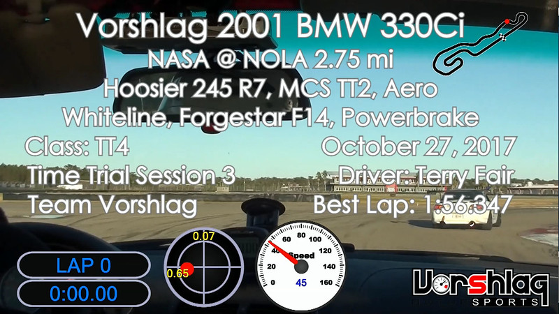

FRIDAY TEST-N-TUNE
Friday was an absolutely beautiful Fall weather day in the deep south. Sunny, light breeze, 70-80°F all day, just perfect. We arrived on time for the 8:30 drivers meeting for the test event we signed up for, where we hoped to re-learn this track we have only raced at once back in 2013. I was startled to see that the TT3 track record we set on the 2.75 mile course 4 years ago still hasn't been toppled (1:50.525), but I figured it would surely fall this weekend (it didn't).
The test day was run by the track itself and cost a whopping $250, which is relatively high for this area (our last test day at MSR-Houston cost $75), but they do put on a good show and the track had nearly every corner station manned. They separated the entrants into 3 groups: W2W Race cars, Advanced + Intermediate HPDE, and Beginner HPDE. Since we don't have a full cage in this car that meant I would go out in the Adv/Int HPDE group. There would be five sessions for each group during the day and I ended up running four of them. There was no riders, coaches, or instructors allowed in the cars, plus Amy could not take a session in my place - $250 per person per day. Bummer, but I would be able to ride along with Amy on Saturday for some coaching.
We unloaded the BMW and set the tire pressures (27 psi cold) on the silver wheel set, which had the older scrubbed set of R7s mounted. We were planning to run this set Friday and switch to the gold wheels (fresher tires) for Sat-Sunday.
It was good to do this test day, being that I hadn't driven this track in 4 years. It slowly came back to me and I was able to adjust my lines to work with this "momentum car" vs the more powerful setup of the Mustang. We stayed with our existing shock settings, and the 6° AoA wing setting felt damn near perfect. We adjusted tire pressures and got them all about 32-33 psi hot, with a 1 psi bias for the fronts. This course is CW so most of the corners are right handers, which meant the right side tires needed higher initial pressures when cold.

We figured out on this Friday test day that the M3 cluster's fuel gauge is "problematic". In my second session the car was fuel starving at "3/4 tank" gauge levels, which I knew was not right. So I went to the fuel pumps and... put nearly 3/4 of tank of fuel in the car? So it was reading high. After I filled it up it showed "Empty", WTF? So now I cannot trust the fuel gauge and we just started filling up after each session. We were using 3.0 gallons per 20 minute session, and I ran every lap of four sessions that day.

We wrapped up the last session and swapped to the gold wheel set (above) to get the car ready for TT on Saturday. Some weather was supposed to move in and drop some wind/cold/rain overnight, but many of the Texas racers were camping out at the track in tents and trailers.
After swapping tires we noticed that they were wearing extremely well. The last set that wore badly was an old set from our TTC Corvette, which had some shoulder wear that was worsened on the 330. Lots of tire klag inside the wheel but otherwise this set is good for more testing. After we had the car prepped for Saturday we went to our hotel, got cleaned up, then met my nephew and niece (who both live in N.O.) at a French restaurant for a great dinner - and I got to meet my grand nephew for the first time. Cute kid.

During that first dry TT session, my times immediately dipped into the high 1:56s, and the third TT session I ran a 1:56.599. And while I was hoping to not finish last, somehow I as shown in 2nd place? I only knew one of the TT4 guys, Dysen Pham (S2000), who is always the fastest TT4 car at NASA Texas events - and he comes to NOLA a lot and is fast here. There were also three BMW M3s in class, including an E36 with an S54 swap that held the track record.
In the 3rd session, "TT session 2", Dysen ran a 1:56.231 time but spun off track, hit some armco, broke his steering rack and had to come in on the flat bed. Since he did spin off track his times would be DSQ'd for that session. I ran a tick slower but the Race Hero readout and NASA results weren't posting right for the rest of the day - due to a wifi issue in the tower. That meant after the 2nd session we were completely in the dark. Frustrating, but I knew my AiM times at least. I figured one of the M3s would swoop in and destroy both of our times at some point.
In the 4th and final TT session I was maybe sitting in 2nd or 3rd, wasn't really sure at that point, but I wanted to try to catch Dysen's time. I was pushing the car VERY hard, driving through the small puddles at the apexes of a few turns, using all the road and even a bit of curbing, but just couldn't find the time. The predictive lap timer showed a 1:55.8 lap more than once but I could never nail it down. I pushed hard for all 6 laps in this final Saturday session and on the VERY LAST LAP TT took all day I managed to get down to what I saw as a 1:56.3 lap on my AiM SOLO. I knew that wasn't faster than Dysen's best lap in his DSQ session - but what about his fastest lap from the previous one?

It was still 47°F in our first session but the wind was down so it wasn't painfully cold. Most importantly the track was completely dry now and times started to drop. I was gridded P5 so I didn't have much traffic to deal with, which was a nice change. I was behind the two fast TTC cars and could keep them in sight. And while they both ultimately ran better times than TT4, you have to remember - TTC allows many things that TT4 does not, and these "dyno reclass" builds are going to be a thing of the past next year as TTC goes away. They have been fast all year, no doubt about it, but we will see if these TTC cars get faster - and by how much - next year when they all move to TT4 or TT5.
That day I ran the first session hard and found a 1:55.975. Dysen's co-drive in the "S3200" (see above) never materialized - they had all sorts of issues on that car - but the owner did enter, ran at least one session, and made some 2:00 laps on street tires. Another M3 came in second but 3 of our entrants from Saturday dropped out, so we only had 3 cars in TT4 with times on the results sheet Sunday (so no Hoosier payouts).
I went out in the next session looking to run a lower 1:55 lap (a predictive 1:55.8 time popped up earlier) and I started getting greedy with the exit "gators" on T16. I would take it wider and wider out of this last turn before the pit straight to try to gain a tenth, but it wasn't working. I ran a string of 1:56.0 laps then I took T16 exit a bit too wide and clipped the tire wall with the side mirror - BANG! Damn thing popped right off the door mount, hanging from the wires, but did zero damage elsewhere on the car. Whew! I got lucky. I held the dangling mirror in my hand for the next lap of shame and came in...
Amy had seen and heard the whole thing from the bleachers at the exit of T16 - and she was none too pleased that I almost joined the "Wall of Champions" that had claimed other cars this weekend. I clipped the mirror wires, tossed the busted mirror into the trailer, then went right back out to take my nephew for a few laps in the next DE session. After that the car was all Amy's, and she did take another session that day, running her best lap of a 2:01.0 before we called it a day.
By this point we had "found the time we were gonna find" and the ambient temps were climbing, while other TT cars slowed down or dropped out due to mechanical issues. One of the remaining TTC S2000s clipped another bit of armco and busted a wheel bearing. Another TTC S2000 broke their trans. Amy had dropped 10 seconds from her Saturday morning times and I found 2 seconds from my best Friday test time. My brush with the tire wall was enough of a warning to "not push my luck", plus we had an 8+ hour tow home and work the next day.
We stuck around to watch the Blitz race group's last points race for the year, where our customer Jamie wrapped up first place the NASA Texas ST3 Championship - in his rookie year - which was pretty cool. He had "hit a gator" during the first race on Saturday and tore up the front end - but still finished the race. A bunch of us patched it up before the next race, which he went on to win and as well as the points race on Sunday (the car is at our shop now getting fixed up, better and prettier than before).
We watched the Race Hero live timing app on our way back to Dallas and the 3rd and 4th TT sessions on Sunday didn't throw us any curve balls, so we won on Sunday as well. With only 3 in class there were not contingency payouts from Hoosier, but just winning the 2 tires Saturday was a nice change. The Sunday win had half the class out, but it was still another win - which meant we went 10 for 10 TT first place finishes this season (8 in TTD and 2 in TT4).

The 330 definitely picked up a good bit of time with the added aero, which makes me think that next year we might be more competitive - with less weight, more tire and a lot more power. We shall see - I'm excited to to find out!

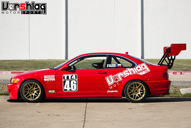

My red 330 "Fireball" coupe (above) went through some cosmetic changes over the 2017 winter. This car won the NASA Texas Regional TTD championship for 2017 (by a huge margin), and we had moved to TT4 late in the season. While paint work was underway last winter, a big batch of rules changes came down that made all of our TT4 prep work illegal. Since I have to change up my personal cars regularly, to be able to develop new parts, the red 330 was sold this past Spring. I already miss that car...
Left: Widebody/carbon door/carbon roof E46 coupe I bought (V8 build). Right: My slick top 2001 330Ci (SE46 build)

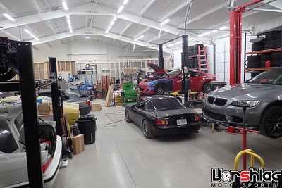

Do not fret - we have a half dozen new E46 chassis coming in for various work, and some of those will be complete race cars we build for future customers. Long ago this forum thread outgrew our initial TTD E46 build (Jack Daniels) and since then we have shown various E46 BMWs that we have built, worked on, or raced. Some new E46s have been purchased this year, including the widebody E46 coupe shown above left, which already has carbon doors + roof and a big set of flares on it already. We have some nasty plans for that, plus other plans fpr the slick top white 330 Coupe, and possibly a Z4 (which has E46 bones) as well.

My hope was to reset our best lap in this car on the 1.7 mile MSR-C CCW course. I had ran a best of a 1:23.789 back in March at the NASA event, in TTD trim, with zero aero. That day had nearly perfect conditions, and I had two days / 8 sessions to set that best lap of the weekend (and set the TTD record). We hadn't run at MSR since March, and never here with the TT4 aero. This is a track that normally responds well to aero downforce so I had high hopes.
I went out early and had a relatively clear track. But it was very windy - and I think that was what was upsetting the car in some corners, badly. There were head winds, tail winds, but mostly cross winds. This made the car a real bear to drive and it felt like the "full tilt aero" wasn't helping me that day. Unpredictable, changed through the corners, etc. Bitterly cold with the winds, too.
I went out in the first session and drove 11 laps, but only ran a best of a 1:24.079. Track temps were good, I wasn't fighting traffic, had no excuses other than the cross winds. The tires were fairly fresh, and I felt like I pushed the car to the limits, but I was just a hair slower than the March times. With the high winds Aero was a detriment that day. Other folks in race cars said the same thing that day. I watched my video and didn't see any major mistakes, just wasn't that fast.
The inside front tire is off the ground here - and there's a lot of bodyroll
There might have been some impact on loading of the chassis from downforce, it just wasn't consistent on each corner, because of wind direction. As you can see above, the inside front tire above was off the ground in Big Bend, possibly due to DF loads. If we had stuck with this car much longer we would need to increase spring rates a good bit. We saw similar amounts of "chassis compression" at NOLA as well, right after adding the aero. Adding wings and splitters usually requires spring rates to go up by 25-50% or more - with dedicated track testing trying new spring rates.

2003 325Ci COUPE AUTOMATIC - ROUND 2 OF REPAIRS
Let's skip over to one of the least impressive E46 cars we have in the fleet - our black 325Ci Daily Driver automatic that my wife has been driving for the last year. ;)
In the last post we showed a lot of suspension, gasket, wheel, battery, and DISA valve repairs on this car. Shortly after getting it back on the road the transmission started slipping. This car has the ZF automatic - which has outrageous rebuild prices ($4000!), which was more than the car was worth. What to do? There were some Check Engine Light (CEL) codes but we couldn't read them with our OBDII scanner.
NEW FLUID AND TRANS FILTER

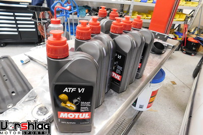

Step one was to try the easy fix - fresh transmission fluid and a transmission filter. Sometimes a bunch of funky fluid and a clogged filter will cause the trans to shift funny.
Brad dropped the pan and drained the fluid. Looked like old fluid, maybe original. Pulled off the older filter and rounded up a new one.
The transmission pan was cleaned, a fresh gasket went on, and the new filter installed. A case of Motul ATF VI synthetic fluid was added, the car started and the fluid level was checked. Time for a test drive.
Still slipping, badly. Hmm, not good. CEL was back, and again we couldn't read them. This isn't really our area of expertise, so we took the car to a friends BMW repair shop nearby. Michael from Eurauto hooked up to his fancy BMW code checking computer. Code 049 and 053 above had to do with the transmission.
After talking to Michael and another BMW repair shop owner, it was time for a transmission replacement. The rebuild costs were sky high - I even called a friend with an Eagle Transmission franchise. There was no affordable way to rebuild this ZF automatic. Repairs that cost more than the car is worth - this is the ugly part of German cars ownership sometimes...
USED TRANSMISSION INSTALL
I started calling around and a correct E46 ZF auto pullout was found from a friend who owned a BMW repair shop. I horse traded some parts for this used trans, shown below. In hindsight maybe we should have done a little more work and converted this car to the 5-speed manual, but such is life...
We cleaned that up (pressure washed), swapped over a wiring harness from our car's trans (that was busted on this unit), and the torque converter as well (our car's looked to be in better shape). Here are the technician notes from MyShopAssist on this work:
MSA: R&R Transmission - Technician: Aaron - Time: 7.23 hours
Filter Swap + R&R Transmission - 11/6/2017
-Change fluid and filter in original trans
-No change, still throwing codes and slipping
-M12-1.75 x 75MM hardware needed (stripped/stuck), Qty:2
-Chase M12x1.75 tapped holes in block
-Power wash replacement pullout trans
-Repair loom on P/N safety switch/gear indicator on pullout trans
-Swap existing convertor into pullout transmission
-Install new transmission mounts
-Snug oil pan bolts (small leak present)
-Rear main seal dry, do not R&R
-Add new filter, pan gasket, fill with fluid, test drive
continued below
Vorshlag-Fair
Official Vendor
Nov 12, 2010
1,592
107
Dallas, TX
Of course nothing is ever easy. Some knuklehead had buggered two holes in the block - probably the shop that did the $800 starter replacement for the previous owner. Since there was still a known oil leak (small), I asked Aaron to check the rear main seal and replace it, if that's where the oil leak was coming from. We had already changed all of the leaky top end engine gaskets in the last round of work. As you can see from his MyShopAssist notes above the rear main was dry - so its gotta be the oil pan gasket. The leak isn't huge, just annoying.
Yet another new trans filter and another case of Motul ATF fluid went into this used transmission.
A new driveshaft bushing (guibo) was installed when the driveshaft went on, and Aaron wrapped up this trans swap. The under tray was cleaned up and reinstalled. Fingers were crossed and I took it for another test drive - which was better, but not 100% better. It still throws some codes but the trans is functional. As long as you don't abuse it, it won't slip. For now.
This is why I hate doing "junkyard swaps" with used parts - its the same work as putting in a new part, but sometimes the replacement used part is not 100% right. This is part of the fun of owning older German cars...

Since the E46 was driving better, I went ahead and asked Brad a couple of days later to do a few clean-up tasks, to make this car look a little nicer. He spent about 3 hours to knock out the following.
The headlights looked great, the leather was conditioned inside, carpets were vacuumed and the car was washed. Amy has been driving the car for the last 11 months. The transmission works, but there are still some other issues with it. It drives fine, and gets her to and from work, which for now is good enough. But we have more work to tackle...

One of my least favorite things on E46 BMWs are the factory cup holders. They suck, and are made for itty bitty cups, or small European soda cans. ;) After time the spring clips that hold the dual cup holder insert into the center console wear out, and the spring loaded tabs inside the cup holders that gently squeeze the tiny little cans wear out. So if you have a teenie tiny can in there, corner hard enough, the can flies out. Or the whole cupholder assembly pops out of the center console, along with whatever was in there. Both situations are irritating.
This car had a very worn out set of cup holders, and they kept falling out when cornering with a drink in place. Not cool. so I ordered a new OEM setup and popped them in place. But it was still pretty much worthless unless you had an 8 oz can or small drink cup.
But to hold American size cups - like this Yeti-ish insulated stainless cup - we needed something bigger.
This "Swigzy" cup holder "extender" works great. The bottom section can fit into the tiny E46 cup holder openings, then you can rotate the upper section and these ribs extend out and lock it into place. The upper portion can hold a giant cup - or your wallet,phone, etc. Very handy.

A few weeks into daily driving Amy ran over a massive pothole and bruised a tire and bent another wheel. It was really a big "heave" in a concrete seam she ran over, but luckily the rest of the new suspension took the hit like a champ.
I ordered two new tires (245/40/17 Firestone Firehawk 200 TW) and had that wheel straightened and refinished.

The "nail in the coffin" to further TT4 prep on this 330 was the significant rules changes that were made to ST4/TT4 at the very end of 2017, after only 1 season of this class being in existence. We will cover what changed, and how it affected our car.
Apparently seeing our car's aero in TT4 prompted some changes to: wing endplate rules, splitter measuring rules, wing placement rules, and more. This was "not what they intended" when they wrote the limited aero rules for TT4. Even if we were deemed legal for the NOLA event, they told us that none of this would be legal for 2018.
We only did what anyone building to the limit of a class would do - built to the extent of the rules. Can we help it if the rules didn't describe what was desired? It's not like we exploited loopholes or poorly written rules. We maximized the splitter, endplates, and wing placement for what was written. They didn't like that. So right away, none of our aero would be legal for 2018. It would all have to be redone, from scratch. After ONE RACE! I was less than thrilled.
The other rule change that caught us out was the "standardized tire measuring tools" introduced for 2018 - a bit of a radical move that caught out a lot of racers. No longer would the tire size stamped on the sidewall matter - you would have to measure your mounted wheel and tires with some standard tire checking tools...
This was done to reign in some tire makers that produced sizes that were wider than the numbers indicated, and to prevent racers from "stretching" a tire on a wider wheel to get more tread on the ground. If you have followed other builds we have done over the years, you might know that I am NOT a fan of skinny tires, but these rules changes were made to "keep costs low" and to prevent racers from using wider tires. The TTD build was always difficult for me, just having to use a 245mm marked tire...
Of course for both our TTC Corvette and the TTD E46 builds we had done BOTH of those things to exploit tire rules: we picked the widest 245mm tire Hoosier makes (the 245/40/17 R7) and put them on 17x10" wheels for this TTD build. And we had just gotten a second set of 17x10" wheels made for the 2018 season, to have a set as "scrubs" and the "stickers" ready for when we needed more performance.
I had planned on stepping up to 275mm tires for 2018, which on paper are "legal" for TT4 - but there's no way to mount them and fit within the class limit 282mm wheel checking tool (I bought a complete set of these tools late in 2017 to figure this out - too late). So I've got sticker 275s that I bought, and a 2nd set of 17x10 wheels for them now. Yay.
So now we had built a car for a class that no longer existed - at least not with any of the mods legal for 2017 done to it. The reasoning was to allow the "Letter" classes to be gone for good in 2017, so the "new for 2017" ST4/TT4 classes needed to line up better with the new for 2018 classes ST5/TT5 as well as and 2019's ST6/TT6 classes.
I get why they made the changes, it just didn't make me very happy to prep for a class late in 2017 and have exactly ONE RACE in this class before major changes came down the pipe. To be TT4 legal we would have to completely remake the end plates, radically alter the wing's fore-aft placement (brand new uprights), the front splitter would have to be completely remade and get much smaller and we would have to get new wheels to make even the 245s legal, forget about the 275mms I bought.
This car was already WAY down on power for TT4 in 2017 (we were even down for TTD), and without a radical M54 engine build I'd still be down on power for 2018 PLUS we would have to make all new aero that would make less downforce. And no additional tire over TTD, and in fact less tire with narrower wheels I'd have to buy. So we would have to spend a lot of time and money to go slower. I already had the car at the painter's while all of these rules changes were coming down, very late in 2017, and I was unsure of what to do...

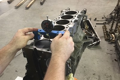

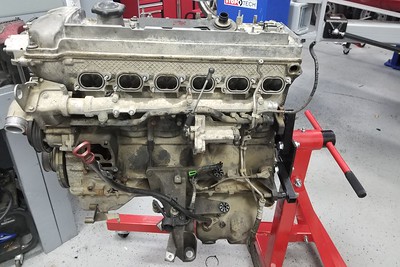

ABORTED M54 AND S54 BUILDS
I had hoped that my partners at the engine shop I am a part of would be more excited about developing BMW M54 or S54 engines - after initially being on board with these plans, I had rounded up heads and engine cores for development work, a complete dry sump oiling system, bought some rods to test with, paid for a test crank to check maximum stroke, paid for some tooling, etc.
There is untapped potential there in the aluminum block M54 (215 hp stock) market. A few overpriced, underwhelming options existed for rebuilding an M54, but most folks just tossed them in the scrap pile and put in junkyard pullouts when they had a problem. We had a test crank made with a different stroke on each cylinder, then a forged aftermarket rod and piston we ordered that we tested in each bore. We had a pretty remarkable stroker combination that we were on the trail of... problem as it was going to be expensive. And the M54 intake, cams, valves, and ports all needed major upgrades to keep up with the added displacement. And the factory EFI was likely unable to support the programming. It was quickly turning into a very pricey unicorn kind of build. Would anyone else ever buy one? All of the development costs were on me.
So I rounded up an S54, above. These have a heavier iron block but the block is taller, so we could add even more displacement. The S54 cylinder head can support more power (333 hp stock), but it would still need porting, valves, cams, and more. I got the dry sump setup for the S54, and we had lofty goals in mind. But my partners were much more interested in working on LS engines, late model Hemi, Viper V10s and Ford V8s. Can't really blame them, though. There is SO much more potential in any of those pushrod V8 engines than any BMW anything... dollar for dollar we could make a LOT more power with an LS V8 than an expensive, high compression, high revving BMW inline 6.
With TT4 now out of sight for my car for 2018, I scrapped both the M54 and S54 stroker engine projects for now.

NEW PAINT FOR 2018 SEASON
After the November track test I was not "feeling it", and 2018 was looking like we might be further off the pace with the revised TT4 class rules, but at least the car would look good! ;)
I always intended for this car to look good - to represent Vorshlag well - but we had thrown a lot of changes at the body in 2017. We now had a raw carbon hood, 4 black flares, a bare aluminum splitter, a raw carbon sunroof, unpainted E46 M3 nose, black plastic race roll air dam and tire fairings, and raw carbon wing with bare aluminum endplates and uprights. It was time to get everything painted or coated.
I found these E36 M3 style side mirrors that fit an E46, purchased those. The plan was to replace the OEM units after I had popped off the driver's mirror when I touched the wall at NOLA. Bonus: the two mirrors dropped 3.4 pounds from the stock power mirrors, and they produce considerably less drag.
The new mirrors worked out well, but the eBay quality showed when it came to mounting. A bit of work was needed to install them (one of the mounting holes wasn't there), and of course we lost the remote power mirror adjustment. One of the front lower control arms was knocking again, so a Lemforder replacement was ordered and installed, too.
We were not expecting the major aero/rules changes, so the car was already torn apart and being painted when the rules changes came down very late in 2017. Normally we'd try to make the late January 2018 event that kicks off the NASA Texas calendar each year, but with the new rules making all of our aero work illegal for TT4, I told Heritage Collision to not hurry the paint work.
When I picked the car up in early February 2018 the paint made the car look AMAZING in every way. I was still unsure of what to do with the car, but at this point I had to do something since we had invested so much into it at this point. TT4 was out, and a build for TT1/2/3 would take even more radical aero and likely (if I was smart) an LS V8 swap.
While I was deciding what to do with the 330, I had the guys clean up the tubular bumper beam/splitter strut mount and shoot it with silver paint, then reinstall that.
We had the entire front splitter powder coated in semi-gloss black. Much stronger than paint so they don't look like hammered crap after every event's worth of tire klag and bug hits on the leading edges.
By this point I knew this car was looking very good, and I had Jon make me a "FOR SALE" graphic for the windshield. I figured I'd take it to some event soon and somebody would see it and maybe want to buy it? My intuition has been wrong before, but I figured it couldn't hurt.
The endplates were already painted and the wing uprights and splitter were already powder coated when the rules changes were announced, so to change them now would cost not only the additional labor to re-make them but I would lose out on the powder coating and painting costs as well.
We even had Heritage paint the raw carbon fiber wing, and with the painted aluminum endplates and black uprights the back of the car was looking just as good as the front.

By now I knew the car was looking pretty good, and selling this would help pay for the new car I just bought and the building that was under construction...
At this point we left the decals on the panels that weren't painted - the doors and fenders. Everything else got painted in matching Hellrot Red - the nose, hood, mirrors, sunroof panel, wing, endplates, and flares.
I was wondering if someone would buy this as a dedicated HPDE car that they could maybe drive a little on the street (the aero is the main factor here). I knew from previous builds that keeping the A/C, roll up windows, lights/signals, and some of the interior wasn't hurting us as far as potential buyers were concerned.
Seeing this was making me have second thoughts... the paint popped, the interior looked great, but I kept saying to myself - how does a super clean dual-purpose car help us further the business? I couldn't find a class that it fit into without major changes and compromises. I was stuck.
The interior cleaned up nicely, as you can see. The front carpets were vacuumed, the seats spiffed up, and it all looked great.
Painting carbon wings body color is kind of a new thing, and after seeing what it looked like on our car, it's my new thing! Tired of seeing raw carbon blister or get cloudy from UV damage? Painting the carbon cures all of that.
After a couple of days of waxing, cleaning, polishing, and even detailing the engine bay, Brad took the time to shoot some really good pics of the car. I was thinking of where to list it for sale at this point. Bring a Trailer? eBay? HPDE Facebook groups?

In early November 2017 a buddy called and said he knew of a widebody E46 coupe for sale. It supposedly had a full Flossman body kit installed, like the one shown below. It also had ultra-light carbon doors, a carbon roof panel, and came with an E46 M3 rear subframe. This is what this body kit looks like, when done right:
This is NOT the car I purchased, but rather a good example of what this body kit looks like on an E46 Coupe
That could hold some serious tire. So I went to go see it. It was buried in a storage unit under a mountain of parts. That made it hard to see all of the details, but the price seemed appropriate for what it had. I could tell the front nose needed a lot of work, and the floor had been modified for a side exhaust (not my favorite mod), but it looked like it was all there.
Once I had picked up the rolling chassis I could see it had some work that needed to be re-done. Super tall tires from a 5 series were rubbing the "undertray" (which we will cut off and replace with a splitter), so it was hard to steer. But it does have the real carbon doors, and some good bodywork on the flare install. Probably going to have to swap in the floor from a donor car to fix the side exhaust stuff, oh well.
Yes, it looks very ugly in its natural multi-color paint right now, and sits up like a 4x4, but I have a vision! ;) The carbon roof panel wasn't installed completely and needed some help to go on all the way, but this post is running long so I will show that work next time. Everyone else at Vorshlag thinks I am crazy for buying this one, but my plan is simple: perform an LS swap, add MCS coilovers, 315 mm Hoosiers, cage it, add some aero, and put this one up for sale when its wrapping up.

We made sure to carefully remove anything we might want to keep, re-use, or resell. I weighed everything that we had not weighed in an E46 build before, especially anything that might go back into this car. The giant HVAC box is a challenge to remove - it is bolted in from the firewall side, behind a couple of plastic panels. The entire dash has to be removed to pull it out, from the cabin side. Not an easily serviced part - thanks BMW!
We will replace it with a lightweight motorsports heater core + blower motor, with a metal firewall panel in place of the giant hole there.
The dash pad took some time to extract, but it came out cleanly, as did the dash bar structure behind it. We will likely re-use part of the dash pad, with all of the HVAC ducting removed. And we may or may not use the dash bar (if we do it will be incorporated into the cage). One thing I am insisting on is a clean, professional looking car, inside and out. A complete dash, even just the shell, makes a huge difference in how the interior looks - as well as reduces glare for the driver. We all want a good looking car - no "born to lose" jankiness that rolled out of the junkyard (even if this was a $100 scrap chassis and is being built affordably).
The interior bits and extraneous wiring FILLED the dumpster
I hauled the Dumpster over next to the shop door with the tractor, to make loading the funky interior bits easy. #TractorTherapy
Engine bay was cleared out, but there wasn't much in there to begin with. I donated an entire E46 M3 rear subframe, one of my 210mm E46 M3 differentials (LSD 3.62 geared), some leftover prototype E46 long tube headers, and a couple of Magnaflow 3" mufflers leftover from a job we didn't need them for.
I've also got a set of 17x10" wheels from the red car, this gold set I used exactly ONCE. The buyer of the red 330 car wanted the silver wheels, and these only fit a non-M E46 with flares - so they haven't been easy to sell. We will likely use another set of HARD Motorsport flares, since we have installed those several times and know the tricks. Price is right, too.
At the end of about 3 hours of work we had the car 376 pounds lighter, with the carpet, rear seats, passenger seat, and the chassis wiring removed. We will likely NOT use any of the old BMW wiring, but I kept the harness for spare plugs and such we might need on other builds. The 1669 pound rolling chassis still has the driver's side door glass, window motors, both doors to gut, and some rear shelf bits to remove. Lots to go back in, of course. We need to pick the drivetrain, but knowing me it will likely be a rotary, with turbos.

FLOOR PANEL PREP FOR CAGE INSTALL
We already removed all of the carpets, dash, door panels and other useless interior bits in the first week of work back in April 2019.
What we were left with inside was a LOT of floor pan sheet metal covered in this adhesive sound deadening material, which I will refer to henceforth as "tar paper". Its really more complex than that, but tar paper is easier to write. We would fight getting this heavy, sticky, brittle crap out of the BMW for weeks, employing a number of removal techniques. Some here have even called it the Tar Paper Wars. One technique worked better than others...
DRY ICE SLURRY METHOD on EVO X
We did a cage job back in early 2018 on this EVO X, which had a welded 4-point roll bar we had to cut out and got a proper 6 point roll cage installed in it's place. This car still had all of the tar paper installed, which we had to remove since the entire interior and cage would later be painted grey.
The method we used to remove this tar paper was suggested by one of our fab guys at the time, Aaron, who had used it successfully on Japanese cars before. The idea is the dry ice gets the adhesive holding the tar paper to the sheet metal so cold that the adhesive breaks loose, and then the tar paper comes off in whole sheets! I wanted to see this witchcraft in person, so we gave it a go on the EVO.
With a 5 gallon bucket filled with crushed dry ice, isopropyl alcohol was added to make a chunky slurry that looked like a witches caldron. This slurry was carefully poured onto the top of the tar paper (the flat portions), then was allowed to sit and chill a bit, then light percussion with a hammer or scraper was used...
It was like magic. This stuff just popped out in whole sheets! I never would have believed it, but damn, the results were real. In this EVO. This one time...
DRY ICE SLURRY METHOD on BMW?
We had high hopes and bought two 8 pound blocks of dry ice and a butt load of isopropyl alcohol to try this again on our E46 BMW's floors.
At first we tried a twist - putting the dry ice + alcohol slurry into a black trash bag, that could let us re-use the stuff in several sections, as well as the vertical paper applied at the front firewall, transmission tunnel, and back seat shelf around the fuel tank.
Well we gave up quickly on the trash bag, as it did not work at all. We went to straight dry ice + alcohol applied directly to the tar paper, as we did on the EVO. Problem was it was not working well on this car. Not at all.
We tried this method again another work night, with two more blocks of ice and more alcohol. And more "percussive" persuasion. After many hours over two work nights, $100 worth of dry ice and alcohol, we barely had the passenger and driver seat flat floor sections done, and it looks like a 12 year old's patchy beard. This just did not work on this BMW, maybe due to more advanced age or possibly different tar/adhesive materials the Germans used? I give this a solid FAIL rating.
I can NOT recommend this method to be used on a BMW. Not to mention that the alcohol poured out of the many plugged drain holes in the floor and trashed my new polished & coated concrete floors. I was less than happy about this - the alcohol/dry ice method is now banned in my shop.
"GIVE ME SOME HEAT" METHOD
We were still fighting this battle weeks later, and on the 3rd work night attempt to remove the tar paper, I insisted on trying my old proven method that we have used on dozens of BMWs in the past - a heat gun + scraper.
This worked so much better on this car. With heat applied to a small section of tar paper for a number of seconds, a 1.5" wide putty knife was used as a scraper, and this stuff peeled right off. Not in entire sheets like on the EVO, but in manageable chunks and in a timely manner.
The work went much faster than the dry ice, and no hammering was involved, just gentle scraping. It was like peeling fondant frosting off a wedding cake... came off in long chunks, after the heat nuked the adhesive.
The video above shows this heat technique used on some vertical sections of the transmission tunnel - which would be nearly impossible to do with dry ice, even if it even worked. Like all methods, this still leaves an adhesive residue behind, which we cleaned up on other work nights.
Tim tried a number of adhesive removers, from Acetone, to Goof Off Pro Strength, Brake Parts Cleaner, and finally Mineral Spirits/Paint Thinner. The Goof Off worked well enough, but its $15/gallon. The cheaper $7/gallon Mineral Spirits / Paint Thinner worked the best - just apply liberally to a blue shop paper towel, wipe it onto the adhesive, use some elbow grease, and the brown stuff comes off. Sometimes it took some work with a red ScotchBrite pad soaked in the same stuff as well.
I wouldn't call this adhesive removal step "easy" by any stretch of the imagination - its not a "spray on / wipe off" kind of effort. You gotta get in there, use some pressure, and a lot of heavy duty paper towels and a little ScotchBrite to get it off. Just takes time.
And sure, we could have used some power tools and abrasive discs or wire wheels, but that would have made a giant mess and we would have to prime the floors to prevent them from rusting before the interior is painted (after the cage is installed). I have heard from others that blasting or sanding this stuff only turns it into a fine mist of tar, which re-applies itself to the floorpan and other areas. As well as all over you and your shop. This heated peel + paint thinner method keeps the stock paint/primer clean and intact on the inside. We will just remove the paint near the "mounting feet" of the roll cage.

There are two "cavities" at the back of the engine bay, made with some sheet metal structures, that seal two the underside of the hood of a BMW E46. These are made to house the brake booster + master cylinder + main power circuits/relays on one side and the ABS system (or sometimes a battery on diesels) on the other side. The bits inside can be switched left to right for different markets, depending on which side the steering wheel is on.
Well we plan on re-wiring the whole car, and the ABS pump and computer will not be in the OEM locations, so we can get rid of the sheet metal structure on both sides. A few minutes with a Saws-All took care of the bulk of the work.
The rest was removed more carefully with a cut off wheel and even a spot weld cutter. The structure shown here on the left (driver's) side of the engine bay was more completely removed, as it makes room for the exhaust on the engine we have planned.
You can see initial work on the "spot weld removal" above at left. The additional structure these pieces provide is negligible when you have a caged race car. Also, about 80% of the the "rear deck" structure (which the back seat uprights connect to) was removed, which was a little over 12 pound when we weighed it. Some classes don't let you remove that type of structure, but all the classes we plan to run will.

We have researched, ordered and fitted some big flares, which will work with a wide tire package. We also developed a custom big brake kit (which will test on this car), that fits inside 17" diameter wheels. And of course the engine and transmission have been picked. Yep, swapping in a Mazda Miata 1.6L with a super charger! #ThisIsAnotherLie

2003 BMW 325Ci SOLD
I bought this clean E46 coupe automatic from a customer in May 2017 - a car we had worked on for him in the past, but when we moved our shop he started going elsewhere for repairs.
After a few "random" repair shops milked a lot of repair jobs from him over a few years, it got too expensive to drive and for him to maintain in a perfectly functional, super clean form. This is the fate of many E46 models in 2019 - they have aged a bit now, can become plagued with electrical and sensor issues, inevitably they get some problem that throws a CEL (Check Engine Light), and other lights on the dash start to freak people out.
This car was handed down to one of his college age kids, which did the 325 no favors. It got a bent wheel and delayed maintenance until it just stopped running at one point. I bought it for a good price but if you read the extensive repairs we have detailed here you know I had a lot of time and money in this car. All of the suspension, lots of underhood repairs, the tires and brakes, interior updates, swapped the transmission, etc. It had a CEL that we kept chasing, and I finally threw my hands up.
This car was never going to be a good candidate for a race car build, as it was a 325 with a slush box. The AC worked but with a CEL it was virtually unsellable. We cleaned it up extremely well, posted some really nice pics and details on Craigsligt then FB Marketplace... all we got was tire kickers and trash pickers. $1000 and $1500 offers, sight unseen - we never even had one person show up to look at and drive it. Sad.
The car was super clean, and drives great. One of my employees needed a daily so I sold it to him cheap, and lost a bundle on this. But my wife drove it for about a year, so I have to just look at that as "the cost of driving a car". Moral of the story here is: don't buy that "cheap E46" you see for sale, thinking you can fix it up and flip it. This was a 100% Texas car (rust free), straight, super clean inside and out, had D-Force 17x8.5" wheels plus great tires... but with 151K miles and a CEL it was hard to sell. It was sold for half what I had in it. Lesson learned.
E46 BLOWER MOTOR REPAIR
Of course this car's HVAC blower motor quit working almost immediately after he bought it, so we fixed that on my dime. Blower motor & blower resister are both a "high failure item". There are detailed links below on both tasks:
Since I was already selling the car at a loss, we tried the less expensive part that potentially had more labor hours first - the resistor.
You can access this behind the glove box, and this trick saved some Brad a lot of time on this task. After about 90 minutes the resistor was replaced and immediately started to work, and has worked ever since.
continued below
