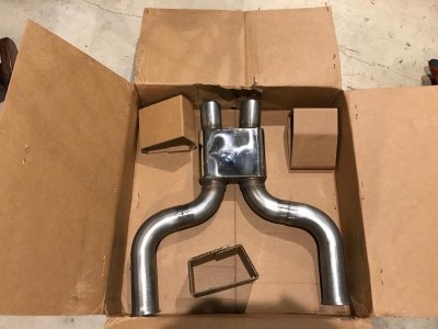

Just received my 3” prochamber from UPS yesterday, should have it put on Friday morning.
jsquared_25
Feb 3, 2010
119
Orange,Tx
Im pretty sure because of their quality issues you don’t hear a lot about them any more. Once I realized they made the prochamber in 3”, I had to get one.
