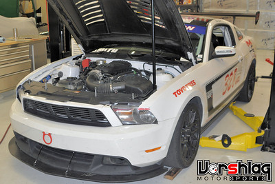

This week at Vorshlag we're working on the current NASA AI/ECR record holder's S197 in our shop right now, Mark Smith's Boss 302-S. We've already found several things to improve, repair, update, and make lighter. The exhaust on his S was almost bone stock (stock manifolds, cat-delete center section, with GT500 mufflers) so we're making a custom X-style lightweight exhaust system now, as well as doing some other upgrades. This system will be tucked into the tunnel and dump right at the rear axle, likely saving 35+ pounds over the OEM bits. Once we get the exhaust finished (later today) I'll show the exact weight lost then we'll shoot a little video of the car, with some sound numbers.
One of the many unique parts we've seen on this 302-S was the carbon fiber front backing plates with an integral 4" duct. These are quite a bit larger than the 3" ducting/hoses we run on our car and might be worth upgrading to for S197s that see extreme brake abuse.

Those are stainless 3" Magnaflow race mufflers and 316L mandrel bent tubing sections TIG welded together. Ryan is doing the final welding this morning and then we'll fire it up and see how it sounds. I doubt it will make 93 dB requirements, but who knows?
Mark's 302-S was the quietest car in the CMC/AI race group before, but it won't be for long. :evil:

Finished the custom exhaust on Mark's Boss 302-S. This system knocked 46 pounds out of the race car (+ another 30 pounds in the light battery install).
I'm guessing that is going to be super loud and raspy as hell. I don't see any way those 3" resonators are going to do enough for you. It looks cool and seems well built but I would bet you guys will add another muffler.
click above for sound test video
Made a peak of 95 dB in two drive-by tests at 50'.

I don't know about anyone else but I think it sounds great.....

Wow, I was wrong, it sounds great. Nice job!
