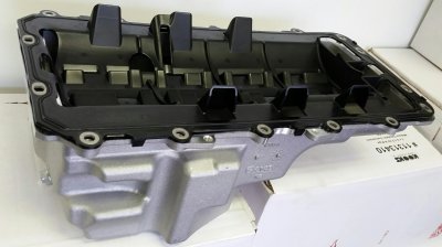

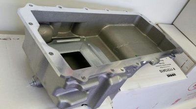

I used a 2013 GT500 5.8 liter oil pan, pickup, and windage tray/scraper. AFAIK the cast aluminum pans were only used on 2013 and 14.
The pan fit with a stock k member. It was a little tight getting the motor in but it fit and once it was in the clearance was just like stock. I've had a non lowering BMR k member before and can confidently say that it would of made the motor install much easier with the GT500 oil pan.

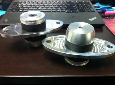

Use Prothane mounts and have them shaved down. I've gone -3/4" and at that point the oil pan was just hovering over the steering rack. It wasn't going much more than that. The Kooks headers still cleared the oil pan.

Thanks for the info guys. When shaving down the Prothane mounts, did you keep the bullet shape. I have access to a machine shop, so I can do this at any contour needed. I'm planning to go 1/2" lower, so it will be a little less extreme than the 3/4" DOB was going.
I'll see if I can locate the cast Al pan. The additional volume plus my oil cooler should keep things in check in the oiling arena... which brings up my next question...

GT500 aluminum oil pan and gasket/windage tray

Prothane engine mounts shaved 1/2"

Btw, here's how the 1/2" shaved Prothane Bullet mounts came out. It's a shame they have to be buried down in the engine bay.

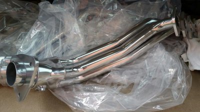

Two unforeseen improvements have made their way into my winter rebuild.
Dropped the headers off at Jet Hot to be ceramic coated. They are less than 30 minutes from my house. I'm going with the polished stainless look so the headers will be easier to wipe down. Only $220, which I think is a steal!

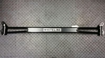

Also picked up a Whiteline strut tower brace from a super nice S197 forum member. Dropped it off at Pro Dyno when I picked up the headers. I know that's the epitome of lazy not to install my own STB, but when I get my car back, I just want to drive it.

Picked up the headers from Jet Hot. Hard to believe they are the same headers that have 10's of thousands of miles on them. They're like new, but better with the ceramic coating inside and out. Running them to my builder on Saturday.

You may need to adjust the height of that Whiteline strut bar. There are eccentric bolts on either end.

I'll play with it if I need to. Motor will be dropped 1/2", so I'm hoping the C&L intake will clear. The adjustable height of the Whiteline STB is one of the main reasons I jumped on it. If I've got room to spare I'll snug it down and keep it tight to the intake. Plenty of room under the Keenan 3" cowl hood, so no issue there.

I think I had it adjusted in the lowest setting, since I had a stock Coyote intake (the lowest of all factory intakes). Basically, loosen the jam nuts on the back of the bar, and then use an Allen key to turn the eccentric bolts a bit to "raise" the bar up. Then tighten back down the jam nuts afterwards. I believe this works best if it's off the car when you do this, but I can't remember for sure. I couldn't find the instructions. :-/

First, the Whiteline STB.

Thanks to some good advise, the 2013 GT500 oil pan with windage tray / gasket and an 8 quart capacity.

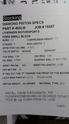

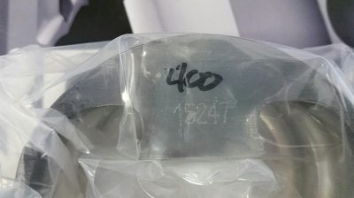

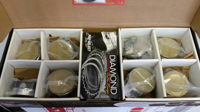

After screwing me royally by providing the wrong size pistons (stock bore vs. the 0.030 over they were labeled and specified as), Diamond is providing the pistons. They were kind enough to give me $0 off for their mistake that claimed my engine. On the flipside, Livernois gave me a 5% discount just because the first set passed through their hands.
They have been measured, and the system has been balanced. Pistons weights range from 398 grams to 401 grams.
