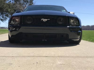

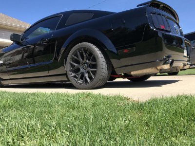

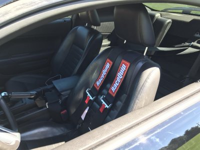

So, it's been a while since this thread was updated. I can rightfully say that the swap was not as easy and fool proof as I thought it was going to be. With that being said, the car has under-gone a few changes.
For starters, I went simple. In the few events I got to run last year through the hectic schedule, I spend more time sliding in the factor seat and seatbelt than I did actually driving. I decided to order and install a SFI approved 5pt harness and have full intentions of ordering a FIA approved racing seat later in the spring.
Next step was to try and control the massive amount of body roll. For this, I looked to my trusty BMR catalog. I called up and I ordered a front and rear package. Adjustable 35mm front, and non adjustable 22mm with their massive end links. I almost didn't want to toss these things under the car they are so sexy.
Last thing I ordered and installed during the off season was a set of coil overs. I settled on a set of BC Racing Coil Overs. I ordered a set of BR Type, linear valving, 400lb front springs, 280lb rear springs. Tied it all together with a alignment following Sky Renders alignment specs (just with a little less camber at 1.5*).
First points event of the year is on the 23rd. So far the car feels amazing. I am really looking forward to getting the car on track and getting to really dial the car in.

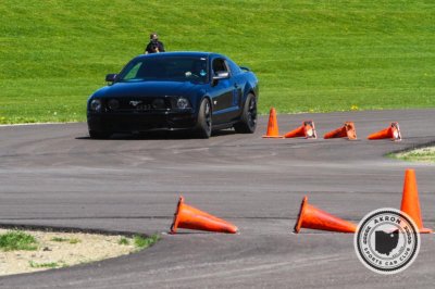

Post Track-Day Update;
Going on a week after my first AX event.
Things that went great; The car did what I thought was great. It was far more settled in the corners than before. Felt way more stable. Braking felt great (compared to stock pads and rotors). I was amazed at how much a harness helped keep me stable (a seat would be the next step, but it will wait). Most importantly, the club that ran the event was awesome, everyone was more than willing to share tips to the new guys, it was well run, and I had a blast.
Things that went not so great; Most easily put, my lack of seat time. I did one half-assed AX event last year. And this was far from what I ran last year. I never realized how poor of a driver I was until Sunday rolled around. The average lap time was about 94 seconds on a 1.05 mile track. And my quickest lap was a 94.122 and average was a 94.321. I came in 11th out of 30 in the "Rookie Heat" and was about .200 off being top 10.
I feel like the car has a lot quicker times in it. I just need the driver to be able to drive.
