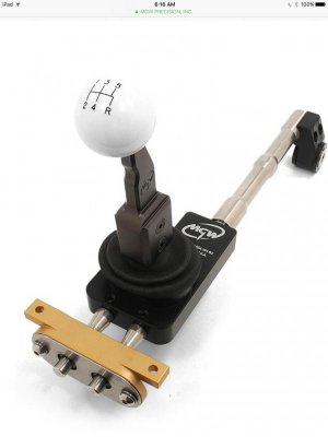

Wait, does the MGW "flat stick" one use a bolt on stick similar to what the Hurst uses? If not, that's not the same as what I'm talking about.
Mustang dog
Apr 24, 2016
172
19
Here's a pic from the mgw site,

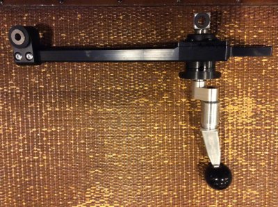

I just received both today. I like the look of the barton, however I'm pretty sure I'm going with the MGW.
MGW is 400grams heavier...
I think the weight difference gives the shifter all kinds of density and not be prone to vibrations.
Both look incredible, just my opinion, one might say to go with the lighter shifter for weight savings... :) no disrespect to Barton at all. Just my 2cents
Btw, I ordered both shifters to have the white shifter ball, and Barton sent black. No biggie just why two different colors
Not sure why these pics loaded upside down, they don'tlook like this on my iPad
