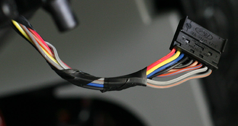

Here is a couple wiring diagrams I made to show you how to hook up the cruise control button on the steering wheel to be used to activate the line locks. One is for dedicating the CC button to just work the line lock solenoid and the other one is a diagram to be able to switch between using the CC switch for line lock activation or cruise control.

does this enable you to use the on/off switch on the left hand side of the steering wheel or the right side which has the set button & increase & decrease speed button

on/off switch on the left side

Is it me or is there no tan/orange stripe wire in the steering collumn harness. I cut the only wire similiar and it wasnt it.

I know this is an old thread,but I wanted to thank KIMMER for the original post. Even though I don't have my 2012 yet it allowed me to build the relay panel and install once it gets here. The only thing that may be different is the color of the wire going to the steering wheel switch for 2012......................THANKS.........TC
