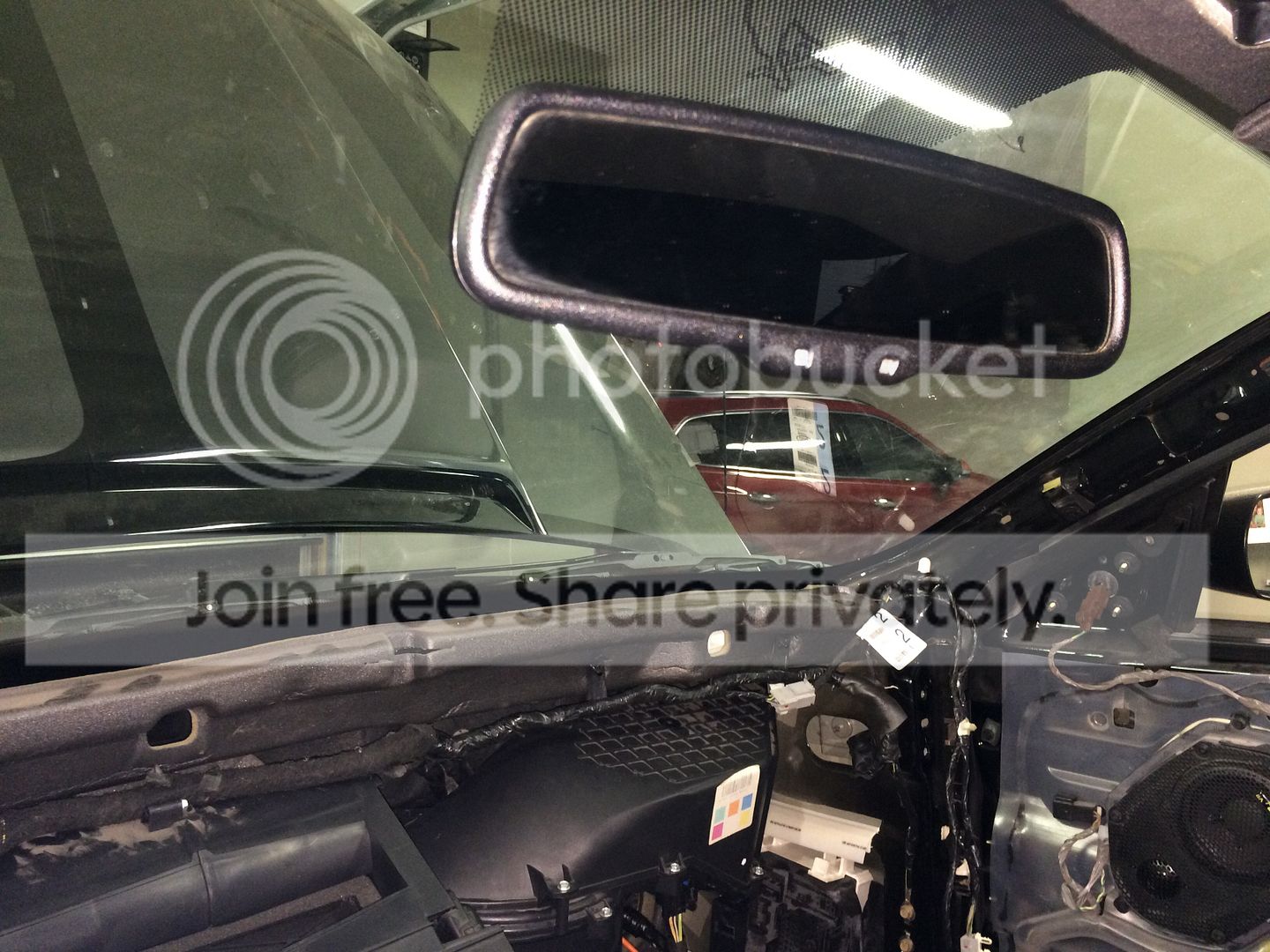

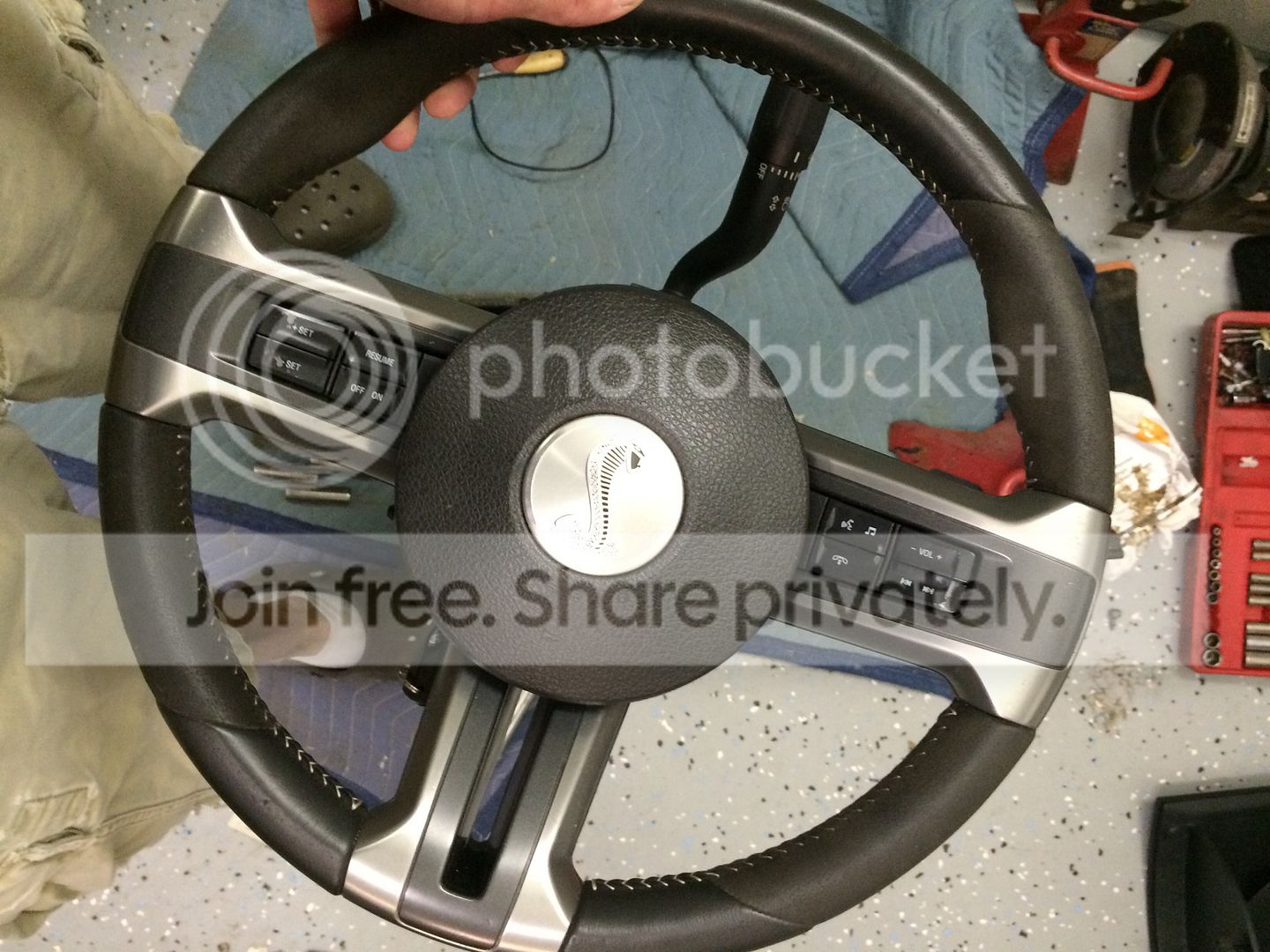

Right I got a lot of little things done
2011 gas pedal, mirror, fuel pumps, and then cut and solder all the old connectors to the new harness. Still need to do tailights. Getting closer still new ac heat box and then install dash but getting closer

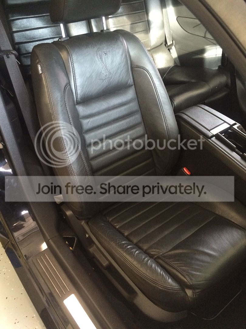

Got a lot of more little details done.
Headlights are done
Tailights are wired just need to run a few more tests on them to make sure they are correct
Almost all the interior is back in. Need to get a ac line and 02 sensors then I can fire it up

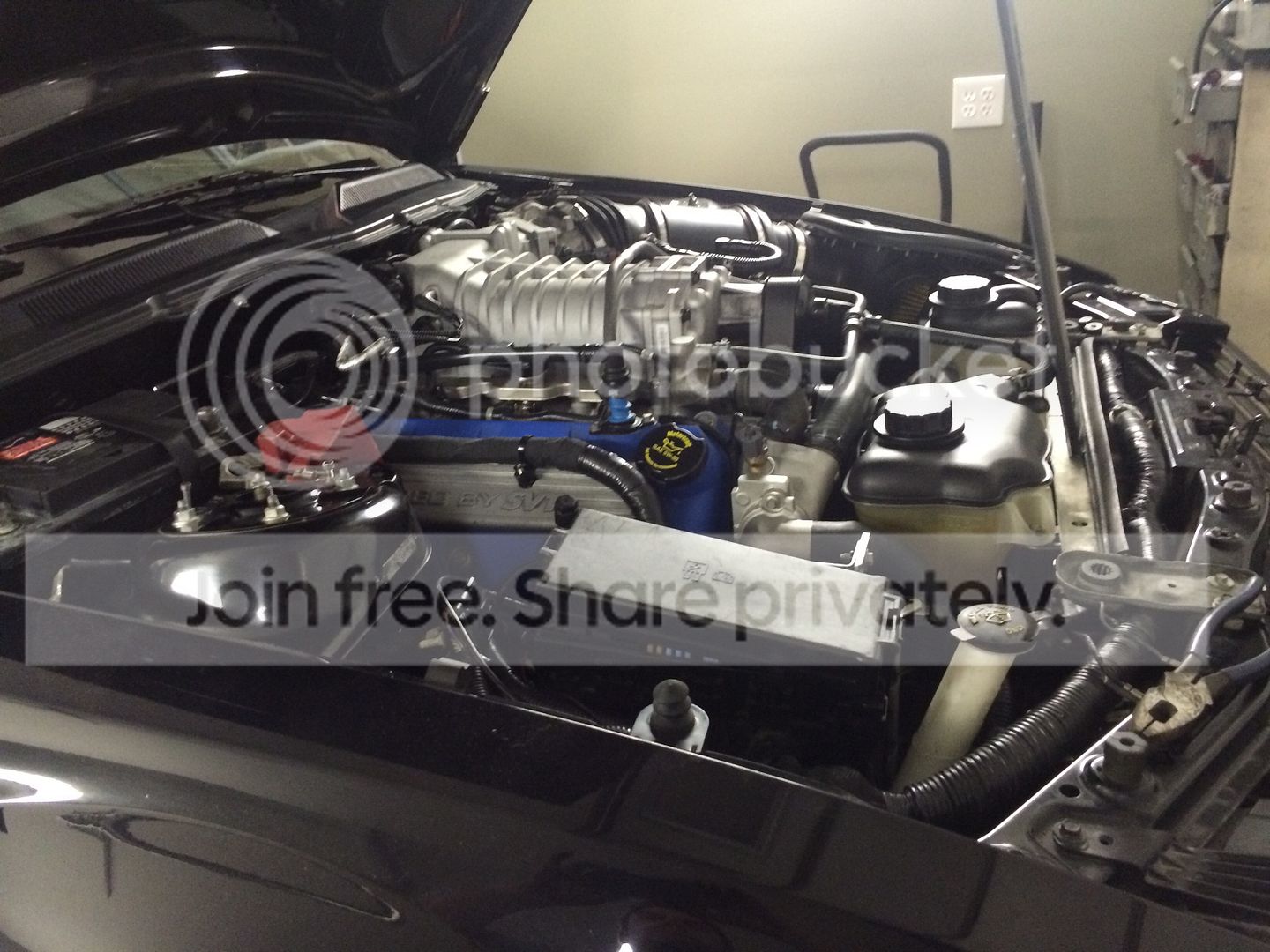

I bought a 14 snake bite ported blower with the front snot cooled it's a stage 7 with the ported inlet spacer and throttle body also ported it made 753 on Lunds base tune. Also got the Jlt cold air
Should make this car a really wake up

Thanks here's the dyno sheet on the start up. I should be close his was stock
Jkoogler
Nov 14, 2014
265
Getting closer
Also bought both the tanks he had for sale. I'm planning o firing up next week!!
