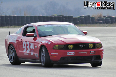

So I guess we will start racing it again, while keeping it for sale. Racing in NASA TT3 is what it was made for. In 2015 both the USCA and SCCA CAM classes banned virtually all aero (more on that below), so it cannot compete in those "unlimited" series without changes now. But I suspect it could still tear up TT3 class - so it will see some NASA events again this year.
The number of cars I currently own (above) now borders on ridiculous, so the Mustang won't be the primary race car - but it will get raced. Amy is going to run it at upcoming local Goodguys (AAS), USCA (GT) and SCCA (CP) events, and we're both driving it at COTA this weekend, with a few changes (mainly just removing the wing).

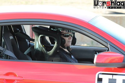

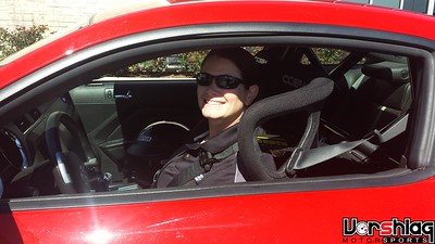

Look for this car at the 2nd USCA round for 2015 - with Amy driving!
Its a shame that we let it sit out of NASA events since June of last year, but we thought it was sold back then. And while I'm not going to try to preserve some perfect paint job, we will get a clear film paint protectant added to key areas. This Mustang has been a LOT of fun to build and race, but selling it has been a real head scratcher (it is still listed for sale here). I'm just not willing to give it away for pennies on the dollar.

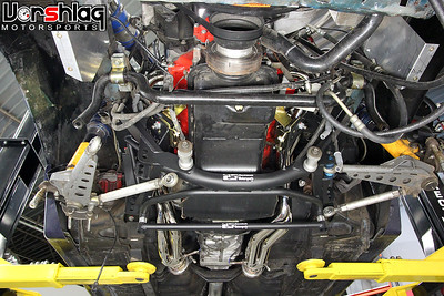

Building the cage on the 1992 Corvette this week required cutting the roof off - temporarily
For as stock as the C4 was at the January NASA event, it was still very fun to drive. We've been working on it again this past couple of weeks, with Ryan finishing the cage (above) and doing some other tweaks in time for the next NASA event at MSR-Cresson March 14-15. And to make my "Mustang treason" even worse - we're preparing Mark Council's track-oriented C5 Corvette (below) and I'm racing it at the Texas round of USCA events at the end of March. Like they say - if you can't beat em, join em! :D
Mark's 2002 Corvette is has a lot of upgrades - and we're taking it a step further this month
Last but not least, we have a brand new Vorshlag project that just kicked off this past weekend -our "Team Vorshlag" endurance BMW build, Project VorshlaggenWagen. This '99 E46 328i is going to be a race car that everyone that works at Vorshlag builds, drives and crews. We'll be covering this build on various forums (listed at this link) and running it in NASA GTS2, WRL GP2, and some other wheel to wheel classes and series.
Since these pictures were taken we have removed 435 pounds from this car - in two hours (much of the interior)

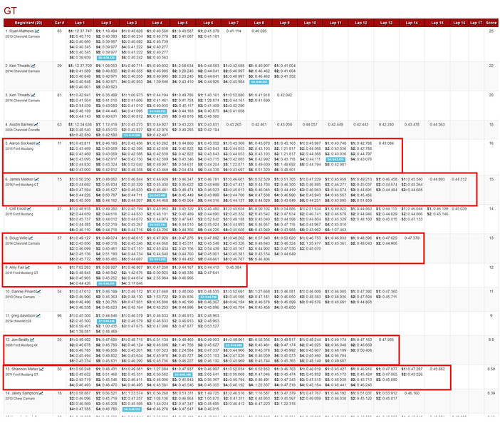

Yes, We are Running Optima Series Again + 2015 USCA Rules Changes
So I've had some time to cool off after our rather frustrating experience at the big Optima event in Vegas last November. Sure, there were some big mistakes made but they have gone to great lengths to fix them. The biggest issue I had were timing and scoring problems, but the report for many racers that ran the first 2015 USCA event at Thunderhill was very, very good. Timers worked flawlessly, they posted times after every run, and had printed times posted at the end of each day. They even had the official, final results posted online within minutes of the trophy presentation. Huge, huge improvements here and in other aspects.
I've also spoken with several folks from USCA and Optima about the Vegas issues and they took our feedback well, even when I was being an ass. They obviously have infinite patience to take my kind of feedback, heh. So I'm going to give them another shot by entering the March USCA/Optima event here in Texas. And to help them gain some exposure for the Optima series in front of a bunch of race fans, I'm going to drive our Mustang at COTA this weekend during the Pirelli World Challenge race weekend, taking VIPs around for laps on the F1 circuit between race sessions. We leave today (Thursday March 5th) for Austin and the guys are finishing the prep on the red Mustang now - should be fun!

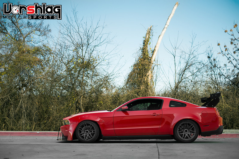

As for our 2011 Mustang GT, once the rear wing is removed it really does look like more of a street car - which it still is. It has a full interior, Air Con, sat nav, stereo, 8 airbags, and all of the factory interior panels and carpet. Sure, we're giving up some weight to more purpose built Optima cars, but that's OK. Sure, some folks with dedicated W2W race cars sometimes "drive on them the street", too, but there are limits. And some folks show up with gutted interiors to USCA events - and they get punished in the "scored" design and engineering segment. There are points automatically deducted for missing side windows, missing carpet, missing radio, etc. And they say they are not going to let some of the troll-ish street car aspects slide like last year - such as plugging a jam box into the dash and calling it "your radio" or sticking some floor mats in and calling it your "carpeted interior".

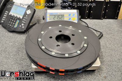

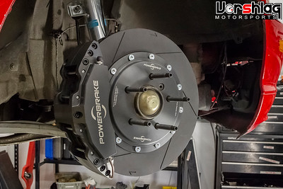

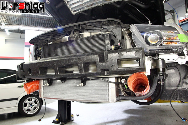

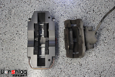

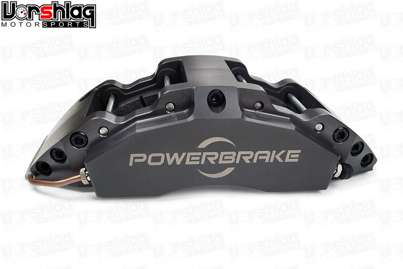

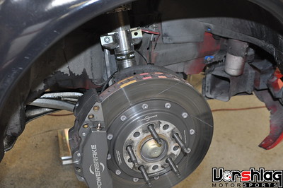

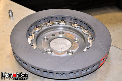

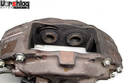

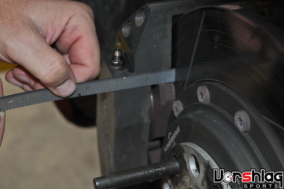

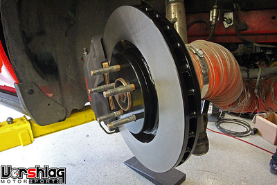

The brakes have been upgraded to slow this big car down, with our GT500 14" rear rotor upgrade, Carbotech pads at both ends, our 4" oval ducted front backing plates, and custom 4" front inlets hidden behind the Roush lower grill.

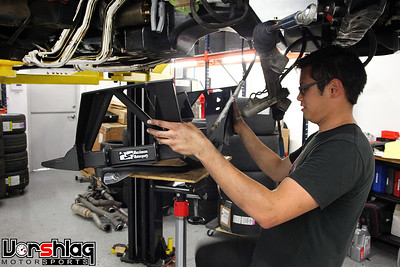

It is explained better in the video above, but basically we made something like our 3" dia front inlets ducts for the '13-14 GT/GT500, but customized them for the Roush grill as well as to be 4" in diameter.
It is a tricky routing on this car, which has an intercooler, radiator and pump in the way as well as routing of oil lines for the massive oil cooler we added.The windshield washer bottle also makes routing of these big 4" brake hoses tricky, but it works and brake temps dropped dramatically.

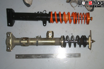

It wasn't long before James decided to embrace track days and he outgrew the Bilsteins and lowering springs, so he took the plunge this winter to go to MCS RR2 double adjustables with remotes. We kept the spring rates on the soft side since he still drives it on the street and to track events across Texas, and the ride is surprisingly good. The remote reservoirs are all mounted on custom brackets we fabbed up and have cushioned clamps holding them down, with the rears passing through 2-piece "Seals-It" grommets for a weather tight trunk.
We also added Whiteline "everything" during the MCS install, with their Watts Link kit, LCAs, LCA brackets, and swaybars + end links at both ends. This set-up kept the Vorshlag camber plates from the StreetPro suspension, which has since gone onto his son's 2014 GT, and now we have the suspension pretty well sorted.

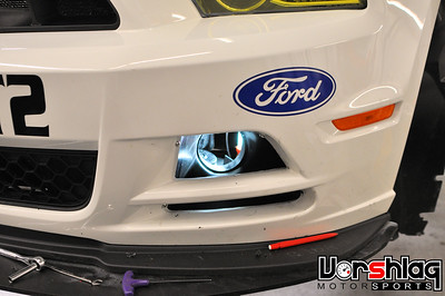

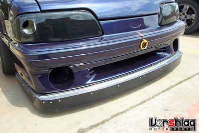

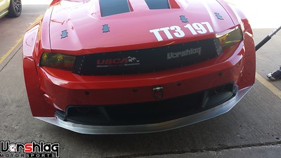

I showed pictures of the custom front splitter we built for this car in my last update. It's a stout, 6061-T6 aluminum plate unit like on my own car, but this time made to fit up against the Roush lower valance or "air dam" section. It was all hand built - carefully laid out on a template then transferred to aluminum and fitted to the car. No fancy high tech CNC anything here - just skill, time and a steady hand.
The black plastic Roush lower valance bit is flat on the bottom (necessary for a splitter) but unlike the '13-14 Boss302 lower valance, this one is fairly affordable and a bit longer front to back. We'll start using this Roush lower valance on '13-14 GTs that need a splitter from now on.
The bracket for splitter struts is hidden behind the Roush lower grill; it was tricky to make but required no big holes in painted bodywork (unlike my car). Very tidy.

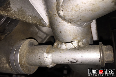

Tow hooks are a good idea for any track car, but the bolt-on kits I've seen offered for the Mustangs are a bit kludgey and heavy. Likewise, the Ford Racing weld-in kits are a bit simple and require cutting holes in the painted bodywork to mount them. We've done several custom front and rear tow hooks on S197s and managed to make them work without cutting holes in painted bumper covers. We place them so they mount right to the bumper structure. In the rear we can just drill a hole in the black plastic rear lower valance piece (replaceable) to have it pass through the body. Likewise on the front, the tow hook mount is cantilevered off the front bumper and passes through the lower grill.

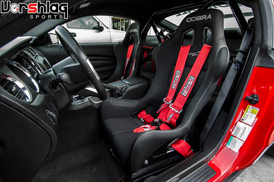

Other safety aspects include the addition of a roll bar and harnesses. For the 4-point roll bar kit we always go to Maximum Motorsports, who makes the best kit for an S197 by far. These kits come in pieces and have to be fitted and tack welded together in the car, then removed and fully welded. We always order them with the optional diagonal and harness bars. We removed James' rear seats and installed the Laguna Seca X-brace and seat delete kit at the same time, which we had bead blasted and all powder coated the same metallic silver as the body.
Schroth 3" cam-lock 6-point harnesses round out the safety gear. We have the lower anti-sub belts custom made to work with the factory Recaro seats (which don't have openings in the seat bottom) and it works like a champ. We made special brackets to add anchors for the lap belts and anti-sub belts also.

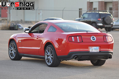

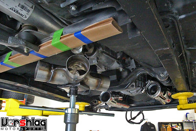

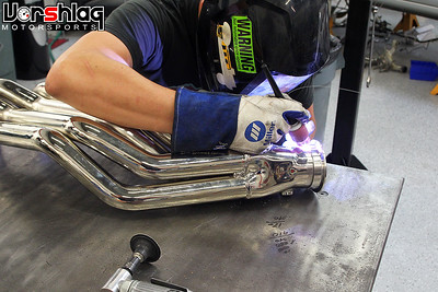

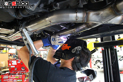

The custom exhaust we built was a good bit of fab work and I could devote a whole post to that, but here are the highlights.
If ever there was a Mustang that needed dual exhaust, it was this car! It was already making 600 whp with the 1-7/8" ARH long tubes and the blower, but it seemed a bit choked to me and it was crazy loud. A lot of what eliminates sound on a car is the shear size and interior volume of the muffler case. The Roush mufflers are itty bitty and only a 2.5" inlet/outlet. The rearmost MagnaFlow mufflers we added are huge in comparison, which you can see above, and have a 3" inlet and outlet. They flow more exhaust while eliminating more noise.
We added bigger 3" resonators ahead of the axle as well, to replace the squashed OEM resonators that Roush equipped this car with (the entire rest of the exhaust other than just the mufflers + tips was stock when it shipped from Roush).
The X-pipe had to be modified to get the most room for the 3" V-band clamps we added. After the X-pipe was tweaked and the 4 muflers mocked into place, then the 3" mandrel bends were spliced together to make the best routing for chassis and car clearance. The rear exhaust was tricky and was built with the axle tied up at "full bump", with the springs removed. We do this to ensure clearance when the rear suspension goes through its full range of travel.
It was a tricky bit of work but in the end it was worth it. The sound levels are MUCH lower yet the car picked up 33 whp with the new exhaust.

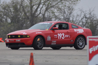

  • March 6-7 - Lapping rides at COTA. Running the '11 Mustang (Terry and Amy both driving)
  • March 14-15 - NASA @ MSR-Cresson. Running both the '92 Corvette in TTC + '11 Mustang in TT3
  • March 22 - Goodguys AAS at TMS (200 treadwear) Running both the '02 Corvette (me) and '11 Mustang (Amy) in AAS class on Sunday
  • March 28-29 - USCA @ TMS (200 treadwear) Running both the '02 Corvette (me) and '11 Mustang (Amy) in GTS class

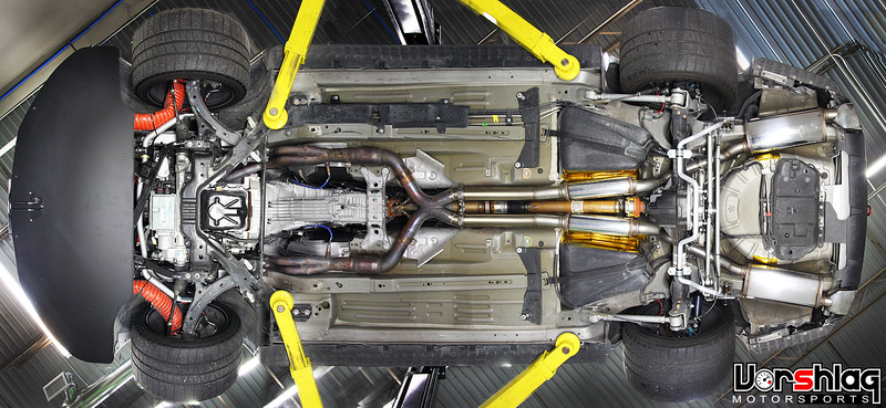

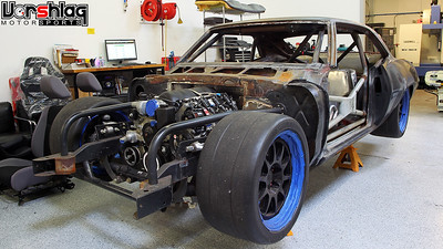

The more I look at this car the more I love it.... and the beauty is underneath!
The transverse leaf spring set-up turns off some, but it works and its light. And look at all the ALUMINUM in that front subframe!!!! Forged aluminum control arms and uprights, crossmember, yum.
And did I mention that its a flat bottomed car?? I'd kill to be able to make most cars that clean underneath.

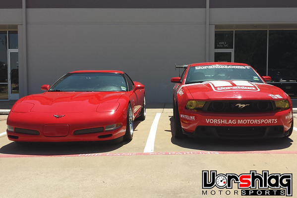

This makes me sad... look how BIG the Mustang is compared to the C5. UNaerodynamic, front heavy, and just... HEAVY.
I know this is blasphemy, but I don't hate Corvettes. I'm driving both our S197 (TT3) and the C4 (TTC) this weekend at the NASA event at MSR-Cresson... I think driving them back-to-back will be eye opening.
C5s are so cheap right now, and C4s are almost free. So I didn't feel bad cutting up this car to make the cage fit, to make it safe. But it sure doesn't have Coyote V8 power. Still think the Mustang will be faster but it is prepped to the limit and two classes up...

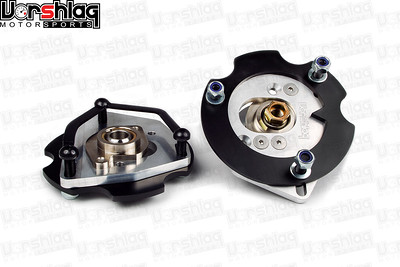

Not only have we made batches of S197 Mustang camber plates we are running most of the 20 other models we make as well. And we have to make the fixtures (tooling) to make the parts. And sometimes tools to make the tools to make the parts. And there are many weeks left before I get much relief - only reason I had a break to write this quick S197 update was we ran out of material last Friday, then had an autocross school we taught at on Saturday, but was free on Sunday for the first time in weeks. Whew!

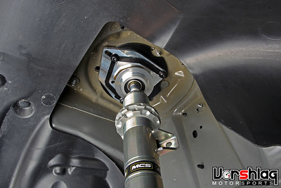

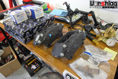

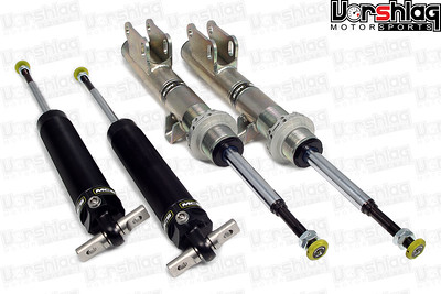

During this whirlwind of activity, Vorshlag engineer Jason managed to design and machine our first set of S550 camber plates in 48 hours, from start of measurements, design work, final CAD drawings, CAM programming and machine work. We had some pieces laser cut overnight and Olof fabricated some parts as well. These went on Aaron Sockwell's 2015 GT from Dusold Designs and he ran the Optima event in this car with a podium finish the next weekend.
These are our prototype Vorshlag camber-caster plates for the 2015 "S550" chassis
We also installed the first MCS coilover kit for the S550 chassis on his car that same week, which was built from Vorshlag drawings by MCS in short order. This set of TT2s and the spring rates we chose, combined with the 18x11" wheels we helped spec and the camber plates we supplied, have transformed this already quick pony into something that can seriously compete with the best of the S197 Mustangs. Good stuff.
The first MCS coilovers for the S550 chassis were made from our drawings, fit great, handled awesome and rode perfectly.
We are working with MCS to make a batch of these S550 coilovers but we still need to complete the rear spring platforms, as well as make a batch of the S550 camber plates, then design the OEM spring perch solution for those. Lots to do...

I managed to sneak in an update on our TTC prepped 1992 Corvette (#DangerZone) since my last Mustang post, which shows the prep before the recent NASA @ MSR-C event. I will have a race report from this event below, covering this TTC car and our TT3 Mustang (I drove both).
Lots of cage and suspension work was done to this car, which is also detailed in this March 12th "This Week at Vorshlag" video.
Also kicked off a new project for Mark Council's 2002 Corvette which is now being built with an eye towards NASA TT2.
I raced Mark's C5 with almost no updates at the Optima TMS race, which I will cover... next time. The C5 build thread can be found here and we will post links there for other forums where we will update this one as well.

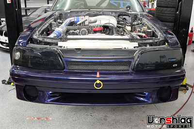

I'm really close to doing a build thread update on the Scion FR-S LS1 swap (shown above right), as it is almost done. We have also made some major headway on the much more comprehensive and complicated Miata LS1 swap (shown above left) as well. Will update those threads soon, if I can squeeze in an hour or two next week.

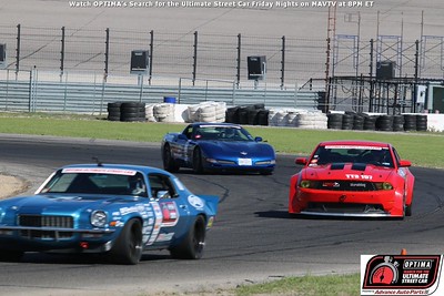

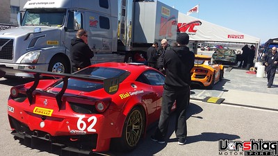

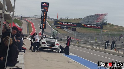

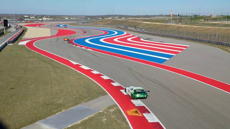

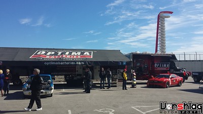

Driving around COTA during PWC race weekend with Optima, March 6-7

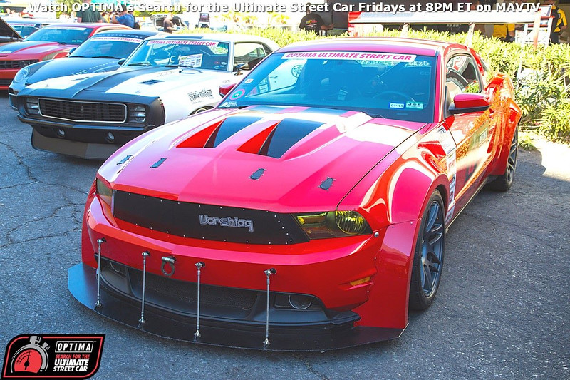

As much as I complain about the rules, I really do like the Optima "Ultimate Street Car" shootout and the USCA qualifier series they started last year to finally allow racers to WIN their way into the big show. We've done 4 or 5 of these qualifiers over the years now, as well as the the OUSCI shootout last November. And while I had some issues with that event, they took racers' feedback and made some big changes. So when they needed some former Optima racers at their booth during a World Challenge race weekend, Amy and I said we'd be there.
North Texas had some FREAKY weather the day before we left to go to this PWC event, as shown above. Snow, and lots of it, in March. I've lived here off and on since 1978 and I've never seen snow here in March. Made for an interesting drive to work in the truck and trailer, but the guys got the Mustang prepped and loaded as this mostly melted off before we blasted the 5 hours down to Austin Thursday afternoon.

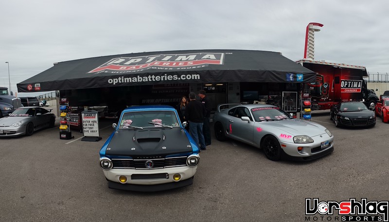

Getting to take some laps around COTA is a good draw, as were the free pit passes. And no, this wasn't a "competition event" for our Mustang, more of a car show and a few fun laps around the F1 track.

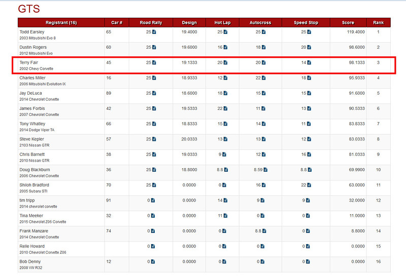

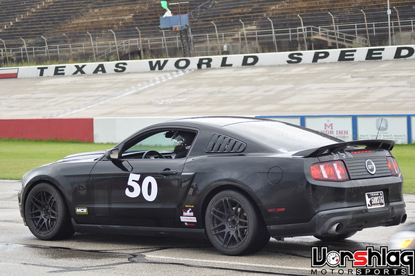

We did have fun there on that Friday and Saturday of the Pirelli World Challenge weekend and met a lot of new folks there who follow this build thread. We helped round up three other cars for the Optima trailer display in the PWC paddock area (thanks Tim and Costas!), after some car owners flaked out at the last minute.
I'm glad we went to this, as it gave us a chance to talk with more of the Optima folks, as well as meet some other great vendors like the Recaro people and others. I happened to give the head of Recaro a ride around COTA in our 2011 Mustang, on street tires with NO REAR WING, and it was a handful. Amy drove the car Friday during the lunch break and I took laps both days; on Saturday I was in our car and on Friday I borrowed a racer's 2005 Mustang for some laps.

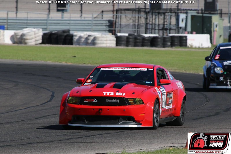

I have video of both days but these were more "80% pace" fast-ish parade laps and not as entertaining as a full-tilt video I would normally share. Such a beautiful track, and I wish more groups could afford to race here, but the track rental costs are still just way too high. When/if NASA ever has a race weekend here, then I'll come back and run this in anger.
The lack of rear downforce (Optima asked us to take the wing off to better represent what their 2015 rules allow) was abundantly clear, and I decided then and there that we needed to make a rear spoiler for this car if we were going to run it in the Optima at the TMS event. Having the car get LOOOOOSE mid-corner at 100+ is not fun! The car was also running pretty rough when I drove it, and Amy mentioned the same thing. Would clear up at WOT but part throttle was bad. Hmm.
We had hundreds of folks stop by and gawk at the Mustang, and it looked good sitting still as well as blasting down the back straight at "whatever we did" (not admitting to the speeds we drove when out of eyesight of the pace car). The PWC classes were also fun to watch practice, qualify and race, especially GT3 and GT4. The 2 minute video below shows the variety and awesomeness of the big GT3 class.
Turn up the volume for this bridge fly-by video of the GT3 cars
With virtually no spectators we could go anywhere and see everything, even on the bridges. I had friends racing in TC and several racing in B-Spec, and the hot pit passes Optima provided gave us full access to everything and everywhere. The B-Spec race race was... well, strangely entertaining? These are THE slowest pro race cars I have ever witnessed but they all seemed to be having a good time.
Sunday's weather was predicted HARD rain all day (which it did), so the Optima folks told all 5 of the folks showing cars at their trailer area that if we wanted to bail before Sunday, they didn't mind. So we packed up Saturday evening and headed back to Dallas. The tow home was less eventful than our tow down on Thursday afternoon, thankfully.
We watched some great pro racing, met a lot of cool people, took some fun laps around this track, the weather was reasonably calm and cool while we were there, and the Optima folks treated us great. We had free food all weekend in the PWC hospitality tent, which was REALLY good.

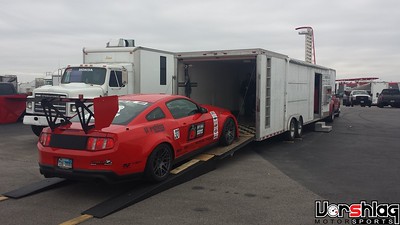

Mustang Prep Before NASA @ MSR-C

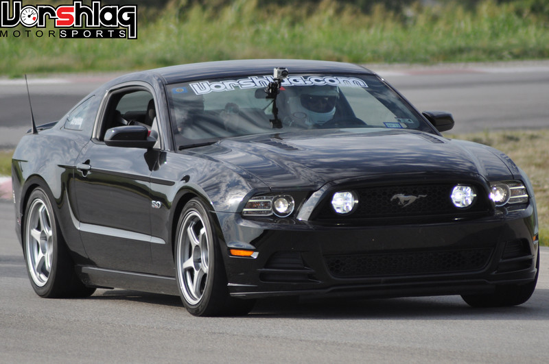

The shop was so busy working on customer cars and our 1992 Corvette that the 2011 Mustang got very little attention prior to MSR-C. We didn't even decide to enter TT3 until just 5 days before the event, after some things I had seen on the Corvette, so we had to scramble a bit to get the car ready.
I got 99 problems and.... not having enough tire storage tires is one of them.
Tires were a problem. The last set of four Hoosier tires I won in 2014 got botched and we received 4 rears (345) but no fronts (335). That was long after we had "sold" the car so I didn't worry about it, but when the sale fell through (3 different times) and we had this event pop-up, we had to go for a used set of fronts and some fresh A6 rears. Fronts came from last year's April TWS event, where we had a hard weekend with 2 drivers beating on the tires. We had another a new pair of 345 A7 rears, but with nothing but worn 335s for the front, I didn't want to make that big of a grip imbalance.
Fresh fluids went in, including 15W50 Mobil1 oil (not 10W30 as shown!) and Motul RBF660 brake fluid
I almost went with scrubs out back as well, but we are going to move to A7s soon so I wanted to use up the last of the sticker A6s. This car is also a real bear to drive with no rear grip, so we went with old fronts + new A6 rears, knowing it would probably make the car understeer or "push" a little bit - which it did. Calculated risk. Pads/rotors looked good so our guys changed the oil and pushed some fresh Motul 660 through the brake system. MSR-C is easy on brakes.
The wing went back on, of course, and Jon made some new TT3/197 decals for the side and Hoosier decals for the fenders. Other than that, this was the same set-up we ran at Optima back last November with almost no changes other than the tires. Since we would be running Optima soon, I had them keep the 2nd set of 18x12" Forgestars mounted with the BFG Rivals mounted on that. We brought a spare front and a rear (used) Hoosier tire along in case we had one go down on us and figured we could have it changed at the track.

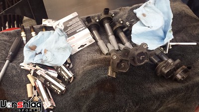

The funky engine running issues were thought to be fouled spark plugs, as we haven't really driven the car in many months other than to move it out of the shop to work during the day. A new set of Bosch Iridium spark plugs were installed and it seemed to run fine, so maybe that was all it needed? Amy cut some red vinyl sheet and placed it in front of the fender flares at all four corners, to protect the new paint. Need some clear PPF applied....

We got Mike's 2012 Mustang and the Corvette unloaded off his open 2 car trailer, then our Mustang unloaded from our trailer right before dark. We then reloaded the Corvette (no side windows) into our enclosed trailer, since it looked like rain might hit over night. Amy, me and Mike unhooked the two trailers and we went to dinner in Granbury at the 1890, best restaurant in town. Amy and I stayed in Granbury at the Hilton Garden Inn, 15 miles from the track but it is worth the drive - not to mention the one hotel in Cresson fills up months in advance for race weekends.
I'm glad we brought both cars. We got to the track early, then scrambled to get both cars ready without any crew to help (mistake). TT meeting was brief, check tire pressures and fuel levels, then I suited up and climbed into the C4 while Amy got ready in the Mustang. I went to grid and started mid-pack for the "Saturday Practice" session, which doesn't count for TT competition but the times are used to establish grid position. Scrubbed in the used R7 tires from the January event and they felt great. I got into a group with the front cars that quickly pulled away on the first hot lap, with nobody behind as far as I could see.

Above: Construction of custom splitter version number 3, AKA: the "C Prepared" Splitter
Ryan also made a new front splitter for the Mustang that Amy wanted to test. The new rules for USCA/Optima disallow any rear wings worth building, and we ran out of time to make a rear spoiler (that we'd likely never use again), so I asked the guys to make a "short" splitter to reduce front downforce. I had also looked at possibly running some SCCA autocross events and the only class that the car remotely fits in was C Prepared, with no wing and a short splitter (or SMOD). So we followed the CP ruleset for the "shorty splitter" and it follows a "top-down outline" of the OEM bumper contours. Short and sweet, with no need for the four support struts, this version allows for more street use; it has better ground clearance with the lower overhang.
Left: Custom splitter version number 1, used at Miller in 2013, was 10.25" long. Right: Custom splitter version number 2 was only 6" long
This makes the third splitter we've made for this car, starting with the original 10.25" we ran at Miller in 2013, the 6" splitter we've run all through 2014, and then this 2" splitter for CP/Optima use. It looks weird without the wing, to me, but the new rules just forced us to do this.

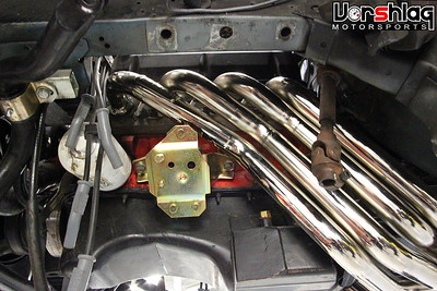

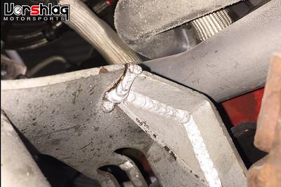

One of the more troublesome parts that I try to get Mustang racers to avoid are tubular front crossmembers (aka: front subframes) and front lower control arms. This is a critical area for suspension loads and chassis rigidity, but it seems that in the 1990s there were companies playing the "who can be lightest and cheapest" game with tubular crossmembers and it spun out of control, with the end result being that most of these began being made out of overseas sweat shops. Another area that people went chasing weight was tubular lower control arms. I've seen too many cracked or failed aftermarket tubular arms and K-members to count.
As you can see, the Fox Mustang aftermarket tubular crossmember above is all cracked-up and about to explode, heh. Luckily this 1993 Mustang owner brought this track-only car (built by someone else) in to Vorshlag for a track inspection before this Chinese built subframe could come apart completely. We contacted the folks at Maximum Motorsports, who still make their robust designs here in the USA, and got this new subframe straight from them.
Installing and squaring a crossmember to the chassis takes some time to get right (see this video). While we were in there we replaced the solid motor mounts with some poly versions, replaced a cracked steering rack with a rebuilt SN95 unit (the steering shaft coupler is different on Fox vs SN95s, BTW), and even swapped in some BBK long tube headers in place of the old school shorty headers.

I had Olof add 3" stainless V-band flanges to the collectors, because I absolutely hate ball-and-socket and 3-bolt collectors, and now they won't leak nor restrict flow. He also built a whole new exhaust, but kept the original mufflers, per the customer's request...
With a 3" Magnaflow X-pipe section, 3" mandrel bends, and 3" stainless tubing the new system won't rot and fall off and it isn't 2.5" anymore. It also sounds NASTY, but in a good way. Now the motor (with AFR heads and cam) can actually breath and it picked up about 50 whp on my "butt dyno", heh. It amazed me in the 1990s how many Fox Mustang guys cheaped-out and went with shorty headers, based mostly on bad information or lazy installers. Upgrading to full length headers with a free flowing exhaust is the best bang-per-buck power upgrade on virtually any V8, this side of NAWSSSSS!!!!!one11!
Also built a short splitter/aluminum undertray/air dam, added a rear tow hook, cut open the upper grill area for more airflow. Then we added stainless steel mesh to all of the openings - the upper and lower grill plus the brake duct holes, to keep the big grasshoppers out. This time of year we get swarms of the little buggers here in Texas. This Fox Mustang work is partially covered in a "This Week At Vorshlag" video - April 13, 2015

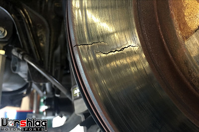

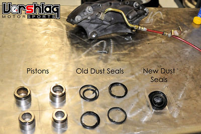

The brakes needed the most work. We had a caliper "de-thread" at the mounting holes at the Las Vegas Optima event. I wrote about it... well, in the ranting race update that I'll never post. We also had a front rotor issue there, so some Autozone replacements went on. They didn't last two weekends (NASA @ MSR-C + Optima), but the cheap stuff usually never does. So a new set of Centric Premiums went on along with a fresh set of Carbotech XP20 pads front and rear.
If this were gong to an autocross I would have had the guys keep the pads on, as they had about half pad depth left. But for a NASA event at Texas World Speedway? Where we might be going into a braking zone at 150+ mph? No, I don't want to ever risk brake failure again like last year at RA. So we went with fresh pads, fresh Motul RBF660 fluid, fresh Alcon caliper temp strips, and fresh rotors. We even put on a fresh set of Brembo calipers up front as well. Look at the image above and you might guess why.
Slowing down 3802 pounds of Mustang (with driver, fuel and ballast - to reach TT3 power-to-weight limit) isn't easy, even with massive 4" brake ducts and good fluid/pads. It takes its toll after 5 years, and this is now our 2nd set of worn out calipers. The dust seals were fried and the were just ready for a rebuild. The scratches in the upper sections were from gravel picked up during the "off" at RA and ground between the calipers and wheel barrels. The inside barrels of the front wheels got similar rock rash but had already been replaced.
Instead of a messy, time consuming caliper rebuild, it is just cheaper for us to buy new calipers from our Ford source, which we use in our 14" Brembo upgrade kits. One of the old calipers had already been heli-coiled (Vegas) and the other was showing signs of worn threads. We didn't want to risk more abuse so they are now new, as are the Brembo clips and pins with new bits.

We made a tactical decision before entering Optima @ TMS to put Amy in the Mustang in their GT class while I borrowed a customer's C5 Corvette to run in their GTS class, and I will explain why below. This Optima event write-up will be in both the S197 Test Mule and the C5 Test Mule forum build threads.
Plus I have a new plan to sell our 2011 TT3 Mustang that I will explain at the bottom of this thread update. This is sure to get a buyer - because I have lowered the price until it hurts, and will keep sweetening the deal until it sells. Gotta fund the next build, and I don't want to inadvertently hurt this pretty car by continuing to race it. I've also noticed that I'm holding back on my driving of this car, since its for sale (but it still keeps winning - other than with Amy at Optima). Read below for more details, pictures, video, and more.

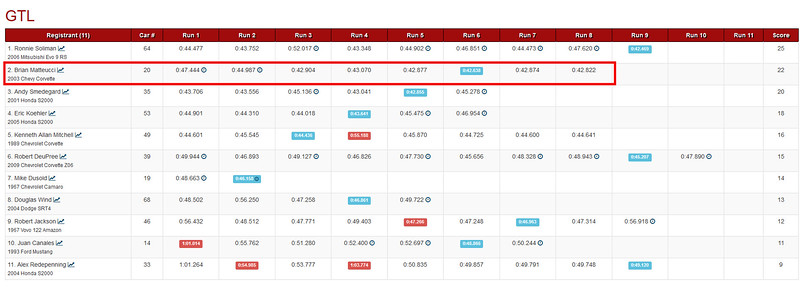

Brian Matteucci (above) is an old college racing buddy and fiend - who sold me the smoking C4 Corvette (project #Dangerzone) I've been running in NASA this season - was also there in one of his two blue C5 Z06 Corvettes. The car he brought this time was his "track rat" that he had recently purchased for NASA TT prep. This car came with a worn-out smoking motor, on its last legs, but with a fresh LS block already in line to be built by HKE. Brian did really well at this Optima event in GTL class, especially considering it was a bone stock C5 Z06. He is an experienced autocross and road racing driver, and he proved that "skill > parts" once again. His Z06 was running on 275mm Bridgestone RE71R tires, which don't suck but were significantly narrower than the 295/315s I had on the 2002 Corvette.
I point out his times to show how badly the "eBay" Corvette I drove did in comparison. Brian and I have known each other and raced together for 25 years, and we have co-driven lots of cars together. Our driving styles and general times are usually very close, so keep that in mind when you see his Autocross and Speed Stop times in a stock C5 Z06 vs the times I was able to lay down in a "modded" C5, using a lot of parts that are "popular on the forums". I only bested him in the Hot Lap challenge, but that was because he only took like 6 laps, due to the excessive blow-by and smoke from his worn out motor.

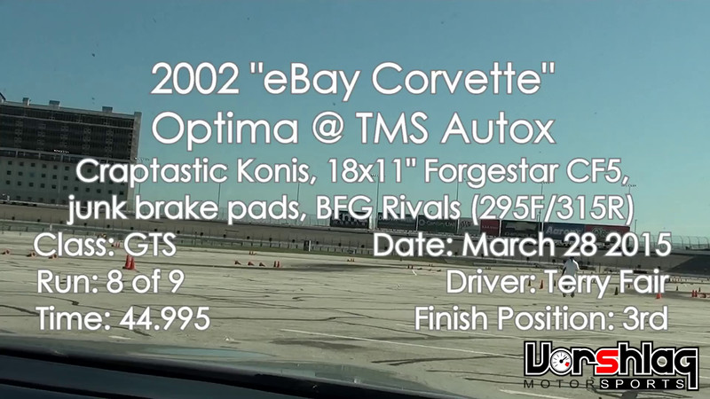

I fought the eBay Corvette all day Saturday in the Speed Stop then the Autocross event, cursing up a blue streak and even making up some new words. The Koni 3000 series dampers are way too long and only work at really TALL stock ride heights. With a 1/2" of lowering on the previously installed aftermarket spring bolts the car had virtually no rear bump travel (1/4"!) and would bottom out simply under acceleration, as well as whenever I hit any actual bumps or dips on course.
Handling was flat TURRIBLE, but the braking was a big hot mess as well. The Hawk HP+ front pads were overpowered by the racier (Hawk HTC?) rear pads it had installed, and this threw the brake bias off so much that not even the C5's ABS could keep up with. This video is my 8th autocross run of 9 attempts, and one of the few where I managed to point it between the cones correctly. From the clutch to the shifter, brakes and handling, what a total MESS this car was. Of course it should have been tested before Optima, but as I wrote in my last C5 thread update, we didn't have the time to do any testing or change any significant parts. We ran what it had + the 18x11 Forgestar CF5 wheels we spec'd and had rush built, shod with some used 295F/315R BFGoodrich rival tires we had around the shop (Rivals were completely out of stock at the time, and this was the best we could come up with on short notice).
Somehow, even in the worst handling car I've driven in a decade, the ebay Corvette still managed 3rd out of 16 in the GTS class for the Autocross, with AWD cars (unsurprisingly) in 1st, 2nd, 4th and 5th. That finish result was shocking knowing how slow I was compared to Matteucci in the stock C5 Z06. My best time was a 44.995 and Matteucci ran a 42.638, on stock sized wheels and 275 tires compared to my 18x11's and 295/315s. Yes, you CAN make a C5 handle worse than stock, to the tune of 2 seconds, if you choose the wrong parts. So this ended up being a good test, to show which mods to not choose.

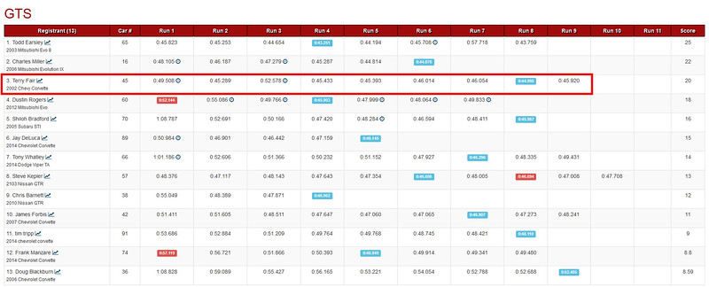

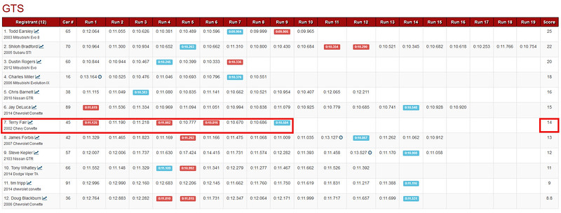

Amy got a decent time for GT class but as you can see below, I ended up way down in 7th place for Speed Stop with my 10.584 second time on my 9th and final attempt. Same issues in the autocross fought me here on the C5: grabby clutch made launches difficult and the mismatched pads made for ICE mode stops, so I had to brake at about 8/10ths to avoid rear lock-up and axle tramp.

As I mentioned above, Amy's Mustang finished 2nd in the Design and Engineering competition against one of Ken Thwaits' two entries and our customer James Meeker got 3rd - both cars have been featured in this S197 build thread many times (we have Meeker's car in our shop now for more cool updates, which I will share next time).

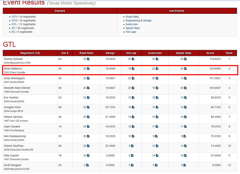

As you can see in the results above, James did well at the Hot Lap track event, (using the MCS RR2 doubles + Vorshlag camber plates + Whiteline everything + 18x11 Forgestars) taking 6th place right behind Aaron Sockwell's 2015 GT (which has MCS TT2 shocks and Vorshlag camber plates + 18x11 Forgestars). As I mentioned before, Aaron's 2015 looked good out there and we weren't surprised when he took 5th in the Hot Lap event (somehow a 2 seater 2006 Corvette snuck into the GT class to take 3rd?) and 3rd overall in GT class. Amy, Doug, Jon and even Shannon were all in the hunt on the road course, too.
Matteucci's 2nd place Autocross and Speed Stop times were good enough to put him into 2nd overall out of 12 in GTS class, fighting against the lightest and fastest cars at this event - in a stock C5 Z06 with a worn out motor (this was the last event he ran in this car before pulling the tired LS6). Ronnie Soliman took 1st in the Autocross, Speed Stop and Hot Lap challenge in his 2006 Evo, which was very light and well built. Those AWD cars are still the overdog cars to watch out for in GTS - and since they combine all the classes for the main OUSCI event, also a threat to win it all in Las Vegas. If I were a betting man that's what I'd pick for the finale after SEMA.
As bad as it felt, somehow the eBay Corvette earned 3rd overall in GTS class, surrounded again by AWD buggies. This was a complete shock to me, as I felt like my Speed Stop times and Design/Engineering score would keep me off the podium. But hey, I'll take 3rd in this mess of a car. Just going .04 seconds quicker in the Speed Stop would have put me in 2nd place in GTS class, but I was a long way from 1st. That was taken by our friend Todd Earsly in his EVO. Todd made a concentrated effort to focus on Optima events about a year ago, running NASA events in TT1 class on street tires just for the practice, and its really paying off - this GTS class win gets him a spot in the 2015 OUSCI event. Congrats to him!

We've already done some real work to the "eBay Corvette", including a new QUIETER exhaust (side exit), a dyno tune at True Street (car picked up +25 whp and +23 wtq after the exhaust + tune), and MCS shocks are being built this week. I'll cover much of this in the next C5 Test Mule thread update in the next 48 hours or so. We're also working on a number of other interesting projects...

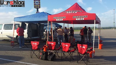

Texas Region SCCA Autocross School
Brad, Amy, Jon, and Olof from Vorshlag went to this autocross school April 18th, 2015 at Lone Star Park. This is held by the Texas Region SCCA every year, and Amy and I have been instructing there for about a decade. Together with another dozen instructors we (hopefully) taught 38 new students some autocross skills. Each student got dozens of runs that day and at least 2 instructors riding through with them 6+ times each.
Left: Olof running Jason's NA Miata (which is about to get MCS coilovers). Right: Jon's wife Erin driving her Mini Cooper S
Just showing this because it is one of many events we go to that I normally don't cover in some "Race report". This is how we end up spending 30 weekends a year at some sort of racing related event. Good times were had by all and I want to thank all of our Vorshlag crew for volunteering at these events.
Film Crew at Vorshlag for Optima
I meant to mention last time that Kevin Mooney and his crew arrived at Vorshlag the day before Optima to film some interviews and some of the cars in our shop at the time, several of which entered the March Optima event. We were slammed that day, but I turned the CNC machines off for an hour while they were here. They interviewed me and Amy both, and some clip might make it on the episode covering this March Optima event. That should air on MavTV around August, but since so many folks don't have this TV channel (myself included), they are going to start putting these on YouTube a few weeks after they premiere. I'll share those videos here when that happens. I still haven't seen 2 episodes from this show that I've heard we were shown in.
Pre-TWS Race Prep on Mustang
After the Optima event we needed some preparations for the "Last Ever" TWS event with NASA (more on that below). But strangely enough, I jumped ahead in time and covered this prep TWO posts back. Like I said then, we replaced the Brembo calipers, pads and rotors up front and rotors and pads out back, plus all of the fluids. ALL NEW BRAKES. On went our proven TT3 aero package front and rear, and also lots of NASA specific decals. We even had a $750 custom set of PPF film applied to protect the paint, since the car was painted recently (before SEMA) and we wanted to protect the finish for the next owner (LOL, what owner!?)
But one thing we found that wasn't "ready" was some damage to something in the rear suspension. A bushing was checked and was fine before Optima at TMS, but we think it was smashed during Amy's massive off-track spin into the infield during Optima. She was doing 90+ mph when she took it off track, sideways. The problem was we were only a day from leaving for the TWS event when Olof found the issue during his normal pre-race inspection and alerted me. No time to source a replacement, so I said "screw it, I can drive around that problem", heh.
Of course this was always on my mind and we massively limited both our number of laps in the car at TWS as well as the intensity of our cornering all weekend, as I feared this issue would allow the axle to move laterally a bit (it did). This car has logged 55 race weekends on this part, with the massive Hoosiers and the added aero loads this car has. As you will see in my data-overlaid video from TWS below, the car is pulling 1.4g lateral at low speeds and 1.5g and higher with added speed and aero loads. To make it 55 race weekends plus that big spin at TMS is remarkable, and we should have been more timely in our pre-track inspections - which tend to take place at the 11th hour.
We were leaving for TWS the next day and it was "the last ever" TWS that NASA would hold, so I said "screw it" and we ran it with a damaged suspension part.
This is also another lesson learned from me - DON'T WAIT UNTIL THE LAST MINUTE TO PREP YOUR CAR FOR A RACE WEEKEND. Always give yourself a few days buffer, in case you find something worn or broken that you don't have on hand as a spare. Not having an extra set of brake pads and my "screw it, I can drive around it" attitude caused my loss of brakes at Road Atlanta last year. I could go on and on with examples - please, learn from my stupid mistakes! Keep extra consumables on hand and inspect everything in time to get a replacement if you find something amiss. :)

We never intended to drive the car on track on Friday, at the Test-n-Tune, as I wanted to keep the sticker set of Hoosier A7 tires fresh for Saturday. And if there's a track layout I know well, its the TWS 2.9 mile CCW circuit. I've driven this track hundreds of times since 1990 and many times in this car. NASA Texas has traditionally run TWS twice a year, once in the spring and once in the fall, changing the circuit direction for the seasons. We missed this CCW event last year (part of our focus in 2014 on Optima @ SEMA) so we were sitting on a fairly old TT3 record we set in 2013.
Saturday - Race Day 1
Light rain was still coming down early Saturday morning and the track was wet (and still sprinkling) for the first HPDE sessions (shown below) as well as the TT Warm-Up session, so I didn't go out - only 13 TT cars attempted to get a lap in this 20 minute session.
Their times were all way off BUT they got to grid in the top 13 spots, so I got to the grid early for TT session 1 was lined up in 14th place. The sun came out the the track got drier, but almost all the cars ahead of me on grid were slower, so traffic in this session was absolutely terrible. And it was very very full (44 cars!). Traffic wasn't just bad, it was just one big train. If you weren't lucky enough to grid up front you were doomed. I was having to pass 4 and 5 cars per lap, always getting blocked, and after two laps I had already caught the back of the field - so I threw my hands up and came in. The tire rub in the rear was very noticeable and I didn't want to cut a tire, so I was being extra gentle in the high-g corners (T1, T3, T7, etc). All I could muster in traffic was a 1:59.4; Now I regretted not going out in the raining Warm-Up session, since my grid positions would be compromised all day.
Amy went out in an HPDE 3/4 session and took some fun laps, then she came in and I checked the car. Lots of rubber building up on the inner fender liners, from the damaged bushing allowing some slop in the rear. With my crappy session 1 times I gridded up for TT session 2 back in 14th, once again, so I knew traffic would still be a big factor. The sun had been out since the morning session and the track was almost completely dry, but now it was HOT and the tires wouldn't be happy out there for long. Still, I was sitting down in 3rd place in the eleven car TT3 class. I desperately needed a clear lap to try to drop the 9 seconds to get down to even our old lap record from 2013 (1:50).
Amy having fun in HPDE3/4, with water still standing in some areas
Traffic was pretty terrible once again and I passed multiple cars on my best of two laps, getting down to a 1:52.295. That was still 2 seconds off our 2013 pace but I was still mired in trains of traffic and the grid was PACKED with TT cars, and the temps kept rising. With the track heating up and no end for the traffic, I wasn't going to get a faster lap in without a miracle. And I don't believe in miracles.
The closest TT3 competitor to my 1:52 time was Andrew Stevens' C5 Z06 ST3/TT3 car, with a 1:53.712 time, shown above. I met him this year at MSR-Houston when I was racing the TTC Corvette, and show the inside of his car in the pictures below. Its a fully built and legit W2W race car. Honestly, having a built C5 Z06 jump into TT3 has been my biggest fear for the past 3 years - these cars are easy to make fast in TT3 trim. My buddy Brian Matteucci has a nearly identical blue C5 Z06 he's building for this class, too.
So anyway, Andrew was running in the Blitz W2W race group as well as the TT run groups. These W2W + TT entries are called "super sized" and its a bargain to register this way, as it gives you twice the chances to win tires. Unfortunately for him this weekend, the Blitz race groups were always running the session before TT. This would mean he would have to come off track after a 20+ minute race, go right into grid with super hot tires, and then go right back out on track in TT. So after the last Blitz race of the day I played a waiting game in paddock... we were parked right next to grid, and I was looking for car # 225 to show up. If he went out I would run hop in the Mustang, drive over to grid and counter, but he didn't show so I sat out the last TT session of the day fairly confident I had the win. Fewer laps = less chance to screw up the rubbing rear tires. Whew!

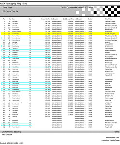

So we ended up winning Saturday, placing 1st out of 11 cars in TT3, but only by about 1.5 seconds - the closest margin we've had in this car in a while. But I knew it had a lot more left in it, if I could get around traffic. This time was still 7th quickest for all of the TT field, which would mean we would finally grid higher up on the grid for Sunday (7th).
It was hot at the end of the day and everyone was sweaty and tired. There was the usual NASA dinner party Saturday night, but the 300+ entrants made for super long lines, so a few of us decided to go into town and get some good food we missed from our days living here decades ago. Los Cucos is a Tex Mex restaurant I first ate at in 1996 in Houston. They opened one of these in College Station a few years back - I really wanted to get some of their fajitas a la Cucos, and of course a TALL and cold mug of Dos Equis lager on draft to cool me down. Paul and Anna joined Amy and I and we feasted surrounded by lots of other NASA racers eating there as well.
Sunday - Race Day 2
Each weekend day of a typical NASA race weekend is a new race for TT, so with a win and two Hoosiers won on Day 1 we were aiming to repeat this on Sunday - plus with the better grid placement, were hoping for clear track and a new TT record for the class on Day 2.
The rain and bad weather held off Saturday night, so we were treated to a dry track in the morning - something Texas hasn't had much of lately! The off-track areas were still SATURATED with rain and any cars going off were almost guaranteed to get stuck in the mud, so I really wanted to avoid any "offs" in the pretty and clean Mustang.
The car had been running great all day Saturday but I wanted to really limit our laps on track Sunday, if possible. Amy was still just trying to get in her last few laps at TWS before the track "closed in June" and she wanted to run at least two more sessions, but I was worried that this $1700 set of Hoosiers were going to get chewed up if we kept pounding laps on them, and that we really needed to fix the rear rubbing issue before we pushed the car any harder. We also had this car FOR SALE, so we needed to keep it clean and unbroken.
So after our "strategy session" that morning we decided to put me in the car in TT session 1 Sunday with a goal of making ONE HOT LAP, then come in and see how the car looked for Amy to make some laps in a later session. There's also the fact that in TT if you have an off or spin you lose ALL your times from that session. Also, if we could get loaded up and on the road home before noon we could make it back to Dallas before dark, relax for a few hours, or - more likely - go back to the shop and CNC machine more parts. That's all Amy and I do at night and weekends - load metal and run the CNC machines, making all of the pieces we need for camber plate orders.
So we checked all the fluids and pressures and got the red Mustang to grid for TT Session 1, the coolest session of the day. With a dry track and cool air, it would be THE perfect session all day to get a fast lap in. Since I knew this car well (after 5 years) and knew this track like the back of my hand (my first laps were taken here in 1989!), I felt like I could get it done in a single lap. It was the LAST EVER event that TWS would have at TWS, so I wanted to cement our lap record in the books for good, and improve on our 1:50.6 TT3 record from 2 years ago.
Excuses: we should actually be about 2-3 seconds faster than our 2013 laps, with the improvements we made in the 2014 season, so I was still 4-5 seconds off the pace. With the wounded rear I was taking it easy going into Turn 1 off the banking, keeping it to around 140 mph on turn-in and braking early. Still, I REALLY wanted to improve upon our 2013 record, as this might be the last time we run this Mustang with NASA, if a buyer finally shows up (we're at 4 flaked out buyers and counting). So, the goal was nothing less than a new a track record and two wins.
The one lap I drove on Sunday, in TT session 1...with data overlay
So my lone lap of the day is shown above, and with some careful gapping on the out lap I managed to get a traffic free lap. I was still feeling the tire rub on most high speed corners, which made me cringe, but I drove through it and managed to get in a clean lap. As you will see at the end of the video there was a big "off" by TTC Mini competitor BJ, who I race against in the TTC Corvette (when it runs). With the wet grass he was stuck and they had to roll a flat bed and tow him out of the mud, shutting down the session early.
After that 1:49.9 lap I felt fairly confident we had the win in the bag, but it turned out to be a 4.2 second lead over second which stuck all day. Amy went out in an HPDE 3/4 session but a DE driver went off track pretty hard and found something to run into, which ended that session after 2 laps. So she brought it in and called it a weekend also.
The sun came out and everything heated up, and in the end most of the TT field set their fastest laps in TT session 1 or 2, but 2nd place Andrew got his best lap in during TT session 3 (after we had left). We stuck around until noon, loaded up, said goodbye to our friends, and hit the road by 12:30. I watched MyLaps app for live timing on the way home, fingers crossed, and wasn't really sure we had won until later that evening - another "whew" moment.
So that worked pretty well - 4.2 second win over 2nd, 6th quickest in TT all weekend, 2 wins, new track record, won four more tires, took one lap to get it done Sunday, and the car was reliable even not being 100% going into the weekend. The new set of A7 tires still had plenty of life left in them when we were done, too.

Amy went out in the first heat, when I was working as announcer, and she was taking passengers and having fun in the car. She didn't take it too seriously - neither of us did that day - and had a ball. She started in the 48 second range and by her 4th run at a 43.854. She was admittedly rusty and the rear suspension was sill busted, so the rear tires rubbed like crazy. You could feel the car lurch when the rear axle moved over and the sidewall rubbed the inner fenders. I warned her but told her not to worry about it.
She did get called out for "blowing sound" (with a high of 104 dB), as did about a dozen others in the first heat. While I was trying to work in the timing trailer that heat, no less than five busy bodies informed me that we MUST do something to lower the sound "before she could make another run!" Some of them got quite huffy and exasperated when I told them - if you want it quieter, I will just drive it into the trailer, leave, and be on our merry way. :)
After they told Amy it affected her driving, and she was trying to upshift to 3rd gear near the completely irreverent sound meter, but eventually the Regional Solo RE came by and said (I'm paraphrasing): "Don't worry about any of these folks - none of whom are the Sound Chief - TMS is a race track and is NOT a sound restricted site. They are just taking data for the National office. Have at it!" By then Amy was done with her first three runs and could finally open it up on run 4, but slowed a tick on run 5. She placed 2nd in this PAX'ed W class by 2 tenths, oh well. She had fun running with her good friends Jen and Melinda. :)

I was feeling the car out (wow, it can LAUNCH now!) and managed a 43.3 on my first run, matching Amy's best. The temps were up and the A7s were GRIPPING. The course was also set-up well for this car, not too many slalom cones, with speeds topping out 2nd gear in a couple of spots (high 70s). This is the first time I've autocrossed the car on the 335/345 Hoosier A7s and I was VERY impressed with the mechanical grip. Of course there was little to no aero help here, but the big wing and splitter made people ogle the car all day.
I under-drove the car on my first run, but I didn't let that happen again. By run 2 the times were in the low 42s, and by run 3 I realized I was under-using the brakes. With warm pads the car would STOP but I had to really dig into the pedal. On my 3rd run I topped out 2nd gear in the first setion and went for the brakes very late, pressed HARD AS **** and something went POP! The pedal dropped down another couple of inches but the car still stopped. The rest of that run was weird and the pedal had a lot of slop in it, but I managed a 41.3 second time - Fastest Time of the Day (FTD) so far, by a good bit! Of course I coned it away.
I managed to break this brake pedal cross pin after 5 years and a LOT of hard braking
There were people coming by and looking at the car more seriously after they heard the times announced, and the right seat was never empty. After this run I tried to see what was wrong with the pedal, saw the issue, but ran out of time and had to take run 4 with a broken pedal arm-to-brake booster clevis pin. The little plastic pin showed above is ALL that holds the pedal to the clevis, and when it shears the pedal can travel further before it eventually runs into the "U" in the clevis. Makes for terrible pedal feel!
I left the car in grid while I ran to our trailer to get parts, to repair the busted brake pedal pin
On run 4, fighting the busted pedal pin, I over-drove one corner and slowed down to a 41.8. I immediately got out of the car, sprinted the 200 yards back to the paddock (in another parking lot across the road), rummaged in our trailer and found an M8 bolt and nut, ran back, and made a quick paddock fix for the busted pin. It worked and I jumped back in the driver's seat in time to put in my 5th run, a 41.553 second pass, which was my fastest clean run. Much easier to drive with the pedal directly connected to the brake master cylinder, heh.

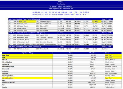

The results for Big Red were shocking, but we'll take them: a Win in SMod, Top Time of Day and Top PAX Time!
Man, that course was fun! Somehow these "just screwing around" runs with the axle sliding around and the rear tires rubbing inboard, we still managed to win the Street Modified class, set Top PAX time and also set FTD out of the 162 drivers. This car is unstoppable! We had dozens of folks stop and tell us that they LOVED the car, the sounds and sights, and thanked us for coming out. I do miss autocrossing, especially when we have a fast car. The BMW E36 "Alpha" car was this much fun to autocross back in 2009, when this gutted 2500 pound car had the 490 whp 7.0L LS2 engine and giant Hoosiers. FAST HOONAGE!
Setting FTD and Top PAX was easy in this V8 BMW back in 2007-09 - driving the Mustang on giant A7s made me fast in an autocross again!
Amy and I were both carrying around passengers and didn't have the car optimized for autocross, but it was still effortless to drive on the big tires after I made the shock adjustments. Why didn't we ever run tires this big when we were in ESP in 2012? Oh yea, that wasn't really the class we prepped for back then, and making 335/345s fit costs real money. But like I always say - TIRES MATTER MOST, and as we've seen on this car, BIGGER IS BETTER.
People ask me why we run a 345mm DOT Hoosier on this car, and I tell them "because there isn't anything bigger!" ;) Seriously, with a 3600 pound car + a 200 pound driver and 400+ hp, you really can't have "too much tire". My next track build (which we will begin as soon as we sell this car) is going to be 1000 pounds lighter, make more power, and have more aero. Do you want to guess what sized tires it will run? (hint - nothing smaller than these!) :D
Despite a few irritating folks, we still had a lot of fun running with the Texas Region SCCA that day and the Big Red Mustang really dropped the hammer. I wish we had tried to run this car on these giant Hoosiers sooner, as the only SCCA autocrosses we did last year were on the 200 treadwear street tires, in preparation for Optima @ Vegas. Gotta love that "Purple Crack" (Hoosiers!). At least we finished our last autocross in this car on top.

Then I had the guys vacuum the interior and finally photograph the current Cobra seats and Scroth harnesses, which we never seemed to get a good picture of. All of these are new within the last 12 months, and they look perfect. I was going to add this to the For Sale ad, but it seems pretty pointless now, as we're going to part the car out.

S197 Rear UCA Install
One of the other recent changes we made to Jamie's white GT included replacing the Whiteline rear UCA assembly with some parts that use spherical bushings, from Multimatic and Steeda. This car has gone from "street driven track car" to a dedicated race car, so this move makes sense. The Upper Control Arm from Multimatic is the same as we used on our Red GT, but these have been out of production and not sold for a while. Jamie found the arm (below left) but not the matching chassis mount needed - so we made one. the Steeda spherical bushing assembly for the axle side (below right) of the UCA was also installed.
continued below
Vorshlag-Fair
Official Site Vendor
Official Vendor
Nov 12, 2010
1,592
107
Dallas, TX
continued from above
The various UCA designs on the S197 Mustang are a sticky subject. The OEM piece (below left) has a big rubber bushing at the axle and as well as the upper mount for the UCA itself. These are pretty soft bushings because they need to PIVOT quite a bit on the sold rear axle suspension, so they have a lot of bushing slop that can cause axle tramp, change of pinion angle, and slow down the rear suspension reactions to torque changes. If you have read this build thread for a few years you know we tested a variety of aftermarket designs and settled on the spherical UCA design from Multimatic.
This was a $700 arm + mount when new, which is pretty crazy, considering the Whiteline UCA + mount (above right) is only $242. But.... the current UCA design from Whiteline isn't my favorite solution for this arm. The "elastomer" they use is very firm (like polyurethane) and doesn't allow the arm to pivot, which could lead to premature wear on the axle side OEM rubber bushing (which has to do almost all of the pivoting). We've been hounding WL to release a new design with their Max-C bushing (which I showed from my SEMA 2014 coverage in this thread). Most of the other brands also use a poly bushing upper mount, or a spherical mount, but most of those are even less desirable than the WL unit, due to a number of factors (poor adjustment style, low end materials, and most of all - NOISE). Virtually all of the spherical bearing units we've installed made heinous amounts of noise.
The Multimatic UCA design was elegant and simple. It uses modified, stamped steel OEM arm and upper mount, with a big spherical bushing added inside the end that is made to PIVOT SMOOTHLY, has no rubber to compress or deform, and has worked flawlessly for years in our car. The chassis mount is made to capture the bolt and machined bushings that fit snugly inside the spherical. Sure, it makes a little bit of noise due to it being all metal, but it works without any bind or slop. But you cannot buy them...
Since Jamie only found half the Multimatic solution, Olof took an OEM 2011-14 GT upper chassis mount and modified it to fit the Multimatic bolt, bushings and arm. This meant cleaning off the powder coating, making a reinforced washer to fit the included (non-OEM sized) bolt, TIG welding them on through the factory holes, and painting it all up.
At the other end of the UCA is a rubber bushing in the axle housing, which was cracked and failing. This was pressed out (not fun) and the Steeda housing and spherical bushing were pressed in place (also not fun). Luckily we have a lot of specialty tools for pressing in and out bushings. And it still was a bear to reach everything, with the axle still attached to the chassis. All of this is easier with the axle on a bench, but then you have to disconnect a LOT more stuff + rebleed the rear brakes.
All said and done the install of the Multimatic arm, upper mount, and doing the Steeda busing install was 2.24 hours. On a lift, with all of the right tools, so if you are doing this at home on jack stands, expect it to take 3-4 times as long. Much of that was the R&R of the chassis side bushing, which was a $89 part from Steeda. Its worth it for the UCA, because this has to pivot considerably during axle movement and body roll. Now the upper control arm is spherical at both ends, and should pivot freely with no bind.

There isn't a great place on the head or block to add an aftermarket coolant gauge sender, so we looked at the cooling system layout and found the "hot side" of the coolant flow coming out of the block, but inside the thermostat (not on the "cool" side of the radiator). We purchased another OEM "Water Outlet Assembly" for a 5.0L motor, as shown above (so it would be perfectly clean and coolant/oil free, unlike the contamination we'd see on the used OEM unit). We also picked up aluminum weld-on bung from Fragola for the 1/8" NPT sensor.
Olof then cleaned, drilled, and TIG welded the bung to this coolant elbow on the motor side of the system, then threaded in the sensor (with Teflon tape) and wired it to the gauge per the instructions. Since this is beyond most folks capabilities, we might offer some more of these "Water Outlet assemblies" pre-made with the weld-bung added for 1/8" NPT coolant gauge senders.
The oil temp system was a bit trickier. We already had a giant Setrab oil cooler on this car, with a thermostatic bypass plate at the oil filter (see both above) for the big -10 AN feed and return lines to the heat exchanger.
We used another Fragola part to replace the fitting that went into the sandwich plate oil adapter, on the hot side. This -10 AN fitting has an 1/8" NPT threaded hole in the side for a small oil feed line or for temp probe, like we needed. Normally you could just screw that sensor in here, but it could have bottomed out inside the new fitting. Even if it did fit, the probe itself would be stuck right in the middle of the fluid stream and could restrict oil flow.
So a thick walled piece of aluminum tube was purchased. Olof chucked this up in the lathe and made a spacer, that was threaded on both ends (1/8" Male NPT into the fitting and 1/8" Female NPT for the sender side) then had two flats machined on it for installation with a wrench. Thank goodness for fabricators and good tools. The sender went into this "stand-off" and the tip of the sensor was right in contact with the oil stream.

Hey Terry,
What do you think is a better choice for a tire on a 2014 Mustang that I can drive too and from the track, sometimes a couple hundred miles each way? I'm considering the 295/35/18 NT05 combo you ran simply because of the whole can't go wide enough on these cars thing, but I know you didn't love 'em...
The other option is something like a 275/40/18 RE11, or even biting the bullet for a 19" tire (more weight I know) and rocking something like a 275/35 Direzza Z2, or even a 285/35 BFG rival... Thoughts?
Well you didn't state what wheels you have, but I would probably recommend the following for mostly track use with limited street driving on any S197 Mustang:
  • 18x11" Forgestars
  • 305/35/18 Nitto NT-01
The NT-01 (100 treadwear) is a lot quicker tire than the NT-05 (200 treadwear) and it also comes in that 305 size, which fits these cars with our 18x11" wheels and some camber up front.
One of our testers (shown above at TWS) runs this on their car and its pretty dang fast, plus you can get some street driving out of it. They saw a marked decrease in lap times going from the 295/35/18 BFG Rival (which is nonexistent) to this 305 NT-01.
Note: The NT-01 is not a daily driver tire, but more of a "tweener" tire between the fastest "ultra performance street" tires and the top tier "R compound" DOT legal race tires (aka: Hoosier). Check out the video above for more info on fitting the 18x11 wheel to these cars.
Cheers,

But our main struggle for five seasons was with the OEM based brakes. We chronicled the testing, results, and challenges with the stock 14" Brembos, from our earliest autocross problems (above) to the real issues we had on track once we began to seriously compete in Time Trial in 2012. We found the limits of these brakes on many occasions, including this fateful shunt I had at Road Atlanta in 2014...
That was not a proud moment, and both the car and my back took some damage. Luckily the car's dings were superficial and it was back on the race track 2 weeks later. But we still stuck with these 14" Brembos on our '11 GT for another two seasons of racing. Why?
Left: We stopped rebuilding the cast aluminum Brembo 4 piston calipers and just threw them away. Right: Rear rotors would POP!
There are meany reasons, but it came down to this: I am sometimes too cheap for my own good. Yes, it was a cost thing, and partially a pride thing. We made brake cooling kits for these brakes, and I thought it would be seen as a weakness if we gave up on the 14" Brembos. As I get older I learn to move past these self imposed road blocks. As I have learned, the hard way, there are situations where OEM brakes just can not work. It costs money to go to "real" brakes, but sometimes an up-front cost is worth it in the long run.
We tried every brand of pad, all of the cooling tricks, to keep these Brembos alive. We kept burning them up...
From 2012-15 seasons we went through a LOT of pads, rotors, calipers, and fluid. And I was side-lined at more events than I can count because we "ran out of brakes". The truth was that we were KILLING front rotors, KILLING front calipers, WARPING rear calipers, POPPING rear rotors, BURNING up front hubs, and just SHREDDING brake pads in this car. Even with short 1-2 lap Time Trial sessions. My brain just could not fathom the need for larger diameter, costlier rotors or Motorsports calipers.
Everything became expendable - hubs, rotors, pads, calipers, pins, fluid, mounting bolts, brake cooling hoses - with short intervals
GOOD SHOCKS COST MONEY, TOO
Small sidebar, but it is relevant. 15 years ago I could not fathom spending more than $1000 on coilovers for a competition car. Who needs adjustable Monotube coilovers when we could do well on twin tubes? How can shocks make $3000 worth of difference?? Well that level of ignorance held me back in the 1990s and early 2000s, but when I finally experienced REAL dampers and noticed that both the ride quality AND race results improved, I was a believer. You'd think that I was born in Missouri - you have to SHOW ME why I should I spend my hard earned money on some new technology or upgrade before I do it. Or I have to crash and get hurt before I learn. :D
We started autocrossing seriously again in 2003 (after running semi-seriously from 1987-1999) in the BMW M3 above. My friend owned the car at the time and had the best Koni-based double adjustable twin tube coilovers and high spring rates on it, with our early camber plates. We ran the best tires, wheels, and ran the car hard at private tests and both Regional and National level SCCA events. We both had lots of years of driving but we only did "OK". In early 2006 we bought our first set of monotube adjustables (before we became the AST importer) and immediately we noticed a HUGE difference, with the same tires, spring rates and alignment settings. We started WINNING in this car and this streak continued into NASA Time Trial events soon after (2006) in several monotube equipped cars.
The switch from twin tubes to monotubes (above left) immediately woke up this car, and took it to trophies and National Championships
This is why we share so much detail and post race coverage in our forum threads - so you can bypass years of ignorance and fumbling around with the wrong parts, switching from upgrade to upgrade, before you finally stumble onto the right solution for your car's on-track needs. We've been there, found the limits with some pieces, and figure out ways to move forward. Learn our experiences.

Well damn it, when I finally took a chance and tried a new Motorsports brake caliper & rotor upgrade, it was obvious to me that it was THE hot ticket within one lap. I was so pissed at myself - I'd spent decades in the dark relying on OEM based brake systems with just good pads and cooling. A huge advantage - ignored. From my lack of "trying something new".
The 2-piece 340mm rotors were barely any larger, but the Powerbrake calipers were enormous! Yet 4.7 pounds lighter??
These Powerbrake 2-piece bolted/billet calipers were the breakthrough. Of course we knew about Motorsport brakes, and had been looking for a manufacturer to work with to develop new kits and sell their products since about 2008. We just could never get one of the "big players" to work with us at Vorshlag. We would talk with all of them at the trade shows: Brembo, Stoptech, AP, Alcon, etc. These guys only wanted to talk to pro race teams, weren't interested in developing new applications for the cars we had in mind (Mustangs, BMWs, Corvettes, etc), or only wanted to have massive stocking dealers that moved huge quantities - after they made a MASSIVE buy-in. None of that worked with a shop our size, but we still had the need.

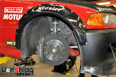

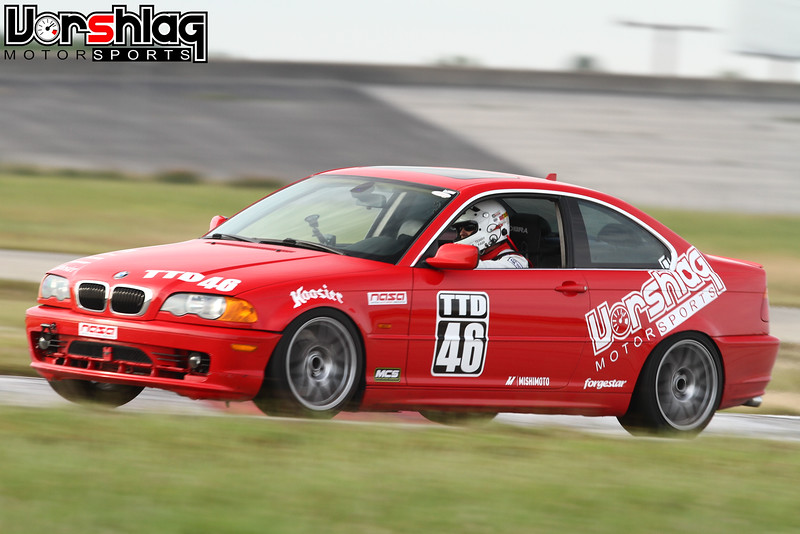

I drive ALL of my race cars HARD AF, and the BMW I raced from 2016-17 (above) was no different. The 330 comes with upgraded front and rear rotor sizes (1.0" larger than other E46 models) but in the first few months of the 2 race seasons I ran this BMW 330, it was running at 3285 pounds on a 245mm Hoosier R7. We were often heavier than that by as much as 100 pounds, and I was back to killing rotors/pads quickly on track. Limited amount of laps before the brakes would send me the warnings that it was "time to shut it down", take cool down laps and come in. Frustrating and expensive.
Good brake pads get costly - you can spend $250-350/axle set on a brand like Carbotech or G-LOC - and we were burning through pads using stock rotors/calipers. But as soon as we upgraded just the fronts to the Powerbrake 340mm x 34mm 2-piece rotors and their medium sized 4 piston caliper on this 330, the brakes became... GOD BRAKES. I'm not kidding, it was shocking how much better they were. Sure, I could spike 1.1g stops for a few corners on the 330 brakes with the most aggressive G-LOC pads, but these Powerbrakes could do it turn after turn, lap after lap, without fail.
Not to mention the brake feel was TREMENDOUSLY better. It made for a firm pedal with no squish, which I later found out was from RADICALLY stiffer caliper that no longer expanded under brake pressure when above 400°F. Why is that? Well aluminum is a low melting point metal (1220°F), but even when above 400°F (easy to get to in racing) it gets a bit "flexible", and expands under high brake pressures at these elevated temps. This means that a cast aluminum caliper can spread apart by .060" or more when hot and under pressure, which translates to a long pedal and worse feel.
The steel bolts in the PB calipers give them tremendous strength at high temperatures

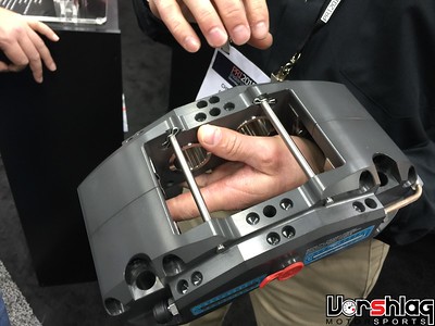

In contrast, all real "Motorsport" brake calipers are not cast aluminum - they are forged or fully CNC machined billet aluminum that gets bolted together. The bolts are made form STEEL, which has a much higher melting point (2500°F) and is MUCH more stable at 400-500°F, long past the point where aluminum starts to get a bit bendy. So when the brakes are hot they stay stiff, rigid, with no expansion or flex. .001" of expansion at peak brake pressures and high temps is common. This makes the brakes FEEL amazing, plus they don't warp and let the pads get a taper.
Motorsport brakes come with thicker brake pads, and combined with more stable calipers and rotors they LAST longer. 2/3rds left after 2 years!
What did this translate into? More braking performance, consistent braking lap after lap, lower lap times, and CRAZY long brake life. We were on the same set of Powerbrake pads TWO YEARS LATER. We ran this car at dozens of events, almost always with 2 drivers. The rotors last a crazy long time, too. The "cost per lap" number gets very good, and by year 2 the 340mm Powerbrake kit already paid for itself in brake pad and rotor savings. So now I want to put Motorsport brakes on ANY track heavy car. And we have...

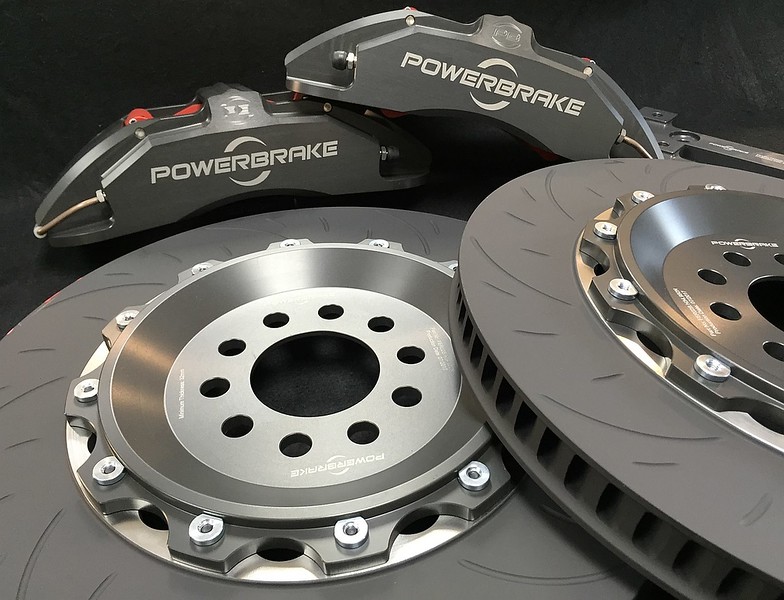

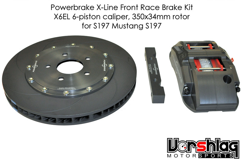

We have worked with Powerbrake to develop several new fitments and have put these on these chassis: E36, E46 (our 330), 86 (our FR-S), C6 Z06, S197, and SN95 chassis cars. Our S550 kit is due in a few weeks and its being built with giant 380x34mm rotors and 6 piton calipers. Most of the previous PB installs we have done were 330mm (light cars) or 350mm (Corvettes/Mustangs). But as they grow their catalog we're always testing new bits with them.
Ferrari specific 380x34mm with 6 piston caliper looks similar to what it arriving for our S550 next month
The costs are reasonable - because South African currency exchanges well to the USD.This removes a bit of the sting for the cost aspect. We're seeing lifespans and performance rivaling the top Motorsport brake brands (Brembo Motorsport, AP, Alcon, Stop Tech Trophy) with a significant discount. The rotors are cast in Italy and these + hats + calipers are all machined in-house at Powerbrake S.A., with very high quality levels. But just like with Monotubes, some people have to SEE and FEEL these first hand to believe its worth the cost. The first time Jon here at Vorshlag drove our 330 with the Powerbrake BBK he was shocked - and also an instant believer. I've taken people for rides who come out wide eyed.

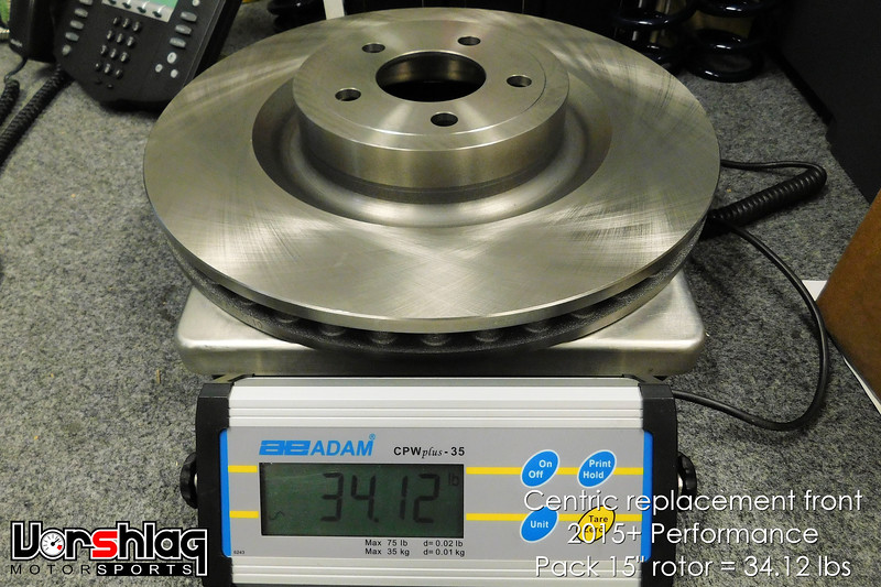

Left: Powerbrake 2-piece 14" S197 front rotor = 21.5 lbs. Right: S550 14" OEM front rotor = 28.4 lbs
The difference between Motorsport brakes and the stuff the OEMs are putting on even their top performance models is still vast. The cast calipers we see on the top Mustangs all get flexy and have worse feel, wear, etc. The weights of the bigger 1-piece rotors is up there, and the weight drop we see going UP in size to a BBK can be significant.
I wish I had a time machine to go back and tell me in 2010 to NOT push the limits of cast Brembo calipers and rotors that were too small for the use we had in mind from 2012-15 with our car. I just didn't know any better, wouldn't open my mind to the costs involved with a brake system upgrade, couldn't fathom I'd get hurt from a cooked set of brakes. Again - maybe you can learn from my mistakes.
This test day I drove 3 cars with Powerbrakes - including Jamie's ST3 Mustang. They were so good I was pissed...

We upgraded to these 14" 4 piston Brembos from the base 13" 2-piston brakes on my black 2013 GT (above) and found a big drop in lap time. We also had real brake cooling up front, good pads, and good fluid. And we only ran that car on street tires. So while it took our entire array of brake system tweaks to make them work with this 2013 GT, it did well even on our local tracks that are tough on brakes (ECR). It was well worth the cost, and worked for the tires and uses in mind for that car.
We had 14" 4 piston brakes on our S197 (left) and S550 (right) and over-worked them on both cars
Those of you on Hoosiers, or in heavier/more powerful S197s on wide "200" treadwear tires might still be out-driving the limits of these 14" brakes. We did that for 4 years in our S197 2011 GT, and we're doing it again in our S550 2018 GT - just with stock power and only a 305mm Bridgestone RE-71R. So we're upgrading to real brakes before I get killed. ;)

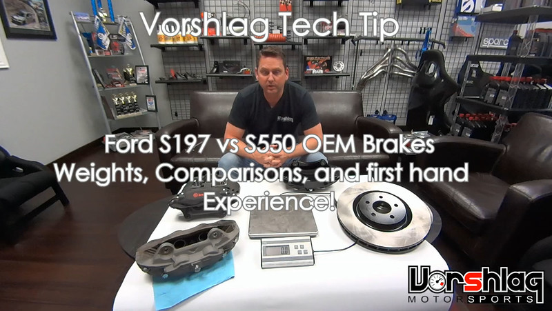

Vorshlag Tech Tip Video: S197 vs S550 OEM Brake Options
The video above summarizes much of this post in a 12 minute video - with lots of side-by-side comparisons and first hand experiences. We show weights of calipers and rotors for various OEM S197 and S550 options, as well as the Powerbrake calipers and rotors. Worth your time to watch.
