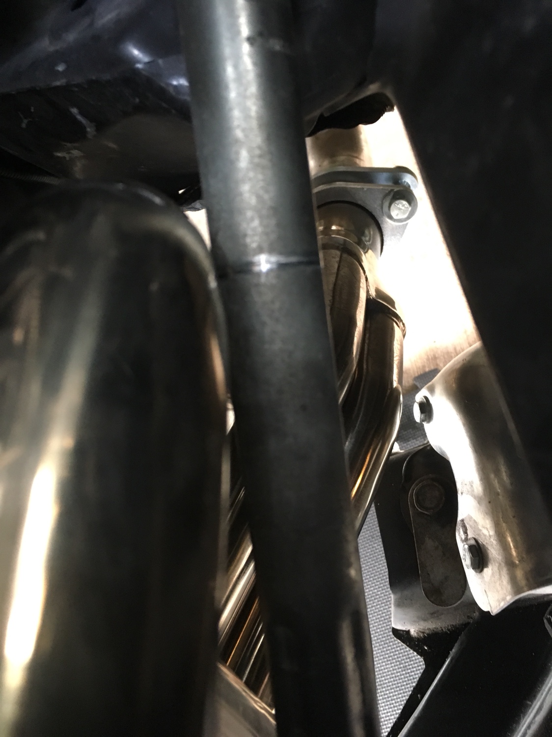

So looks like the driver side header rubs the steering shaft during hard cornering:
I shifted the engine as much as possible towards the passenger side and standing still and going straight it doesn't touch at all as I have someone turn the wheel while I checked.
But looking at the markings it must be while making left turns the lean must cause this.
Any ideas for more clearance without pulling it out and making a ding on the headers?
Wes06
Jan 21, 2012
5,383
59
You can ding the headers pretty well without affecting performance. Lookup motortrends video on them doing it
No I know that I just don't feel like pulling the headers out to do so.

I'd more expect engine rotation on its mounts from the torque reaction to be the cause of contact between a header tube and the steering column.
