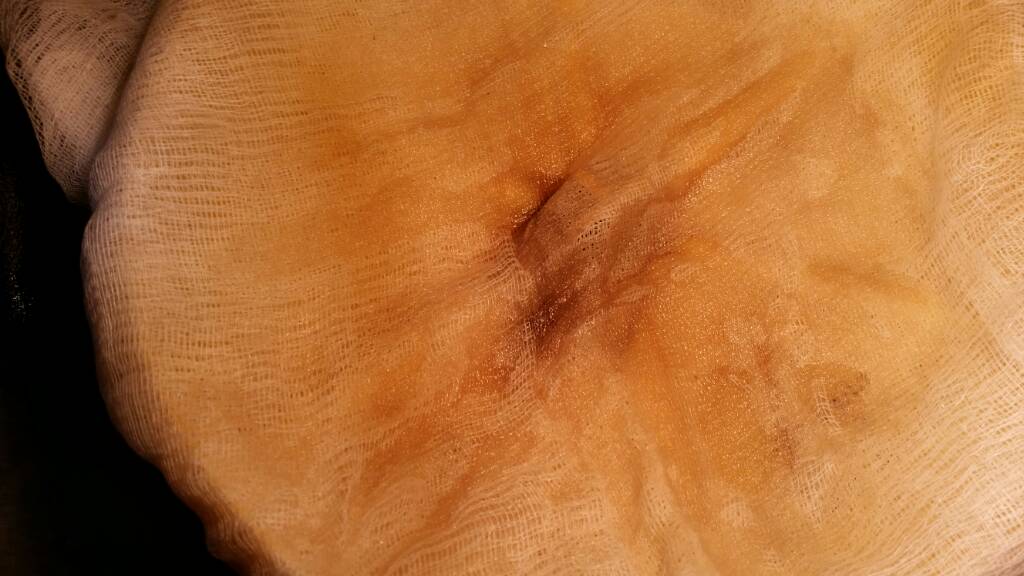

I'm waiting for the oil to drain fully through some cheesecloth so I can eyeball any droppings. I'll check that and then settle in for a pats win. Checking the trans fluid level can wait till tomorrow.

The drained oil looks good, nothing but net. This is after both the pan and filter contents were dumped through it.
Spun a new filter on and filled it up with a fresh load of oil. Will give this round 5k before doing it again.

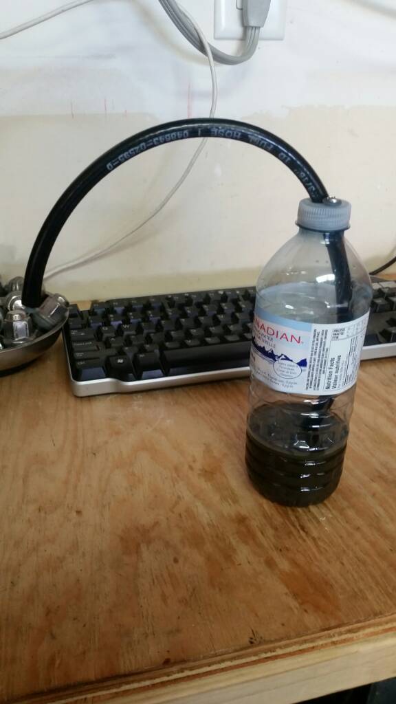

Finally, bled the ABS module and the rest of the brakes, enlisting the help of a local 12 year old to pump while I cracked the fittings and checked for air. Took almost a pint when all was said and done - might have been a little less but I let it run clean after some dark fluid came out of the left rear.
Ten bucks to the kid, and nothing for my home made up-cycled bleeder jar.
