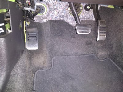

Got this from American muscle, I know it's an automatic and there decent pedals, but the clutch pedal probably sits higher most likely then the dead pedal.
Most of these seem to be pretty much at the same height as the OEM hump, is that right?

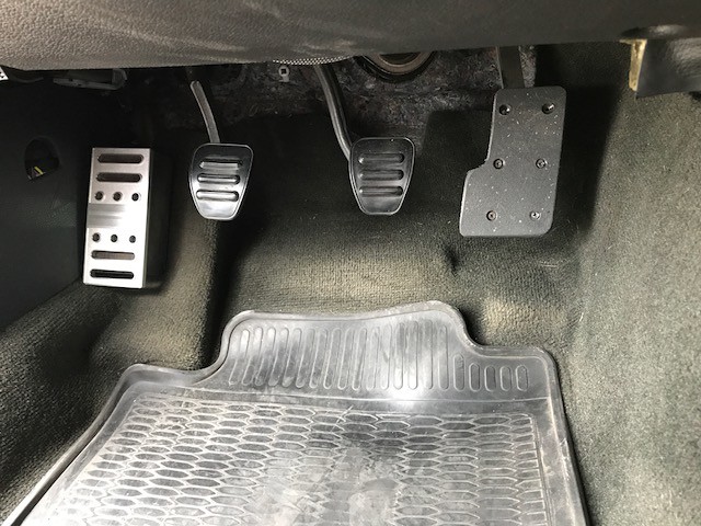

I have the Roush dead pedal and I put 1" standoff spacers between the floor and the pedal. Nice thing is you can get the standoff spacers in various lengths at most hardware stores to fit your comfort level and they are inexpensive.
