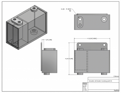

Going over to all a/n for the rest of the pcv, this is the bubbler I'm customizing.
Separator reservoir has one side for a circuit from this bubbler, back up to the elbow before the blower and after the throttle body. The other half is just a drain can for the provent. Shouldn't need to drain this very often.
https://a360.co/2Enl4bV
