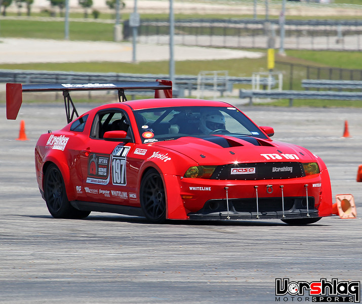

You've gotta do a flare to make it right. Car in picture has 345/35/18's in the rear, 335/30/18's in the front, all on 18x12 wheels. The 345/35/18 has similar overall dimensions as a 345/30/19. The picture is during a left turn so the fender is rolled out a bit on the right hand side of the car.
You *can* get 345's on a 12" wheel under stock fenders, but it rubs the SHIT out of the inside of the wheel well.

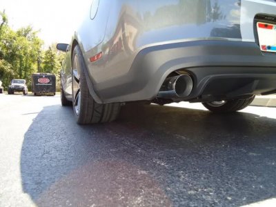

This is a 325 30 19 on a 19x11 with no issues. The 305 30's just look too small to me.

You say no issues. I say lots of bulge.
I suppose it depends on the application.

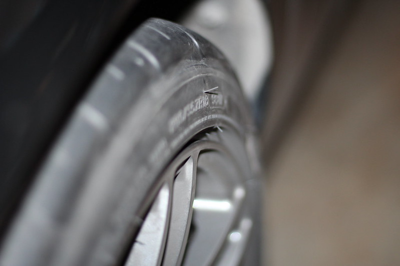

My Nitto NT-555 285/30-20's are perfectly flush with my 20x10's. This is about the best photo I have of the sidewall. As you can see they run really narrow and thin. Ended up lowering the car again after I got them mounted because there was so much fender gap.

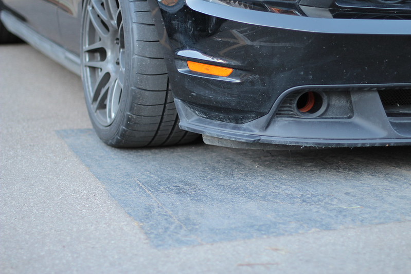

I have 305 nittos on 20x11"s. Pretty straight sidewall, another 40mm of section width would be a pretty solid bulge.
Edit: Did some research, go with a 325/30R19 if you already have the wheels. The measuring wheel for the 345 is a 12", which means it is a bunch wider than the 305's that I have, as the measuring wheel was an 11".
And for nittos running narrow, it's not that they run narrow, you can't lie about numbers. The measuring wheel is a much more important piece of info that people seem to ignore. A tire on a 10" wide wheel will measure smaller than if you mount it on an 11" wide wheel. Depending on the tread width, it could be a reasonably big difference.
