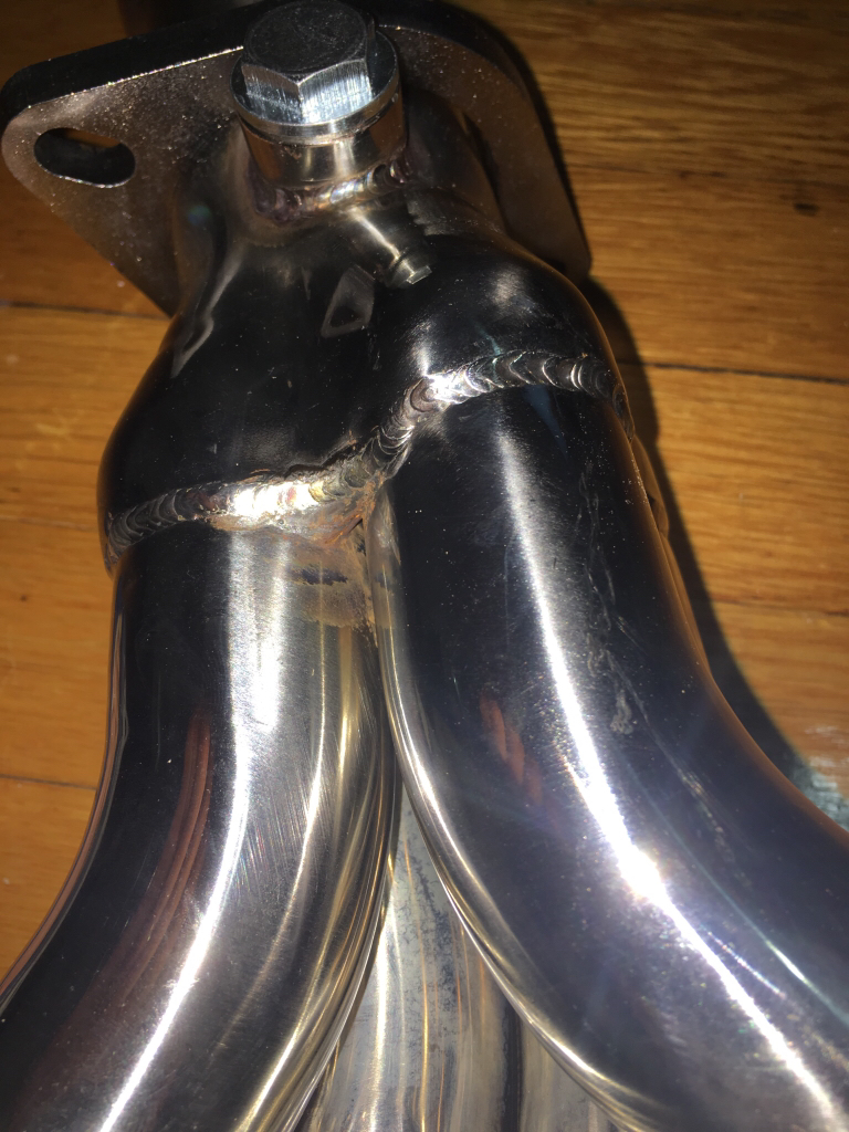

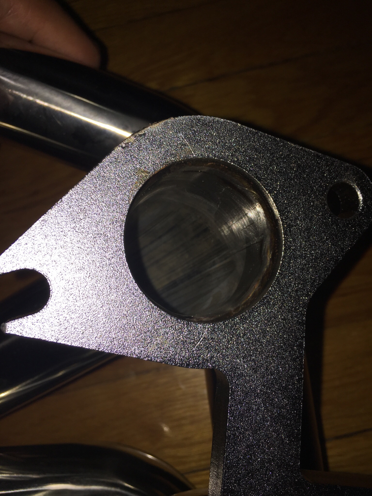

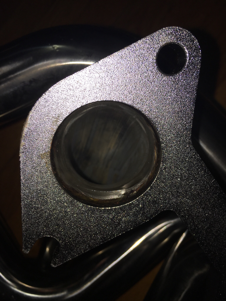

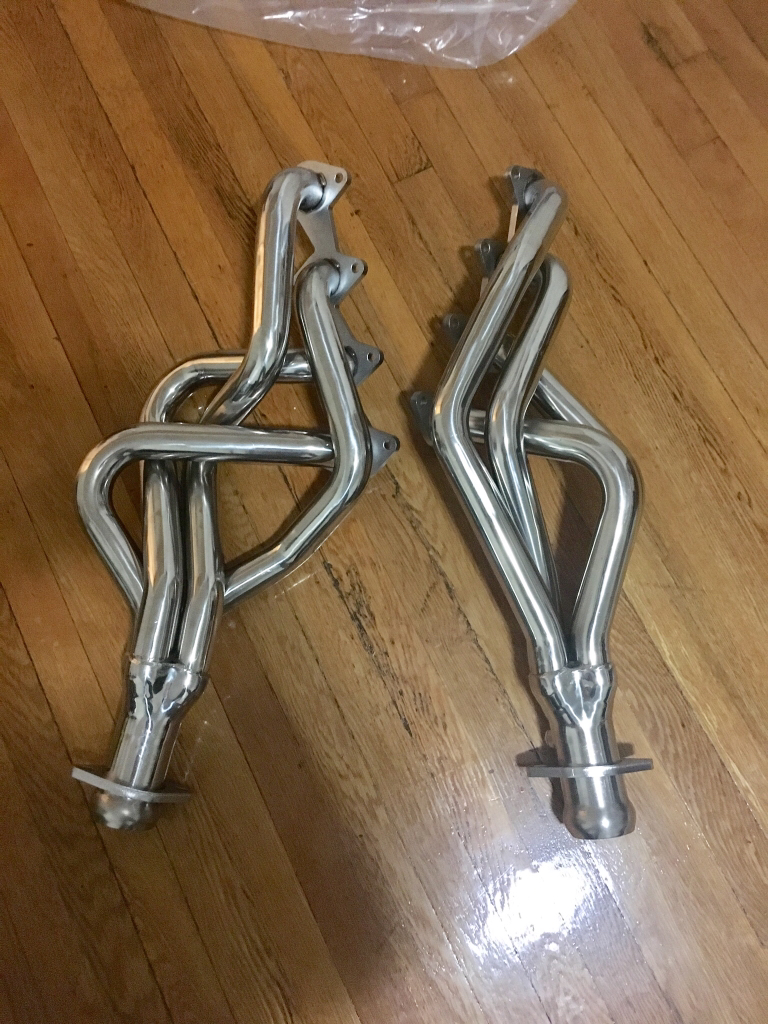

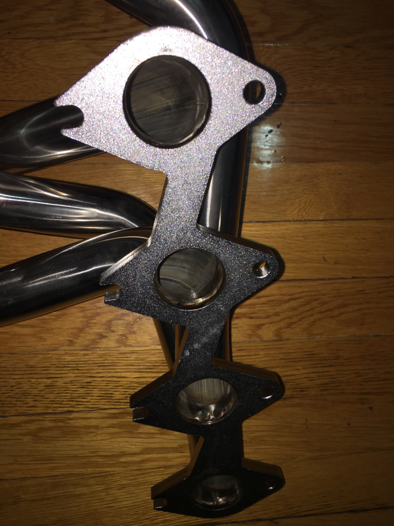

These are Kooks or Pypes copies and/or probably the same manufacturer for Pypes without the mark up.
I bought them from eBay for $165 shipped and it's been just sitting for over a month. Not sure when I'll be putting them on.
Damn those actually look quite nice.
