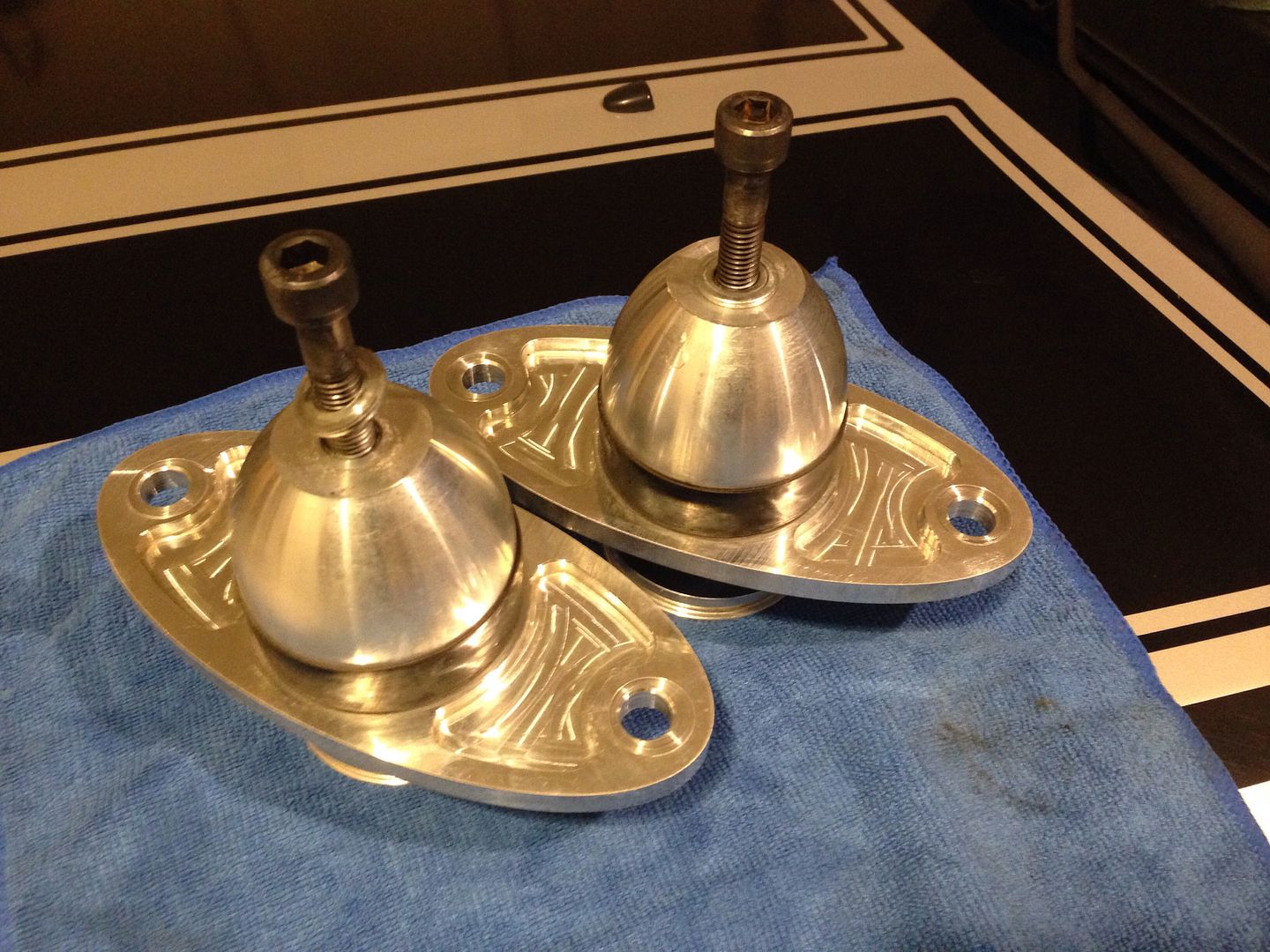

I had these on my car until I swapped in a K-member. These were too tall to use. Never gave me any issues. I think I gave them to someone on here.
