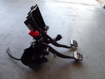

Do youself a favor and remove the drivers seat(be careful with removal and reinstall, the seat brackets are sharp, and took two small chunks out of my sill plate).
Under the dash, you will have limited access to the 4 nuts, 2 bolts and various electrical connectors. Not fun, but do able with extensions and a u-joint socket.
Be ready to make a mess when you disconnect the the clutch master, have plenty of shop towels ready to go, also have a vacuum cap for the brake master cylinder nipple(I did not initally, and it made a huge mess). Also try not to lose the clutch line clip, you might need it later(I did).
With pedal assembly removed, swap out the clutch masters.
Removal took me about an hour. Clutch master swap, clutch pedal cover swap, losing the clutch line clip, fml!, a short break and re-install took about two hours.

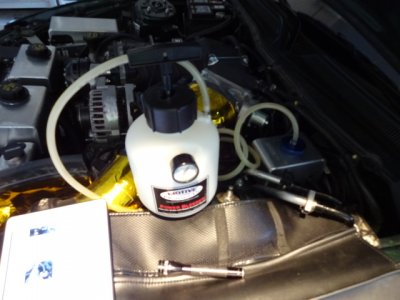

Used my Motive vacuum bleeder to bleed the master. As always, I have the misfortune of the cap blowing off, spraying brake fluid everywhere and me going into oh shit mode trying to clean it all up asap. After extensive clean up.

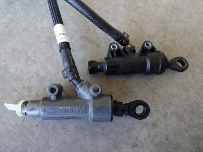

Pics for install post. Quick life hack for anyone doing this swap, tie a safety line to the clutch line clip! I had to use sewing thread, but fishing line would be ideal.
New clutch master comes with a new clip, i dropped mine during attempted install, luckily i had the one from the old cylinder, or i would have been shit out of luck.

What is the difference with the GT500 master cylinder? interested as I've been dealing with my shitty 3650 and it's "NO I WONT SHIFT THERE" for years.
golkhl
Feb 12, 2010
4,365
2,733
Las Vegas, NV
I have read online that the GT500 master moves more fluid, but i do not know the specifics as to how or why. A couple of other members on this forum have done the swap and i decided to give it a try as a last ditch effort, as my car was not wanting to shift at high rpms. Pedal feel is about the same, but the engagement point is a little higher. Install was a bit of a p.i.t.a, but well worth it.
