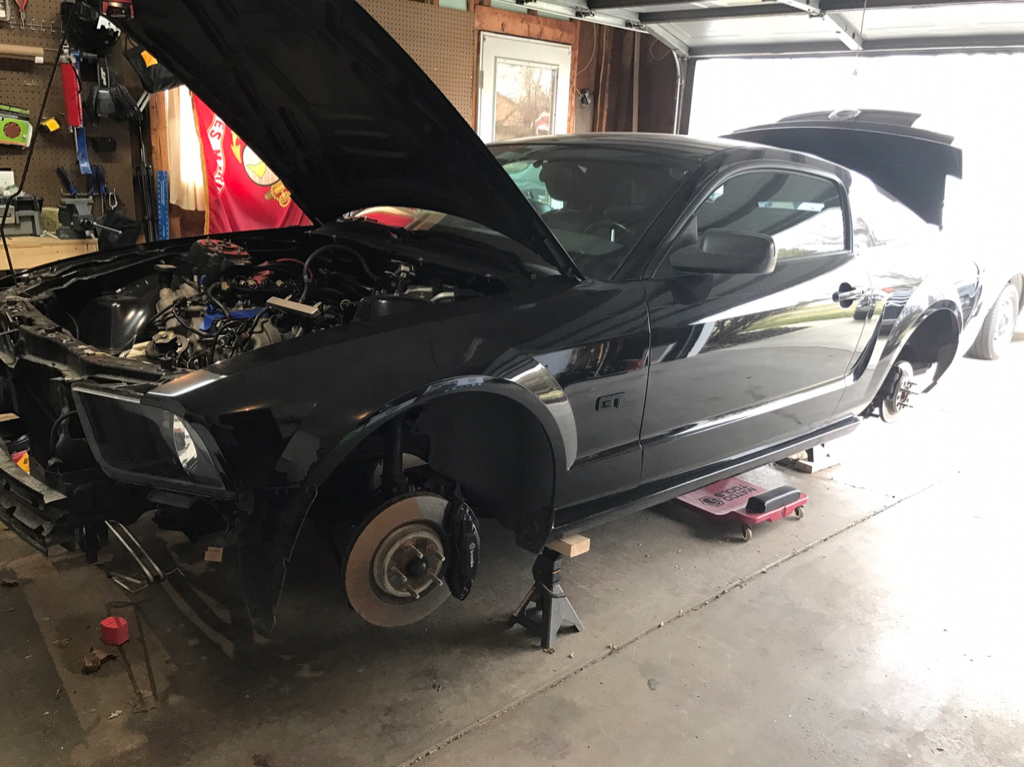

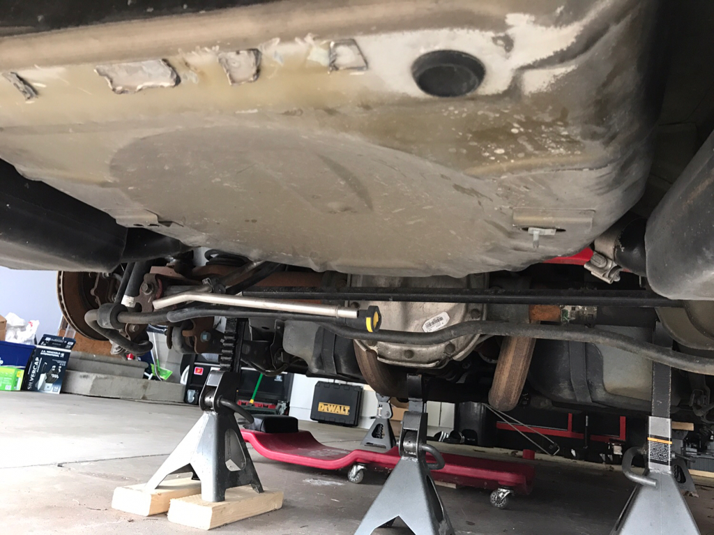

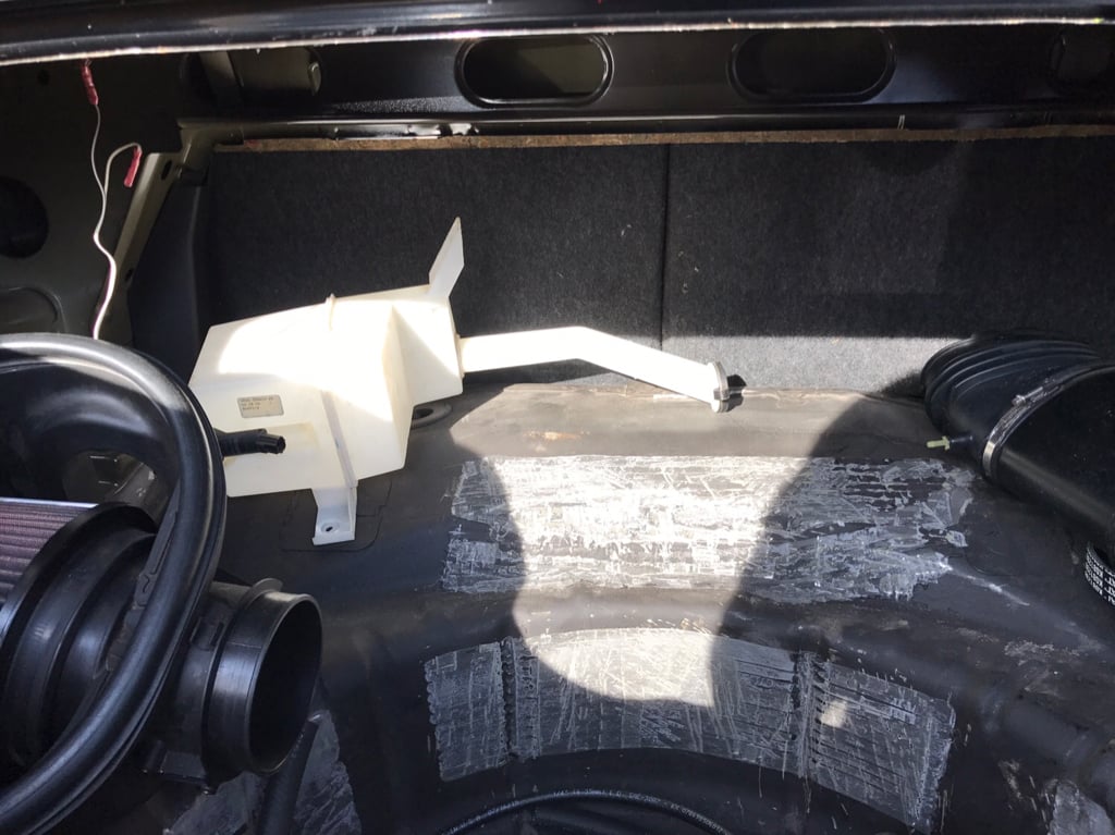

Weight reduction!!
- washer fluid tank and pump removal (done)
Rear Evap canister and company deleted!
Sound system deleted. No speakers as well!
Sound deadening crap scrapped out. Much more of their to do but you get the point. Also in this picture is some of the DOB kit I'm piecing together.
Weight Reduction yet to do!

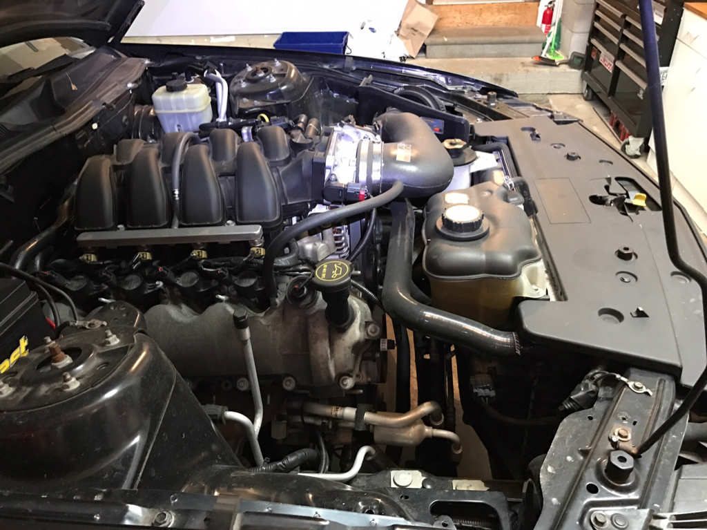

Ok. I know a supercharger isn't ideal for a road course car. I know, but boost is a lot of fun so that's what I want. Heat is greatest enemy to a road course car so Im focusing on the cooling of the fluids and thus the IATs.
Upgrades to the DOB list of parts
-'13 GT500 HE
-'13 GT500 coolant pump
- coolant lines to match
- larger radiator (haven't decided on brand yet) also not part of the supercharger kit
- 8 rib belt system
- new motor mounts
- GT500 fuel pumps with hat
- GT500 Fuel rail ( not sure if that's an upgrade or not)

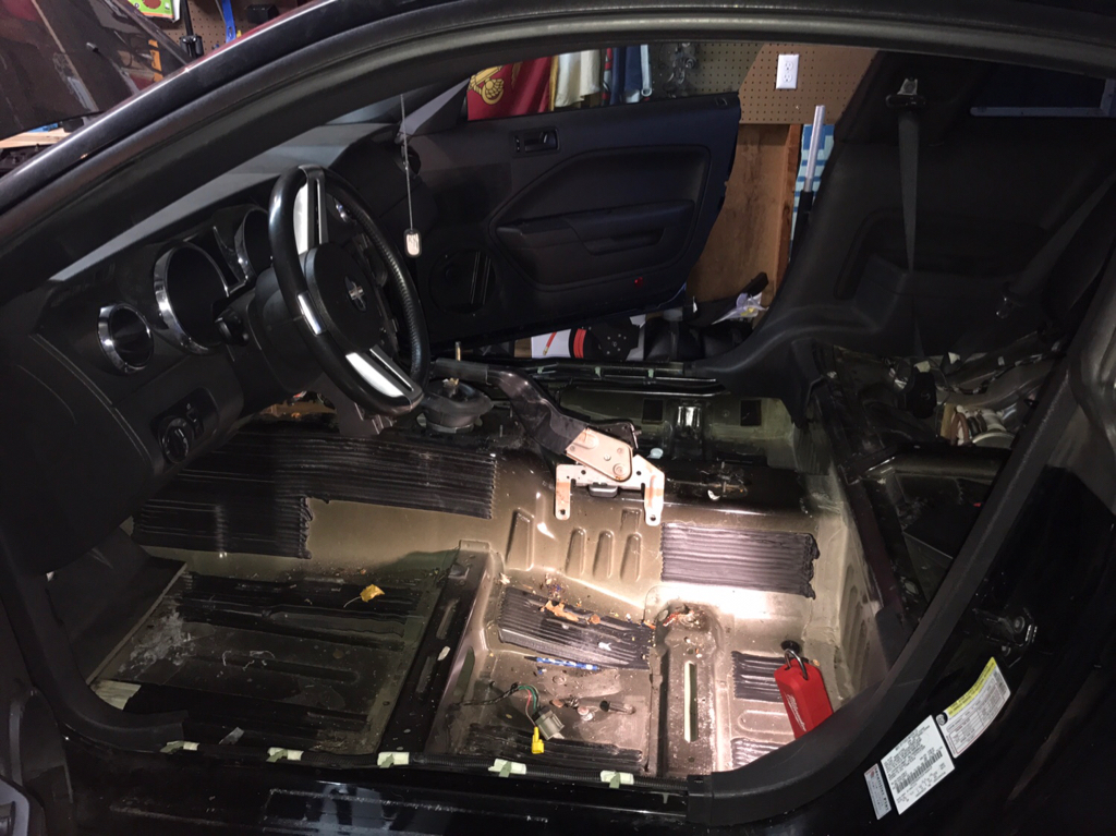

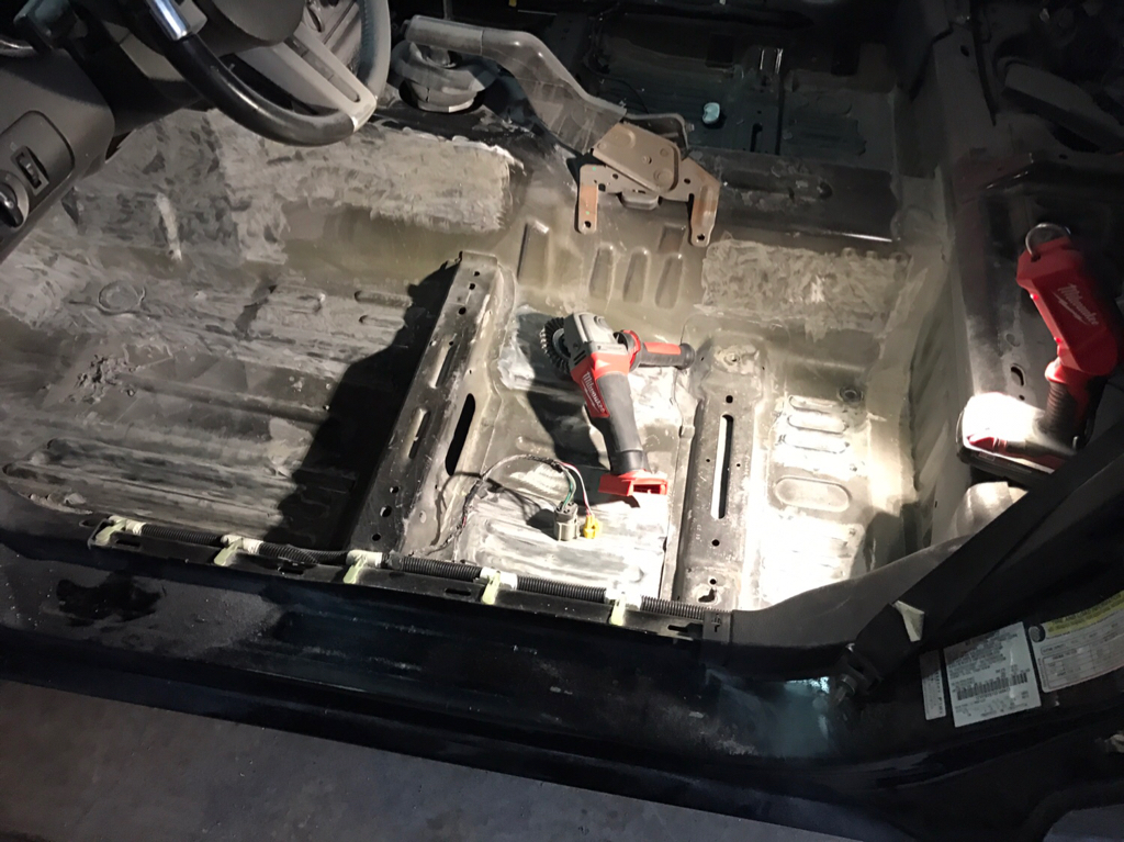

Stripping carpet (for now) and grinding and chipping away at the sound deadening crap.

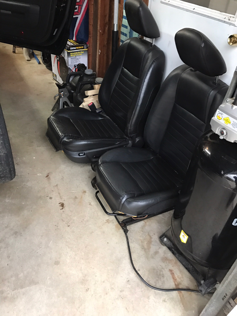

Yeah these are some heavy bitches! Going to put lightweight seats high up on the to-do list.
Anyone have recommendations on lightweight seats? Don't have to be that comfortable since I only drive the car 200-500 miles a year.

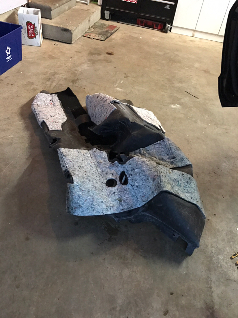

Michigan
Well this crap came in at 20.4 lbs. don't think I'll be putting it back in. Maybe some aftermarket cheap stuff that weighs less.
