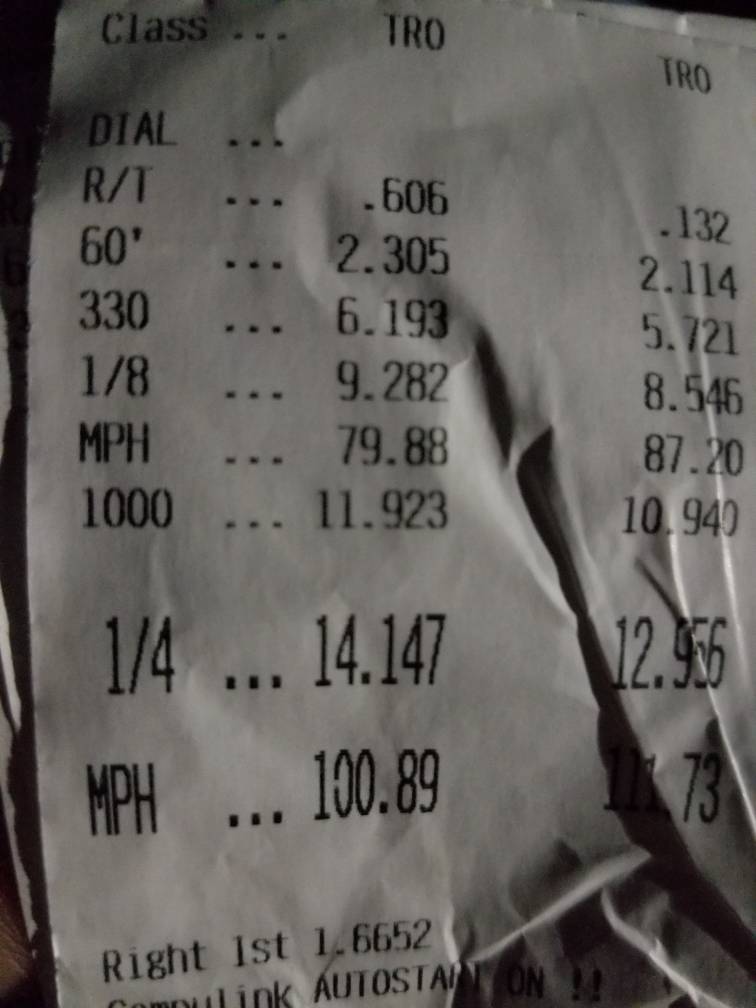

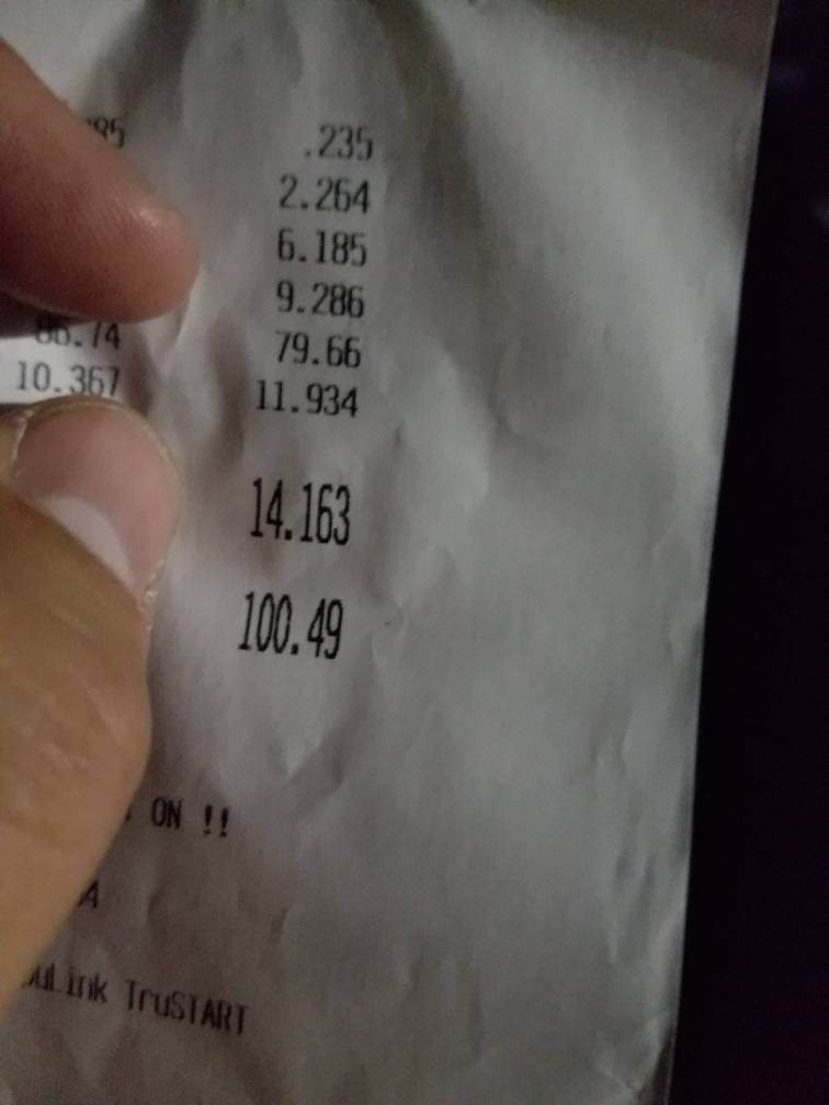

Had my first night after cams. Thinking i need those 4.10s installed before i go again.

Hey it's all good. Dude you trapped over 100, that's great.....but look at that 60'. You need to get out of the hole way better.

Ya dont think i was spinning but couldve. With the cams it is real weak at the start of 1st then i hit 3k and take off

Mmmmm automatic, that's where my advice runs low....If you were stick I would have some clutch slipping advice. You need to foot brake it or something so you leave the line above 3k or right where the limit of traction is. Where you foot braking it?

1 run i did the other i didnt. I cant get much over 2k with the stock converter.
Just looked. Previous best basically tune only was 13.6 at 101 [emoji58]

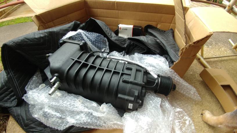

Forget the gears and converter. Get that DOB ASAp. You are not the only one considering a DOB. Here is my Eaton M122 I picked up after a long search for a decent deal......it's motivation right now. One day I will make that call to DOB and it will be a great day !

Me either.....but I take it one step at a time. You can get an Eaton m122 for 350 if you have patience. There is no other way but for me to build my DOB kit than one piece at a time.....seeing that Eaton gives me motivation. Next month I will start working deals on injectors.
