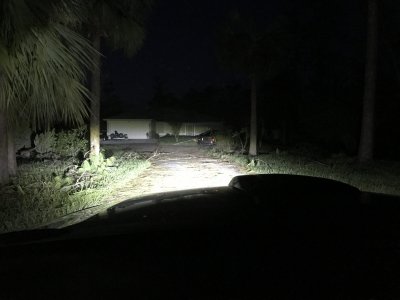

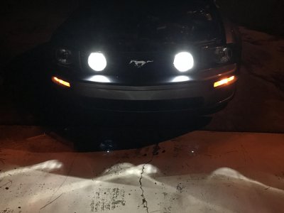

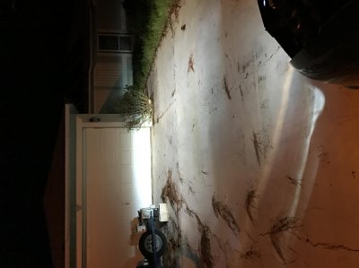

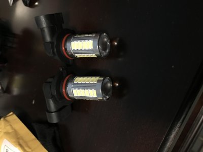

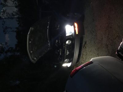

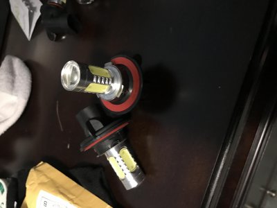

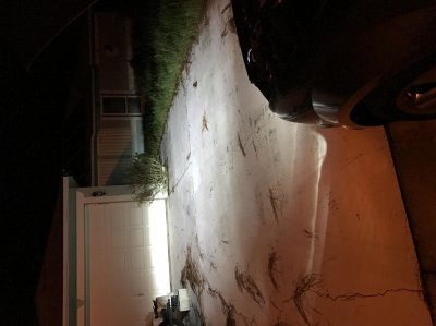

Alright thanks to Irma-geddon I havent been able to experiment more or post. So I bought a new set of headlights and a set of led fogs. Both have leds on the sides and a few under a "projector" lense on the front. The pictures will follow as mobile wont let me post pictures directly into a thread.
Moving on, so I installed one headlight first with the other led light that I wrote about earlier. My whole theory on the projector was a toss up. I thought the projector would spread out the light and then the cob chips on the sides would suppliment the light output by also filling the reflector bowl with light. But on the other hand the leds under the projector dont have a cutoff shield so I thought it could also project light all over the place, including up towards drivers eyes. In one pic you can see they look pretty identical looking right at both but as soon as you look at the different beams you will notice the new bulb doesnt put out the light the old led does. Attached are some pics for comparison and one from outside my neighbors house where I do all my testing. I wish I took a pic of the street from the drivers seat like I was driving, it was like someone glued a keychain flashlight to my bumper thats how bad the light output was. Also the light was projected everywhere as I predicted. In short, these were a fail. Luckily though the seller gave me a full refund and even asked how he could improve their design. Will he take my advice I dont know and frankly I dont care lol.
Now on to the fogs. Another ebay special that looked similar to the headlight bulbs so I didnt expect much better performance. Well the idiots who designed them didnt realize they are polarity sensative so they only work if I plugged the connector in backwards! As you might have guessed the bulbs would not fit with the plug on backwards so I couldnt even test their output. Oh well, at least they also gave me a full refund.
Anyway I did buy another set of fogs that are of a different design that I cant wait to test soon. They look better in terms of design and dont look too ebay-y lol plus they did cost a few dollars more, hopefully for good reason. The only thing Im leary of is that this design has an led attached to a flat piece of plastic or metal, sort of like what the power steering fluid dipstick looks like on a small block ford. Well there is either one led that lights up both sides or each side has an led. Anyhow, my concern is that being mounted where they are and with there being this "stick" there might be blind spots. Its not like a bulb that has no obstructions because the filament is surrounded completely by glass. Im not too worried but I have my doubts as to how its going to perform.
Next time I think Im going to try a similar design for my headlights or as previously posted there is a design Ive seen where the leds are positioned about where the low beam and high beam filaments are on a corresponding halogen bulb. It should perform more like stock.
Im open to suggestions and if anyone wants me to test any particular design or send some funds my way dont hesitate to lol. Also Ill try to keep the pics in order. Enjoy.
Edit: I dont know why but the pics uploaded in reverse order of my thread... also the drivers side is the one I replaced with the new led in the pics if you couldnt tell.

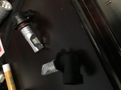

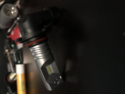

Onto the next adventure! The new foglight leds came in the mail today. They are of a different design I have not tested yet. They look like an led on each side of a flat piece of metal but theyre slightly recessed. Following will be pictures so you wont have to use your imaginations lol. They look to be of good quality but my concern was with them not having a heat sink, and if they were wired in reverse like my last set lol. To my amazement they were wired correctly and work!
Once I got them in and turned on I critiqued them thoroughly and honestly I really like them. The cutoff is really sharp and they put out light in a uniform manner. I was also concerned about a blind spot because of the way the leds are mounted but that was quickly disspelled when I turned them on. They are brighter than the factory bulbs but they id not blind me when I stood directly in front of them at varying distances so they most likely wont glare. As you can see in the pics that there is a nice color difference like when I switched out my headlights. Theyre a nice clean white. Going back to the heat sink, I dont think it will make a difference but it may shorten the life of the bulbs. I used to almost always use my headlights and foglights when it was dark because I love the look but I think Ill refrain from that for the most part. All in all Im happy with my $11.29 purchase, I would highly recommend them. If anyone wants a link to the ones I bought Ill post it.
I think next time Im going to swap out the headlights a similar designed led as these foglights.
Attached are multiple pics of one stocker with one led, both leds, just foglights, fogs and headlights, drivers seat view and in front of the car. My phone does not take the best pics and Im no photographer lol. Enjoy.
