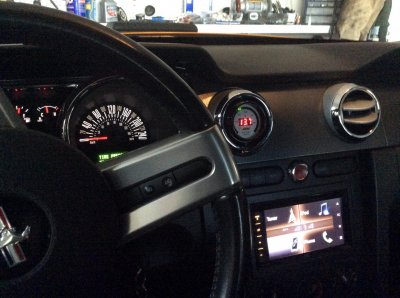

Roush vent pod with PLX gauge:

That looks dope!, how do you find it for viewing?. How did you run your sensor to the bung?

Run it through a grommet behind the wheel well guards in near the pedals through the firewall.

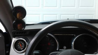

3 guage A pillar pod here. WB, oil pressure & temp. My 4 guage dash has only oil pressure light. With 40 minute open track sessions, I wanted to know oil temp too.

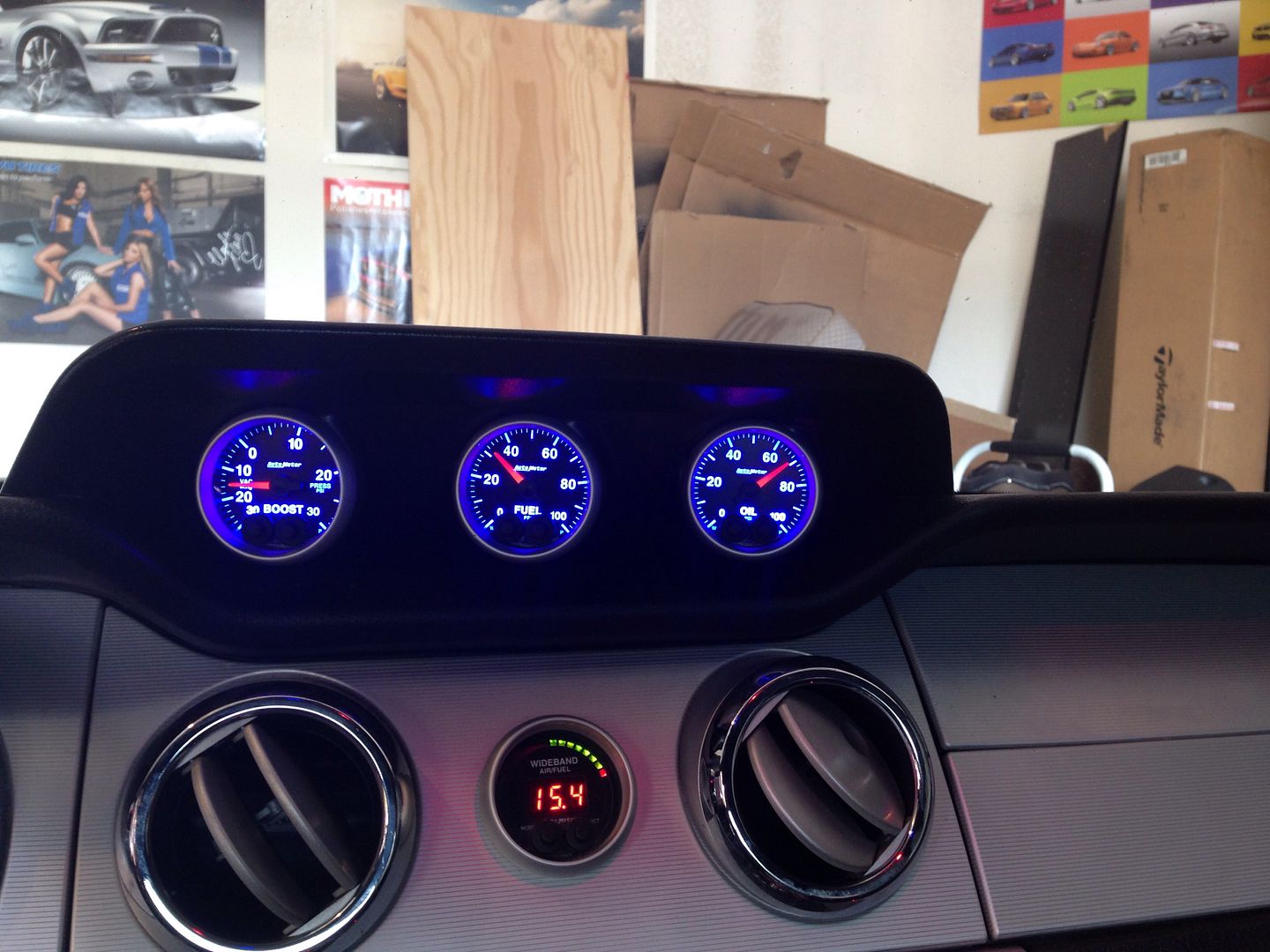

I just took a 2" hole saw to the center of my dash. Then used a dremel to widen it out to the proper size. Couldn't find the right size hole saw but this way I insured the fit would be nice and snug.
