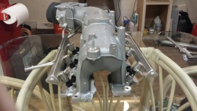

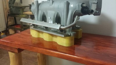

I bought a wrecked 2012 a while ago and while putting it back together the manifold was trashed so I decided to do a little modding. This manifold is from a Taurus and uses spacers with the injectors built into the manifold legs. Ive replaced a bunch of harnesses and slices here and there and got very lucky and it started first try. Even had it round the block. Idles well and is very smooth. I am using a Gt throttle body and so far it works fine. Still on the stock tune but it throws no codes. Need to dyno it some time in the future to see how it does but I have some more details to sort out. At least it works, might not be all that for NA but will be great with a procharger or a turbo.

I made a pull and was at 277 hp but the tune has some issues. Hope to have it sorted out this week. I should just take it down to Evolution and have it done right instead of the data log and wait method. I need t I chase down an exhaust leak and redo the fuel trims. It runs very well though and the power curve is great and loves to rev.
popeye
Feb 1, 2009
440
The manifold r Rea llc changed the whole character of the engine. I drove a 3.7 back to back that had similar mods and the difference was drastic. Sound and the way it pulled was completely different. When I sort out the tune and do a set of rear gears I hope to find a test and tune night somewhere. But I very all I am very happy with how it came out

it really came out well and is begging for some kind of FI.
