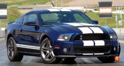

What do you all think about the stripes ?
Sent from my iPad using Tapatalk
mustang_cobra
Jul 10, 2013
35
That's the color blue for stripes to tribute the donor car
