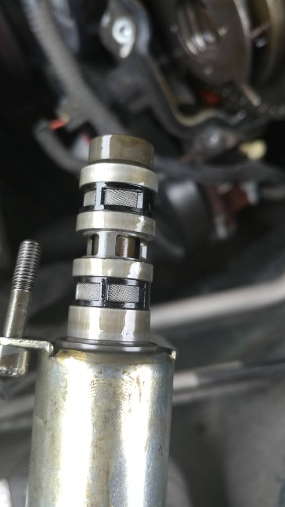

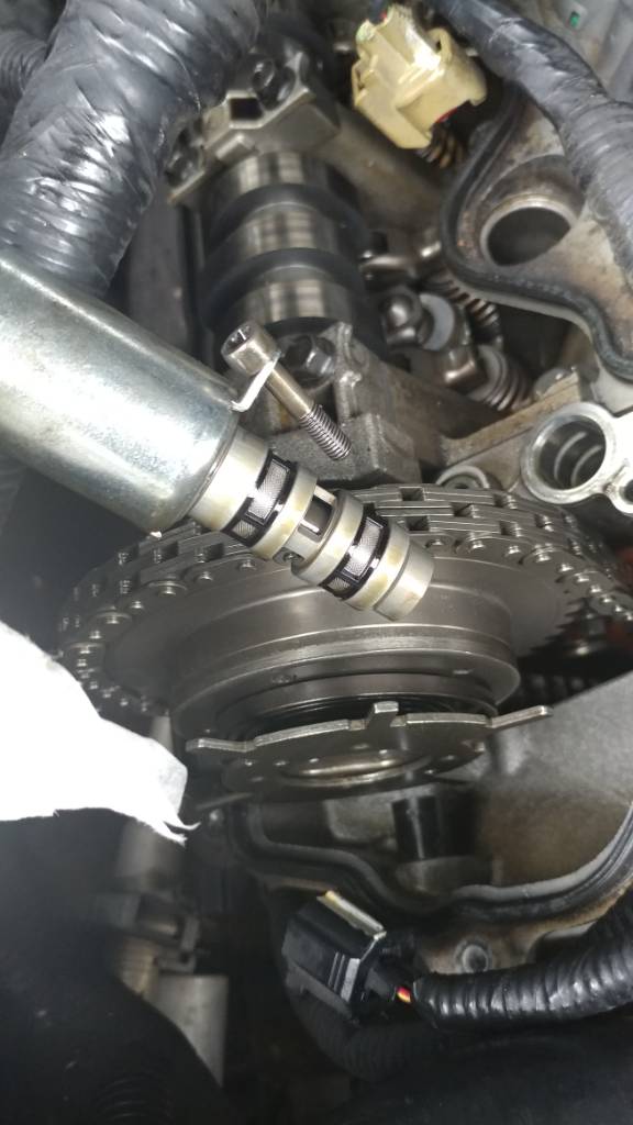

So last night I popped the valve covers off expecting clogged VCTs..... inspection revealed great looking VCT solenoids. But after reading a TON of threads on the subject this fine morning.....many folks said go to the basics and check your oil pressure at idle @ op temp (remember the VCT work off oil pressure) . Also, they say, pop a cam cap off just for giggles.....well giggle I did not. This 3v is fucked sideways.

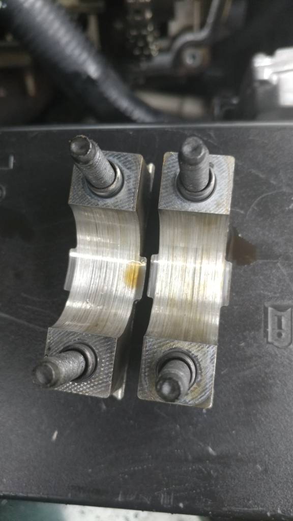

Guess I don't need to check the oil pressure.
My question is......what should I do? New heads? Longblock? The car has 185k miles on it and was running STRONG. Very strong for a CMDP, off road dp, and a VMP tune.

That crossed my mind...but you are saying....get new heads or slap it back together? I need to get whatever is causing the VCT to stick retarded....think it is the solenoids? That would be an easy fix and cheap and get me at least running decent.

Also, the last test I did, I unplugged the VCTs. It ran great untill in got the rpm up/throttle up and then it was like the cams got stuck in retard and was running bad again did not think that was possible with the VCT unplugged..... Shutting the engine down for a few min would solve the problem VCT unplugged or not.......with this info, what suggestions do you have for me?

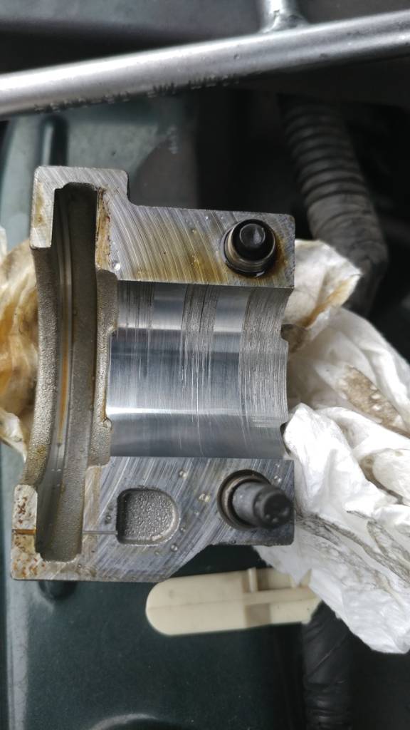

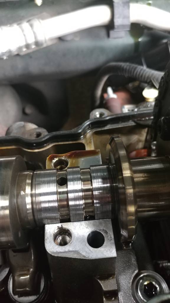

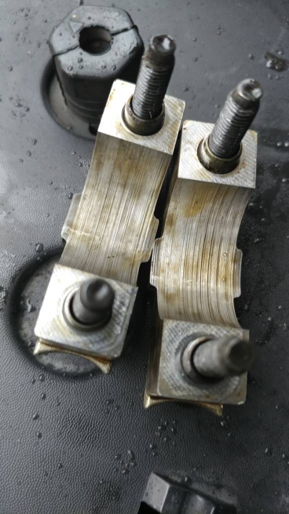

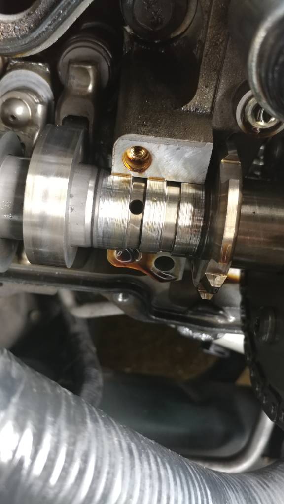

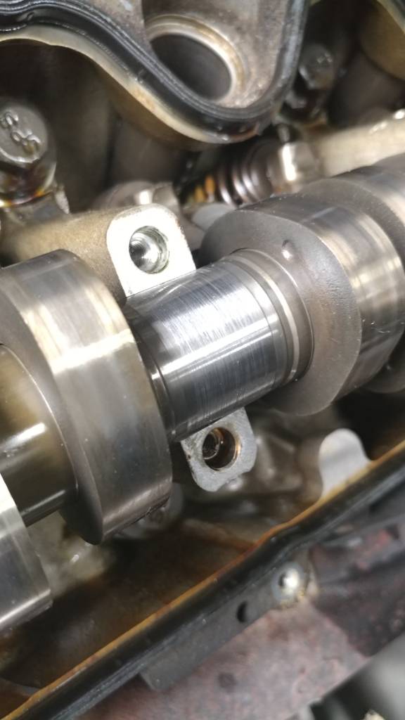

Anyone want to take a stab at what caused this? Both banks exact same damage.
You think just lots of miles combined with me beating on it? I loved winding the engine out on country back roads. My private road course. It was probably shifted at red line at least once a drive since I have owned it. Then about once a month I would take it to a winding road where it literaly was my private road course. When I was done the brakes were mush and smoking. That kind of driving. Like a road course.
I guess that's not a good idea on a high mileage motor.

That's some major damage and it's hard to believe there isn't damage to the bottom also. I can't really think of something that could cause that kind of damage, it almost looks like someone put something in your oil.

What was your maintenance routine? You can drive a car hard as long as you keep an eye on things. Mine sees boost pretty much every time I take it out. But I also give it a once over before and after I drive it. If you're driving it as hard as you say you are you need to be on top of things. Especially the oil level.

I think you've hit the nail on the head. The engine damage looks like it's due to oil starvation and there can only be two possible causes: low oil level, or worn oil pump. At 185k miles and driven hard, the engine might have slowly been burning oil and if you didn't check the oil level often enough, it might have run critically low.
Whichever way you look at it, that engine's f***ed.
Tire pressure and oil always checked before going on a spirited drive. Oil level is perfect. 1500 miles on Penz platinum 5-20. Changed every 3000 miles. Ford filter.

The heads are for certain. They are scrap. Short block should be good. Rods were not knocking so it should just be just a crank polish and new bearings.
