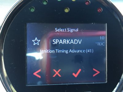

I have done some research but couldn't figure out why if my limiters are 20 degree max then why an I seeing 30-40 on my nGauge?

Are you sure you're monitoring the correct PID? It's 20 degrees per cam, for a total of 40 degrees of cam timing. I see 3 on my Livewire TS, two show individual cam angle, a 3rd shows overall cam timing. If the phasers fail, they should slam against the stops with the rotation of the motor, thus they would be at 0 degrees or "fully advanced." If the spring somehow failed, and they free-floated, then yes there's a good chance you could have PTV if your lift or CL are aggressive enough. My old Thumpr cams called for limiters, but the cam specs indicated they'd never hit PTV unless cam angle were commanded outside the range of its performance anyway. I suppose it was just a safety precaution for the VCT system over-shooting the desired cam angle, perhaps. During normal operation the vast majority of cams will be retarded greatly, optimizing fuel economy over performance. During WOT, the low end demands advancement, I typically see 0 degrees until around 4k/rpm or so, then the cams start retarding to optimize the top end. Usually around 10-14 degrees of cam retard is good performance, depending on the cam specs.

That's not cam advance that's spark. Completely separate

OK, Thanks. I didn't see anything saying cam advance then. I'll double check next time I'm home. I'm sure that I need to learn more about what my nGauge can see and how to change it. I'm sure that there is stuff it will do and that I don't have a clue.
