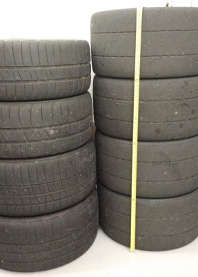

That works out to just 24.73" in diameter. You just effectively lowered the car by 1.25"...
Yeah, I know how it works. Lowering the car for autox is good. Lowering the gear ratio (higher numerically) is typically also good for autox, unless he is running out of 2nd gear, which is typically not the case.
I've run both 295/30R18 and 315/30R18. Yeah they look small (diameter wise) on the car but the point is to be fast. Its not a styling competition.
275s are not enough. I'd argue that 315/30R18 A7's are not enough.
Just so you know I'm not just talking out my a@@ I attached a pic of my tires. 315/30R18 and 265/35 + 285/35 Rivals. The Rivals are good if you need 200+ treadwear tires but compared to the 315's they are slow.
I don't have any first hand knowledge of RE71R's, never ran them.
