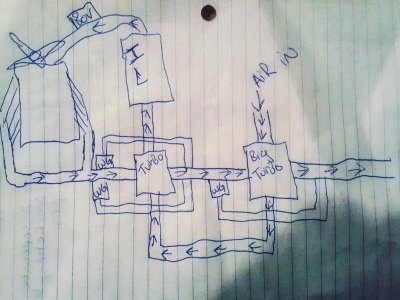

This is what i was thinking....
Little backwards. The smaller turbo (LP-Turbo) drives the bigger turbo (HP Turbo) through the inlet of the bigger turbo. This feeds air directly into the inlet side of the impeller and into the motor, while at the same time spooling up the bigger turbo. Once the pre-determined boost has been achieved, the LP-Wastegate opens up, bypassing the LP-turbo and feeding the hot side of the HP-Turbo, which is already pre-spooled by the LP-Turbo. The HP-WG will control final boost.
This is why impeller design and turbo sizing is critical. But the big turbo in no way feeds anything to the smaller turbo. The big turbo is the star of the show, the smaller turbo just makes the introduction.

My thougt was, in this configuration the small turbo will likely be supporting the load untill say 5500RPM then when the big turbo comes online it will help exaust gas velocity by force feeding the boost thorough the small turbo. Im hoping to spin this thing to the moon. This is just an idea.

Maybe im confused, as why the small turbo should be the high pressure turbo
Because the output from the LP side occupies a smaller volume than the input, therefore the HP turbocharger is fed with a lesser volume (but higher pressure) of input gas and can be smaller.

Within a compound turbo system, you have a low-pressure turbocharger (the larger one) and a high-pressure turbocharger (the smaller one). Air from the atmosphere flows through the low-pressure turbo, from there into the high-pressure turbo, and from there into your intake manifold or intercooler. This "compounds" the boost effect..... if someone could expanded that would be great. This is just what ive been reading

Looks to me like the little turbo gets exhaust first to spin it up ASAP. It pulls what it needs through the large turbo. The small turbo exhaust then goes to the large turbo exhaust and passes through until enough flow spins it up. At that point the big turbo pushes it's pressure through the small turbo. I could be wrong.

this is how i understand it as well.
I stand corrected, this diagram is accurate with some provisions of hot side routing. The LP turbo *is* the larger turbo and the HP turbo is the smaller turbo. The smaller turbo spools fast and draws air through the LP turbo and boosts it directly into the engine, doing what turbos do best and recycling that quick spooled boosted exhaust through itself as well as feeding the hot side of the LP turbo. If sized correctly, the combination of drawing air through the LP turbo impeller as well as being fed the downpipe of the HP turbo will spin up the larger LP turbo much faster than it would otherwise on its own.
As for pipe routing, honestly other than looking like a maze of pipe, there really isn't all that much extra length in this type of setup. It just looks over-engineered. Turbos really aren't my thing, I usually differ to Jeremy's words of wisdom in the matter, but one principal has always held true over all FI so far. The more CFM a mechanical device can push, the less pressure is needed to push it. Boost is a measure of resistance the air encounters along its path. A tiny turbo on a WRX can make 20-30 psi and push nowhere near the CFM a larger turbo at half that pressure will. That's why sizing is so critical. In this instance, the HP turbo will need an inlet sized to flow what the LP turbo is going to throw at it in CFM rating, as well as being able to spin like a sonovabitch, cuz that turbo is going to be going like a bat out of hell when the LP turbo starts chugging.
Cooling the air charge is another matter, but this isn't exactly unexplored territory, I'm sure any reputable turbo outfit can point the OP in the direction of the IC setup he would need. Beyond that, there's always Meth and E85. For how much boost the engine itself will be able to withstand, I've ridden in a drag cobra pushing 42psi through 4v "C" heads, so physically the engine can hold it. I'm just not sure if the 3v can flow it.

Well, one of main benefits of this configuration is how efficiently the air is compressed. less heat generation is a characteristic of this setup. I'll also be running X85( racing ethanol ) or straight methanol. It'll work in a 2 stage pump configuration, one 465LPH(with a BAP) then an 800LPH will will kick on under load. All feed through 5/8th hose. Ill be running higher compression as well 10:1. I think the head sealing will be a non issue. But yes, this configuration will be complicated and im unsure if it would be possible to dial in. But im willing to put the thought and effort into trying.

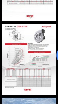

What is the largest turbo in your picture? What is it from?
Heaten m90
Jun 3, 2017
335
8
The MTU is a Garrett GTX5533R 98mm
The cummins is a HX82 117MM
Yes the piping will be difficult but the responsiveness might make worth it. The small turbo will hit hard and the big turbo will top end like a motherfucker.
