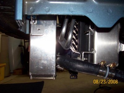

I will not go into R&I of the front fascia as anyone that is considering this mod is more than capable of performing that task. Same holds true for removal of the Saleen heat exchanger.
Once the front fascia and Saleen heat exchanger was removed, the Afco unit was mounted to the backside of the front bumper on (4) longer bolts, with vibration isolators, spacers and locknuts. Be warned even though this unit is only .5" thicker than the Saleen heat exchanger, it is a very tight fit due to the inlet fitting sticking out of the rear of the heat exchanger. That fitting almost touches the A/C condenser. But with a little tweaking of the Afco heat exchanger mounting brackets, it will fit without touching the A/C condenser. The next issue is the P/S cooler. The brackets must be tweaked so the P/S cooler tubes are vertical and much closer to the A/C condenser than before. However, this can be accomplished without the P/S cooler touching either the heat exchanger or the A/C condenser. Next is the coolant inlet fitting. It is on the correct end of the heat exchanger but the nipple points in the exact wrong direction. Not a big deal. (2) short 3/4" 90* hose elbows, a 3/4" barbed nipple and some clamps solve that problem and get the inlet hose pointed directly at the intercooler pump. Next is the heat exchanger coolant outlet fitting. It is on the wrong end of the heat exchanger. No problem. (2) more 3/4" 90* short hose elbows, a couple of 3/4" barbed nipples, some clamps, and a piece of 3/4" hose can be used to route the outlet hose to the opposite end of the heat exchanger and it easily connects to the original Saleen heat exchanger outlet hose. The following pictures are in no specific order.

I recommend if you going to do this job to get a helper to prevent damaging the heat exchanger or A/C condenser. I did this job entirely by myself which made the job take a little longer. Total time spent 5 hours.

more pics.....

I'm sorry I don't know how much my AITs have been reduced. Haven't had a chance to check.
One last thing I should mention. It looks like there is still enough room to mount (2) small fans on the front side of the heat exchanger if I decide to do that in the future.

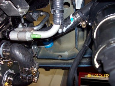

Why didnt you just run the passenger side hose directly to the Saleen IC pump and the rear outlet straight to the drivers side? Doesnt make sense to me. I have the AFCO and Im about to install it, so Im curious. Am I missing something here haha

You bring up a valid question...
With the Saleen I/C pump mounted in the original location, the bottom port on the passenger's side of Afco H/E is about 6" lower than the I/C pump outlet and the hose, being that short, would have been a bear to route - most likely would end up kinking and restricting coolant flow. You can see this in picture #5 in post #4. Most likely will take some premolded hoses but probably not impossible to accomplish. The I/C pump can't be lowered as it will hang down below the front fascia.
Keep in mind I also have the GT 500 front fascia which has the RH brake cooling hose connection that is also in the way. Since I have no intentions of using either of those, I guess I could remove it with a cut off wheel.

I have my hoses routed like you want to do and the hose from the pump to the H/E would kink. Doogie on the site gave me a part number from Napa with pre-bent hoses which he used and it worked out good. The part number is 11605.
He also found another company with pre-made hoses. Maybe you could pm him to find out where he got them.

Mine is done this way. Very simple to do. For the passenger side, I used two "long" radius 90* bend hoses (generic) and a straight barb fitting. Perfect fit. Generic 90* hoses are cheap. I also used the same "design" for the driver side to have the connection point at the exact same location as the Saleen HE. Ran straight across the top part of the AFCO and then turned down. Keeps the main area of the HE open for a fan installation.

After giving careful consideration to FR500GTs post, I took some measurements and went to the local auto parts store and came up with this
Looks like it should work fine and doesn't look like any coupler will be required. I'll find out this Thursday. If this does allow the Saleen I/C pump to be connected directly to the passenger's side of the HE, that would be great. The HE core would have the inlet at the bottom and the outlet at the top which would help to purge any air that is trapped in the HE core.
Hose has a 3/4" ID, cost is $11.99 and is available at Advance Auto Parts
