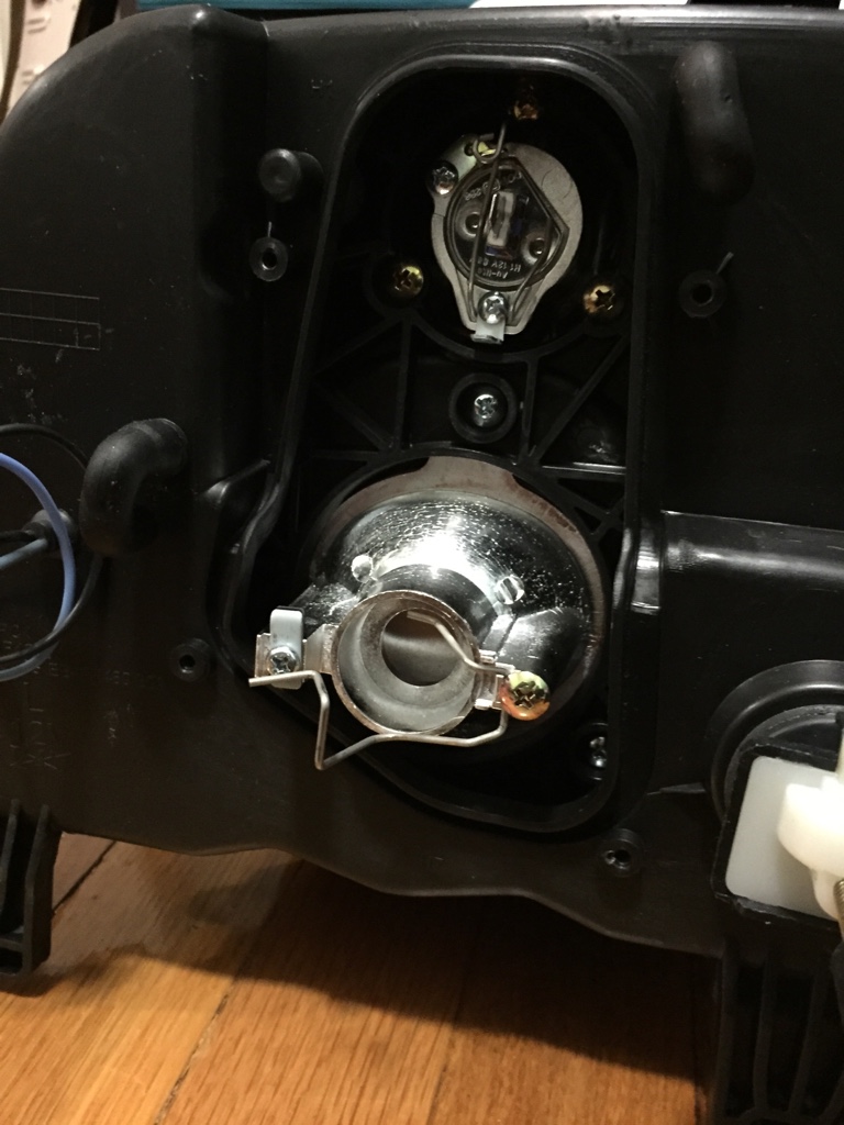

You will need to modify the Raxiom back cover and do some wiring to make look neat:
This is how the back looks with the cover off. Top is an H1 high beam bulb and bottom is the low beam H7:
Enlarge the hole using a Dremel so you can pass through the HID bulb wires:
Also in the pic above you'll see the orange and Black wires. Those will connect to the H1 bulb. The other side is a 9006 style female connection. As seen below:
