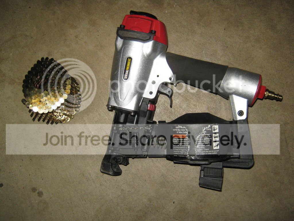

All done with the nailing. Used all of the 7200 coil nails that came in the box except for 2 and half coils. Ended up using 24+ squares of shingles.
The nailer is now running great. All totaled there were 6 jams during the whole project. All of them happened during the first half. Once it was broken in there weren't many issues. How long the nailer would last I will probably never know because I don't plan on doing this again.
It really feels good to have it all done. A pic of the nailer for anyone who might be interested. I saw a similar looking nail gun at HD but it was over twice the price and labeled "Milwaukee". I have no way of knowing if they are indeed the same but even the loading gate catch was the same. I am glad it worked as well as it did. $99 + I had a 20% off coupon so with tax it was still under $90. HF has a 90 day return policy. If it turned out to be junk I was prepared to return it and pick up a Hitachi (Lowes had the Hitachi in stock and I came close to picking it up right from the start). It was a gamble, I've had good and bad from HF in the past.
