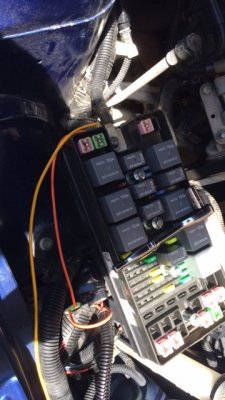

Step 2-Open Fused box and use the 10mm socket to unscrew the bolt closest to the windshield.
Step 3-Take the 10 gauge wire and connect it to the 3/8's ring connector, then put this connector on the 10mm bolt and screw it back in.

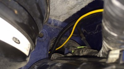

Step 4- Run the 10 gauge wire from the fuse box, to the back of the engine bay where the engine wiring harness is held, ziptie the 10 gauge wire to the engine wiring harness and run it over to the ac.
Step 5-Next to/belw the brake fluid reservoir there is a 3x4 hole where an existing wiring harness leads down to the firewall, feed your wire down this hole and push plenty of excess down. This makes Step 6 much easier.

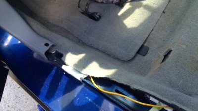

Step 7-make a small x hole in the grommet and pull your 10 gauge wire through, pull the carpet next to the trunk release out. Next remove the foot piece that says "MUSTANG" on it, simply pull up on it. Release the carpet tabs underneath.
Step 8-Remove your old seat, or make sure the new electric seat is unbolted to give you working room below.
Step 9-Feed the wire under the carpet along the existing harness and through the hole with the stock 2 seat harness'
