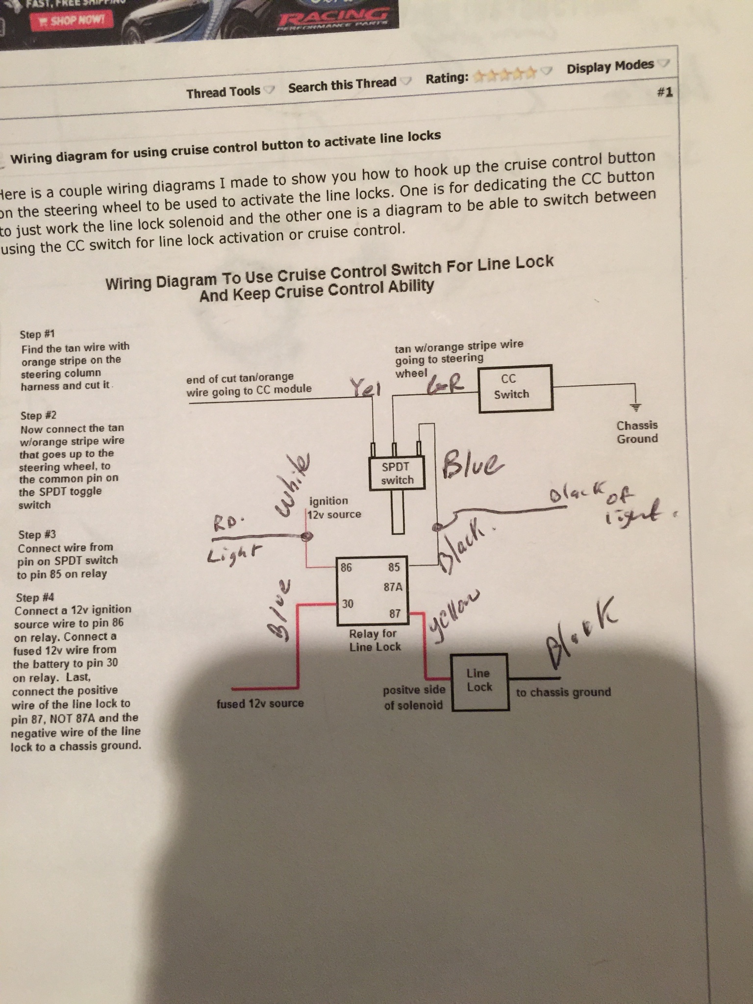

Wiring diagram for using cruise control button to activate line locks

As long as you can find the appropriate color wire coming from the button you want to use, then it should work fine. Wouldn't be any different than the cruise button

bringing post back from the dead.... anyone have pics of the original first post that was shown when kimmer posted the both ways

this is for the CC
9k=
here 1 for the horns , looks like it will work .
I used the diagram above to wire the CC off switch to fire my nitrous solenoids, but I can't get it to work. The accessory switch is able to click the relay on & off but when I press the CC off button, nothing happens. Any ideas?

that diagrham is only for dedicated accessory right ? or can you also use the off for the CC ?

It looks like it's just using a dual position setup. It either activates the relay, or it doesnt

Does the wire going into pin 86 need to be fused as well?
Is this SPDT switch supposed to be a momentary switch?
edit: never mind, I found 3 position switches that will do the job. There are SPDT momentary switches too but that won't make sense in this case.
Fuse 30, that's the high power feed

Great write up. Im going to use it for momentary nitrous engage. But as a side note the previous posted pictures are no longer here

Using the SPDT switch and relay did not work for me and I gave up. I was using a normally open relay and I'm not sure if that mattered.
